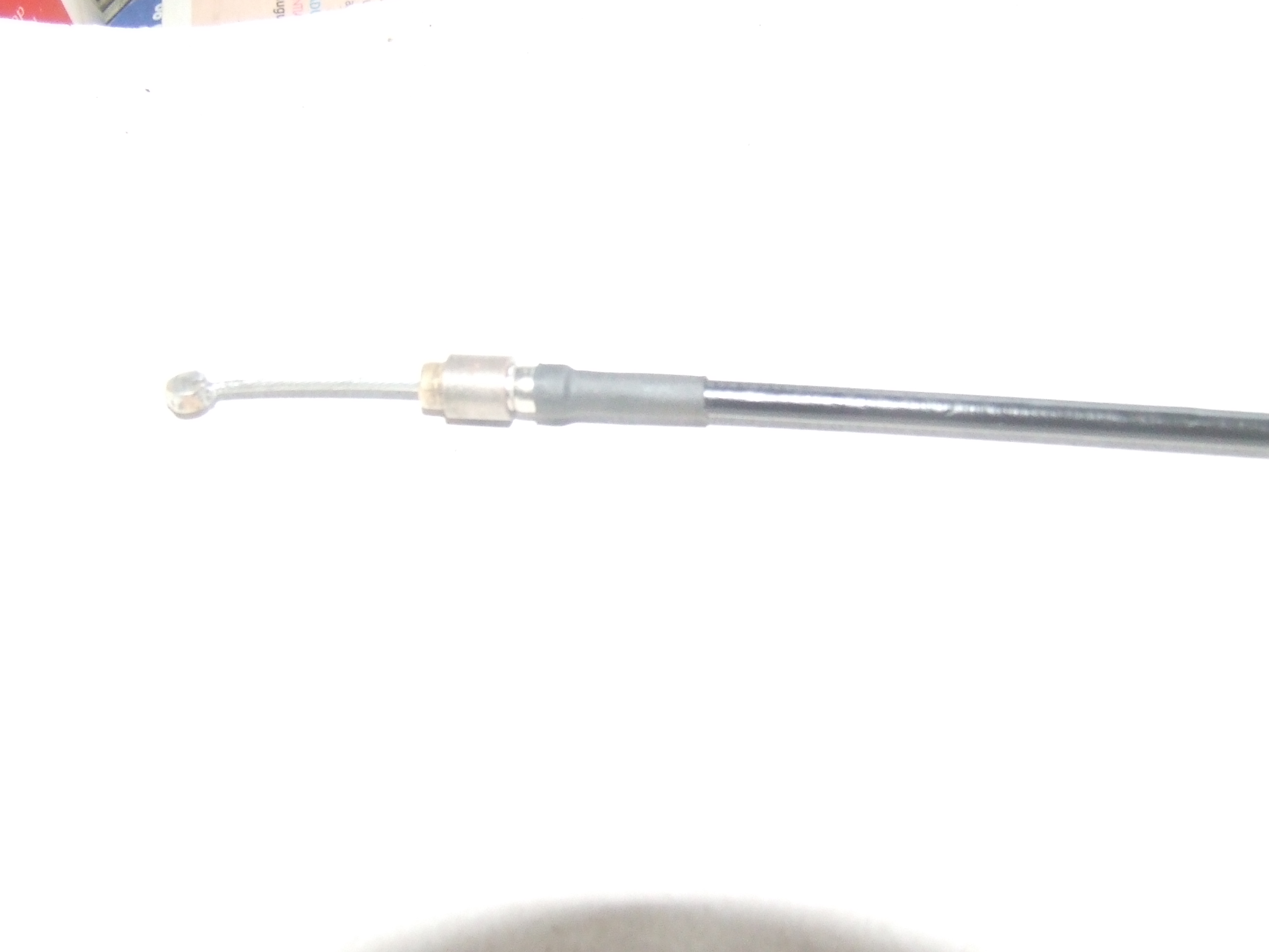

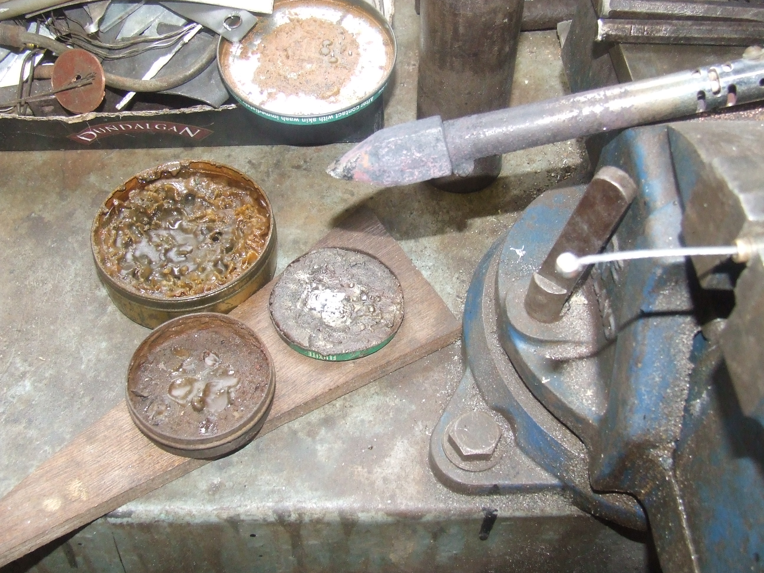

Bit of flux on the nipple and you can transfer the solder on the iron to the nipple.
The important measurement is how much longer the inner is than the outer. Make sure you measure that before sweating the old nipples off.

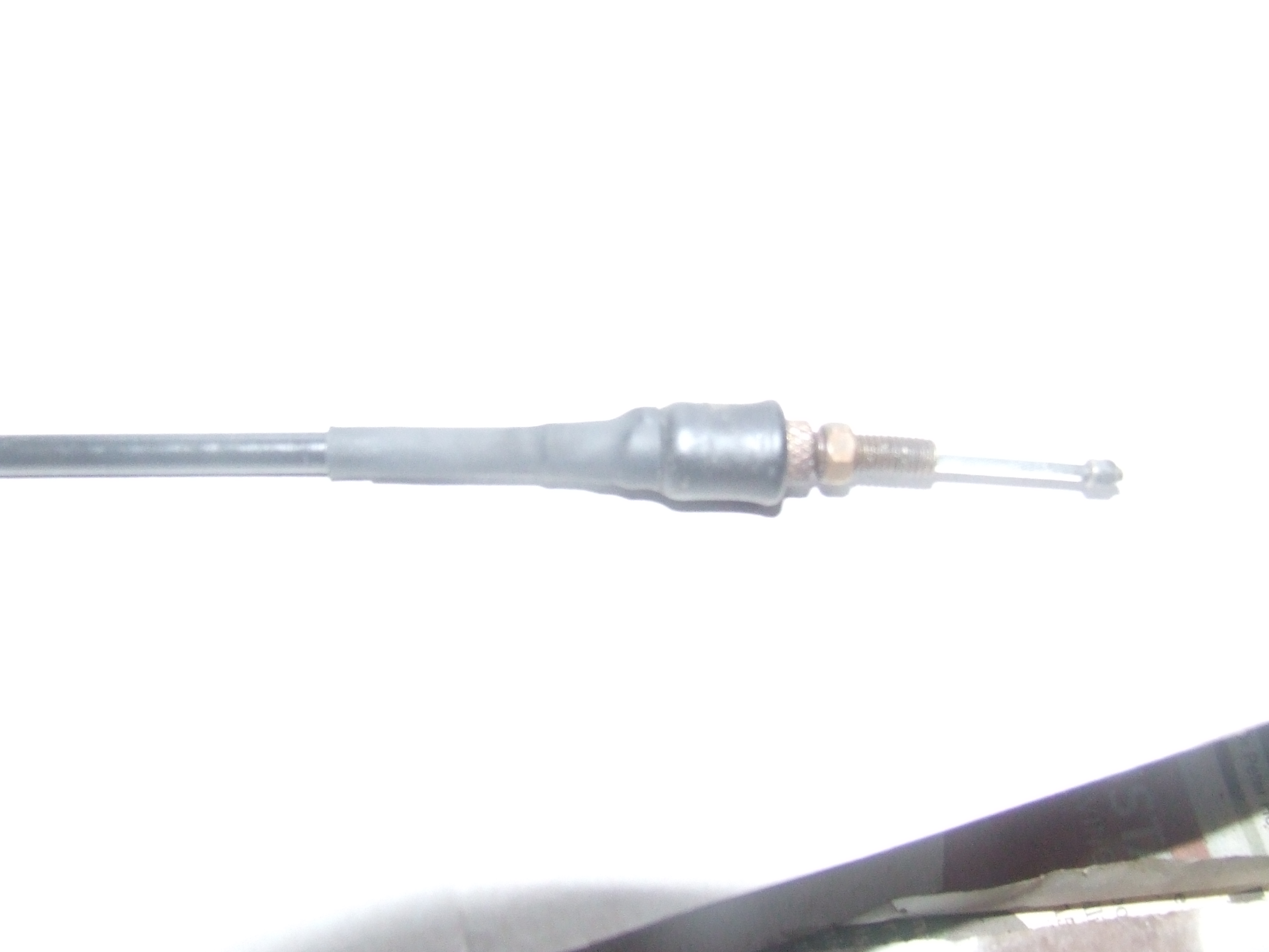

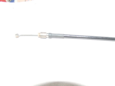

I used shrink tubing to reinforce the ends of the cable.
Ready for testing.

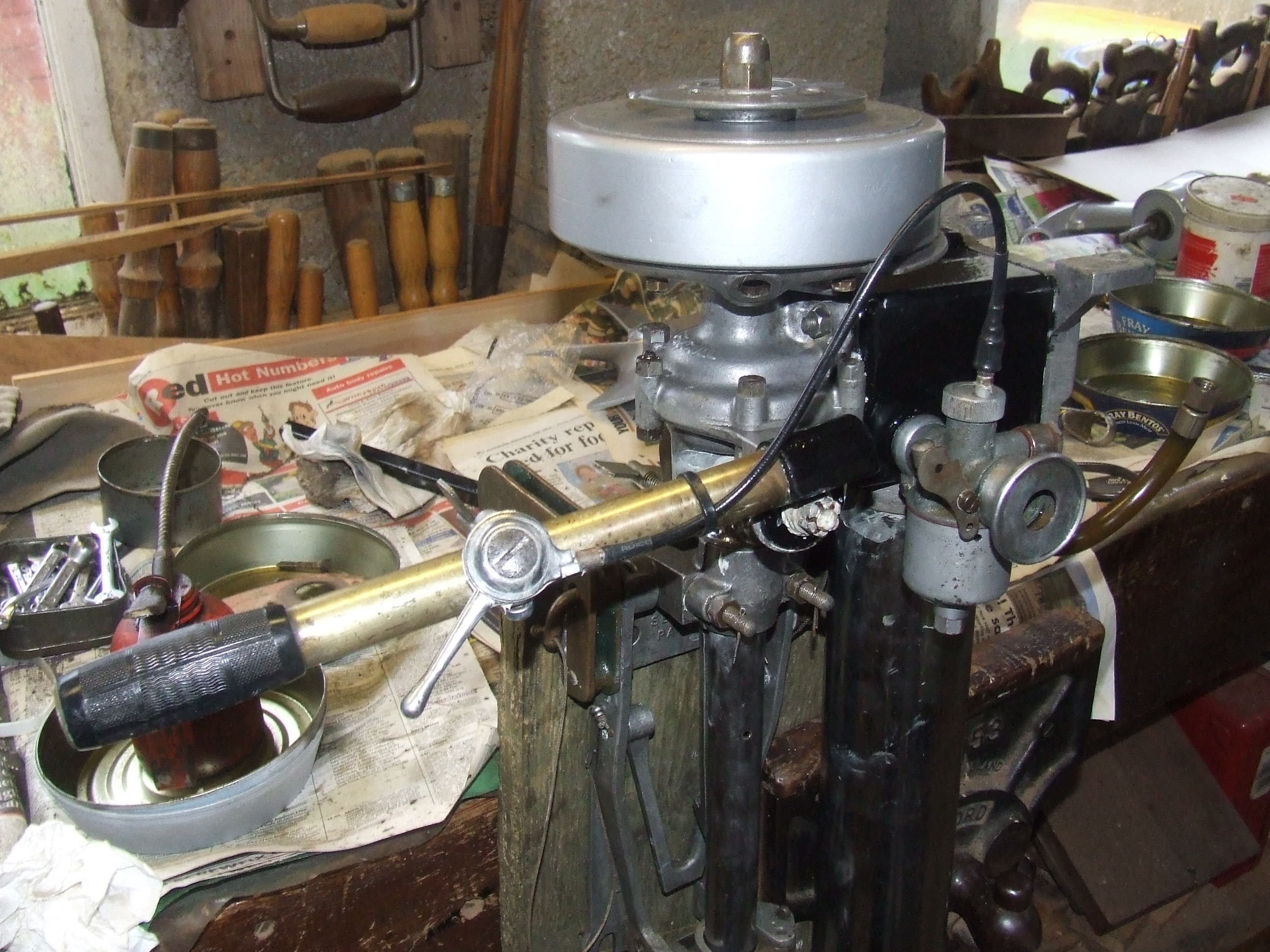

Back up and running ready for the new season.
