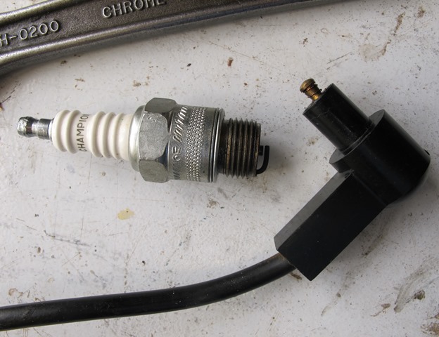

I fitted a known very good HT lead, there was a tiny suggestion of firing, just the one, then nothing.
Next I removed the as new Champion D16 spark plug from the same engine, I tested that for a spark with the HT cable that they came off the same engine with.
On pulling the starting cord there was a bright spark, then nothing, I next tried a used but clean NGK A6 plug, same again, no spark.
Does this take me back to the points for re inspection, I think so?
That will be tomororw as I have done enough today. :lol:

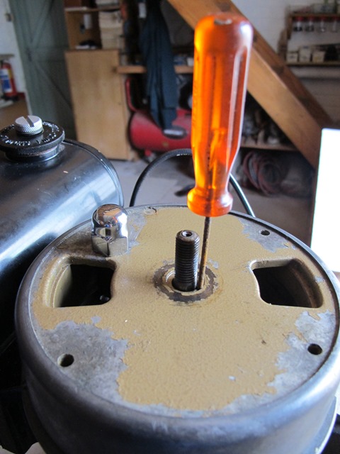

Who has a good and safe way to remove the flywheel, as even with all the British Seagulls that I have restored I have yet to remove a flywheel or open a motor.
So that's a 1/2" carb, what's the original?
african imp
Posts: 395
Location: Hout Bay
Post by african imp »
Checking to see if the drive shaft is in place I slid a ponier into the slot in the flywheel.
It goes down 22mm which is 7/8" before it stops, is this correct?
