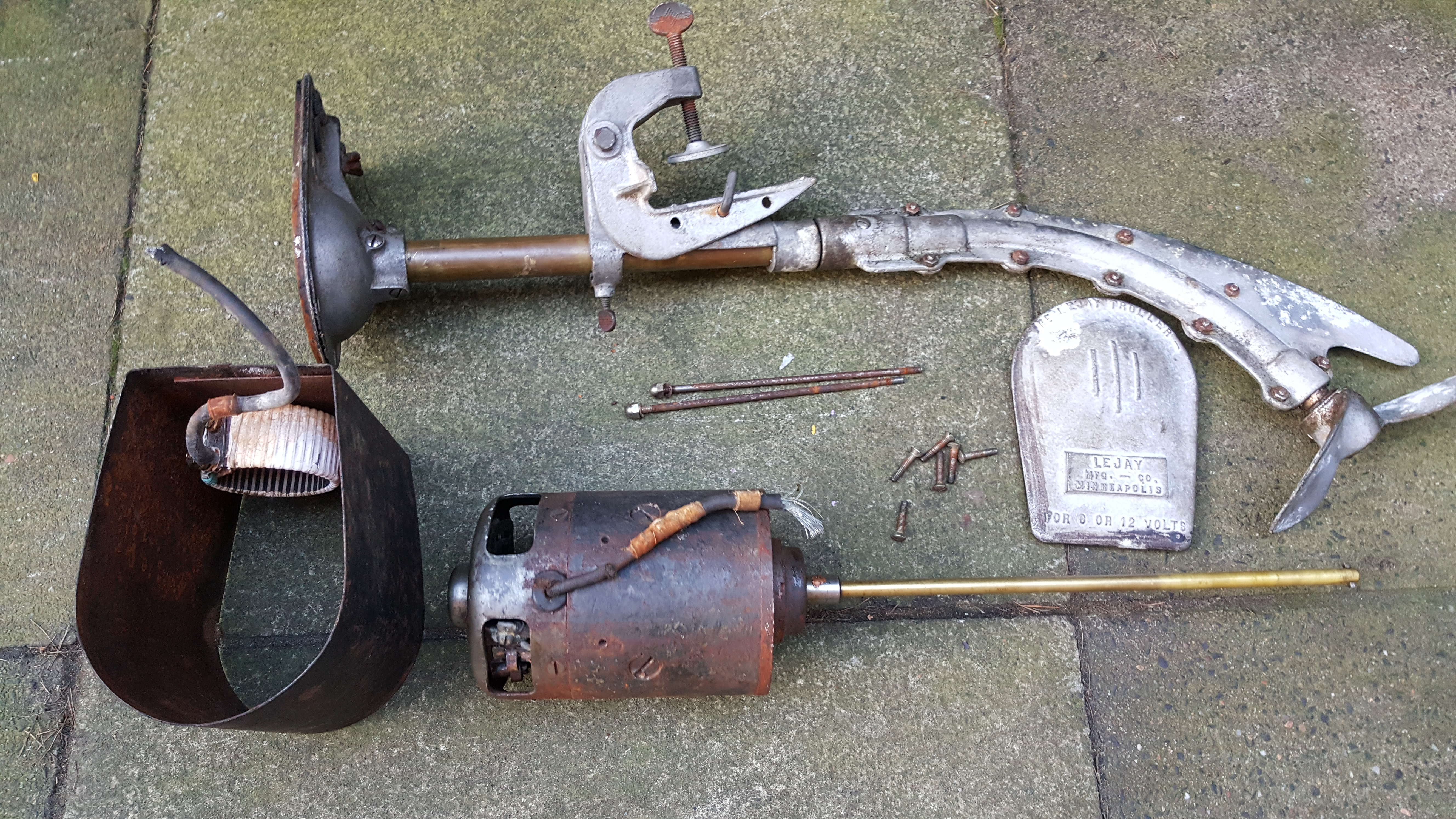

If you can get us some photos with the covers off, we may be able to guide you for a direct battery connection, cables bypassed.tambikeboy wrote:No attemps as yet looks to be complete but will require new cable's .AusAnzani wrote:I love the look of that electric. Any attempts to run it yet?

AusAnzani wrote:If you can get us some photos with the covers off, we may be able to guide you for a direct battery connection, cables bypassed.tambikeboy wrote:No attemps as yet looks to be complete but will require new cable's .AusAnzani wrote:I love the look of that electric. Any attempts to run it yet?

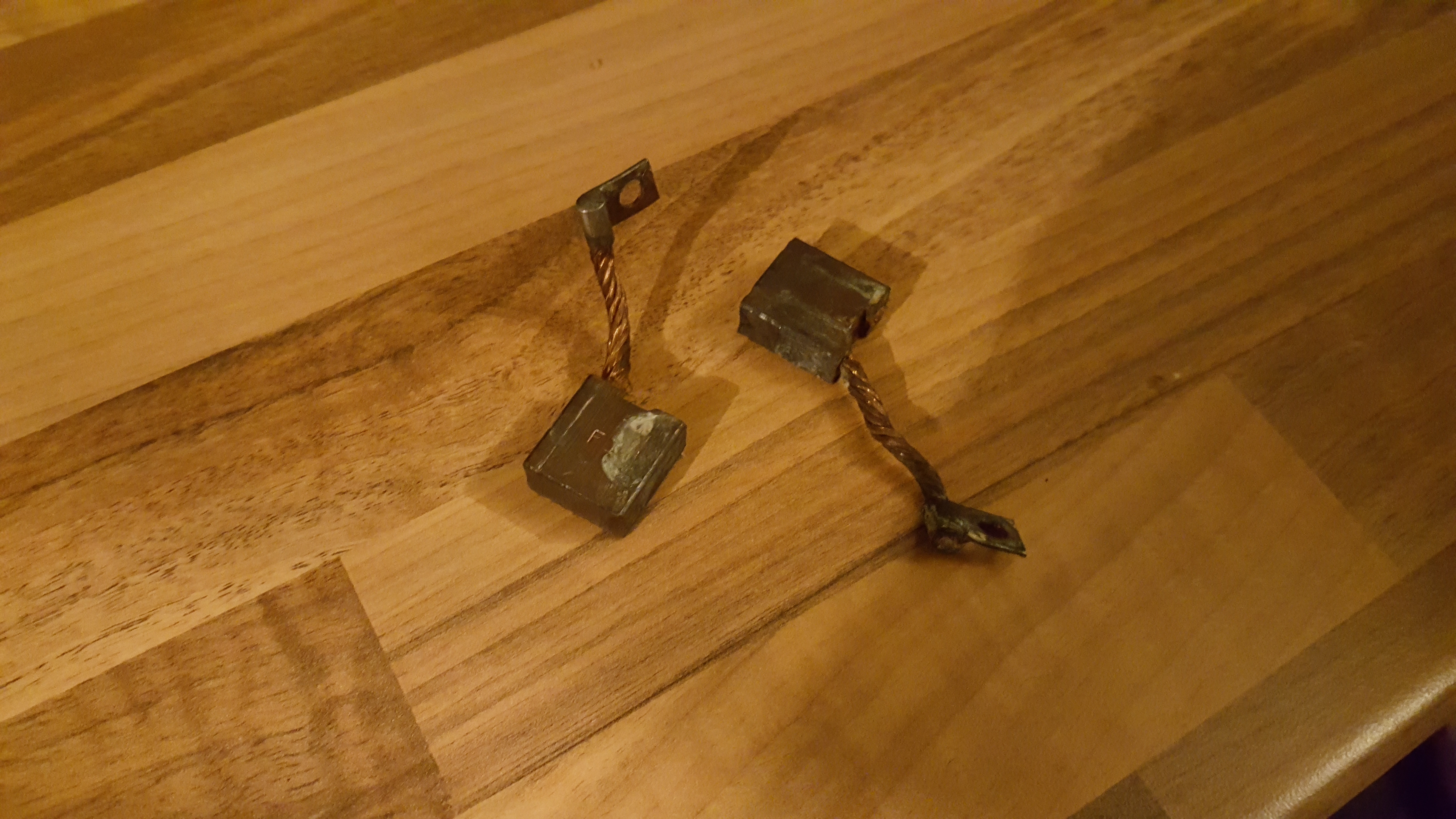

Brushes all good as with bearings.
Re: Non seagull outboard I. D

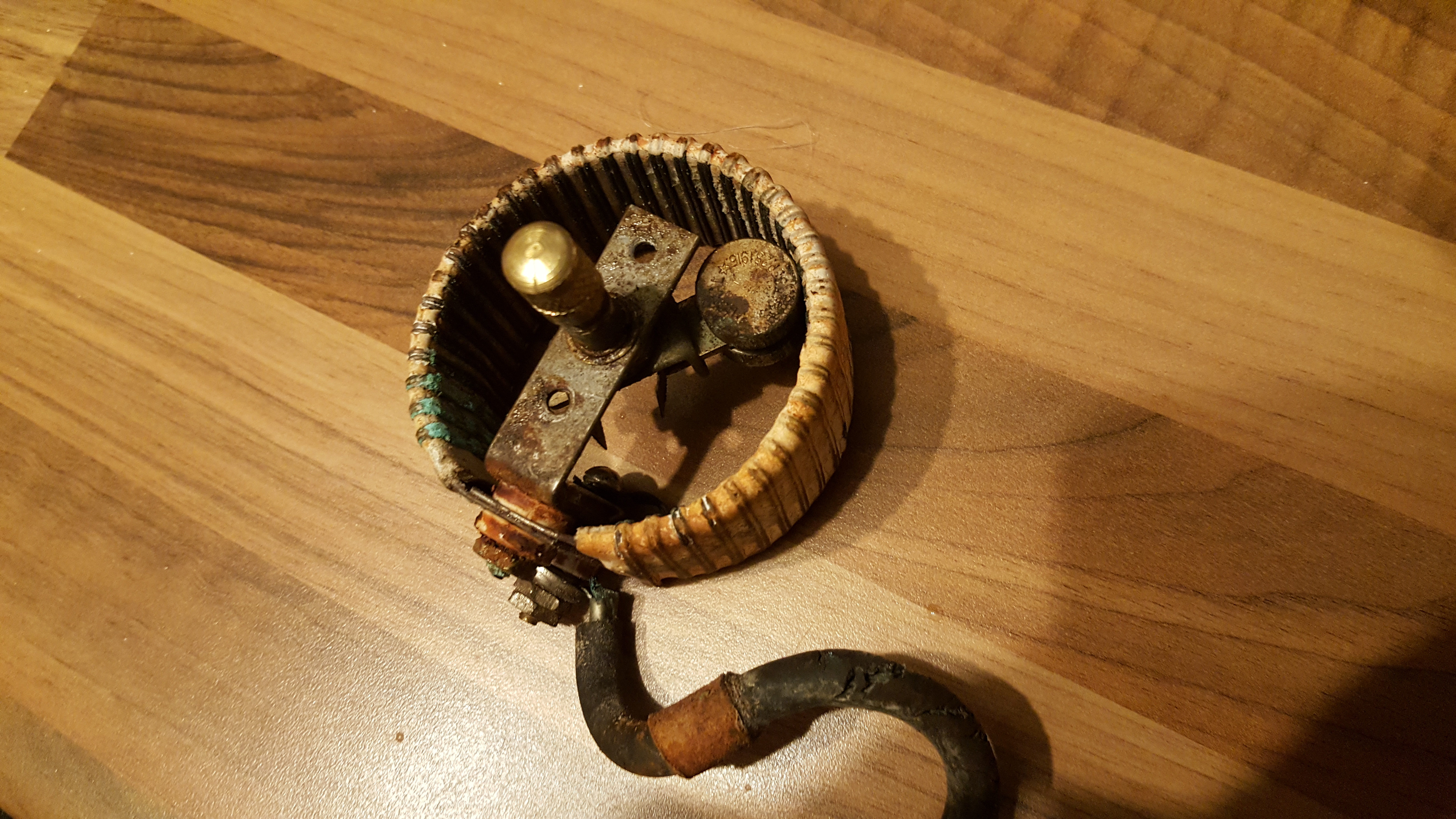

I'm not quite getting how this electric motor works ie from the photos provided.
Re-assemble the motor and with a multi-meter see if you can measure continuity (ohms) between the two cables. If you do, might be worth connecting them to a 12V source (battery or power supply) to see if it will turn.
Mate, if you weren't so far away, i'd pop over and have a closer look for you!

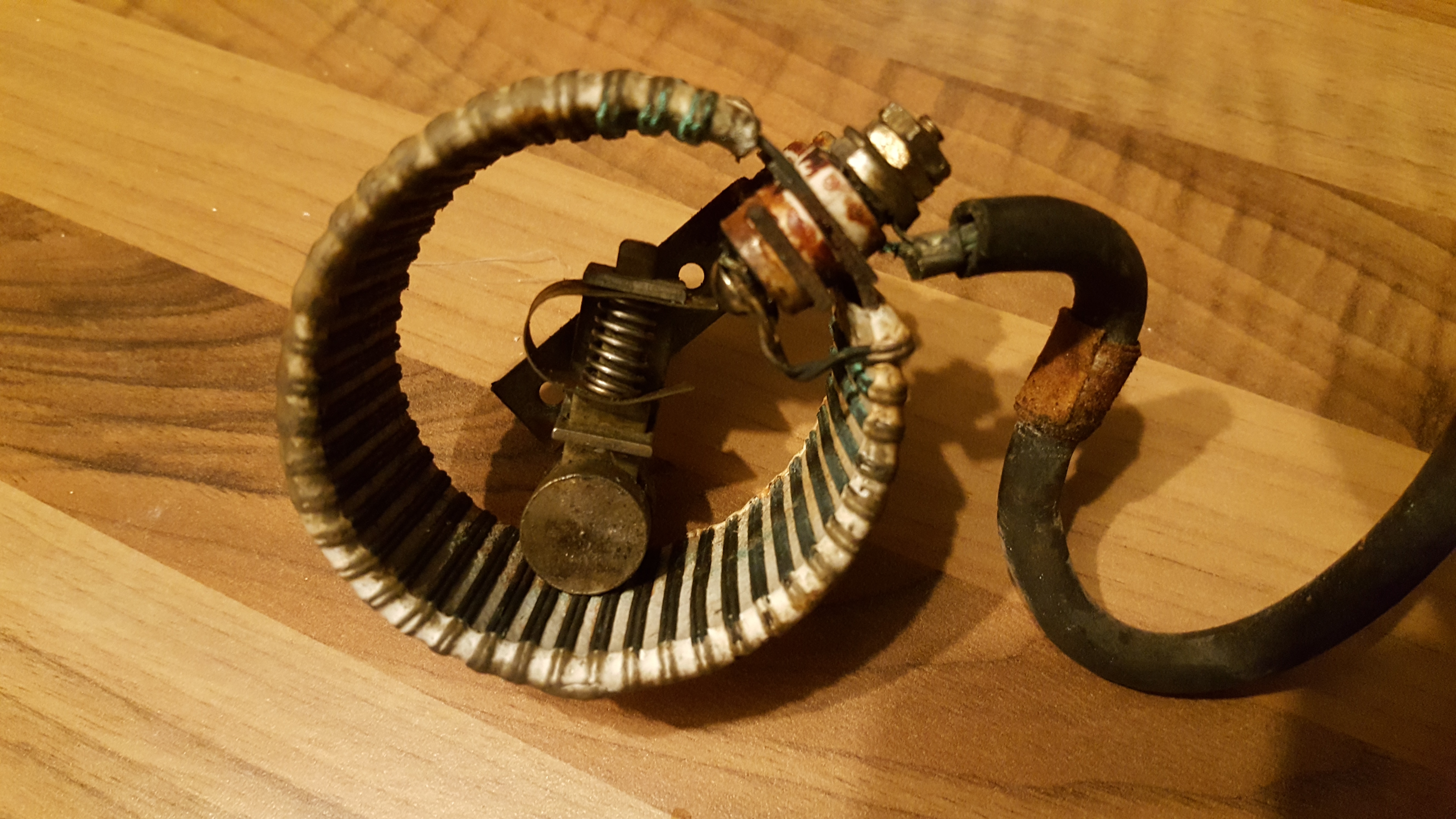

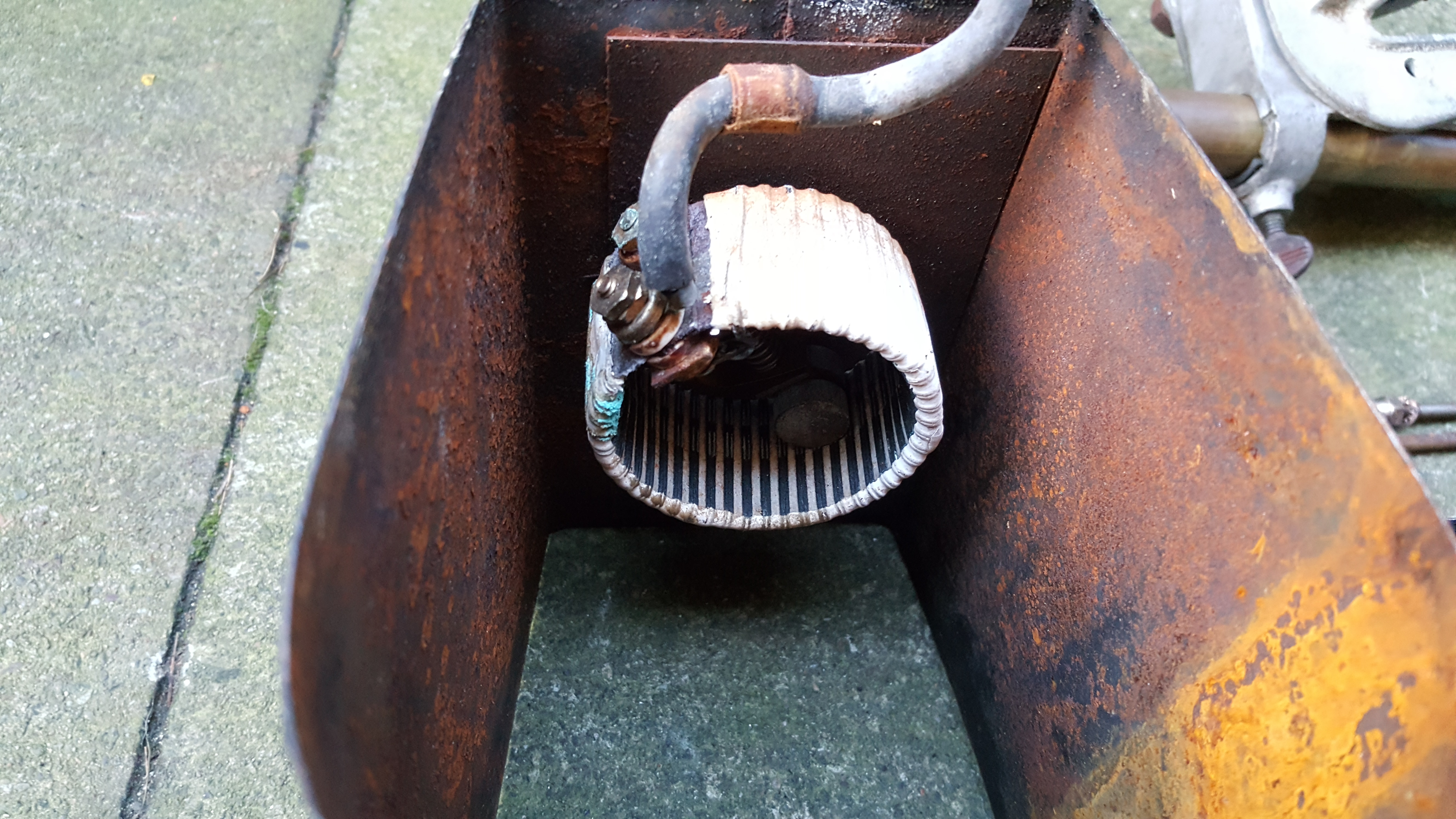

The white circular coils are the speed controller + and - cables come in from the bottom.  Knob on the other side of cowl.  Speed controller grounded to metal frame. Std DC motor similar to car starter motor with variable voltage + wire from controller. You would get a few zapps from that in saltwater
 . I would be wearing gloves and not using it on an aluminum boat. Replace the cables, emery cloth or turn (dress) the armature segments and using a hacksaw blade ground to a point, delicately clean between segments. Replace bearings/bushes.   I think it would be ok to attach frayed cable to + of battery and - wire from battery to frame of motor. Make sure frayed cable is not shorting to anything metal. Keep onlookers respectful distance away....  It should spin with hopefully not too many sparks.

I'm thinking out loud if i connect either/or cables to battery the worst that can happen is it will go in reverse or am I way wrong.
I noticed it says in the sales brochure that it has full reverse does that mybe mean you just swap cables around who knows must yet the wellies on
I would be running car jumper leads to the motor. Red to frayed cable and black outside metal of motor. Dont worry about cables and controller in cowl.  Is the motor free to spin? Tape up cable with more electrical tape. Attach to battery last. Yes reverse polarity to go backwards. Biggest fear is a short circuit and KA-BANG. If it just hums in e minor disconnect quick smart as that will burn out wiring.

Looking at this again, i would agree with Hugz. The white circular thing that the cable is attached to is the speed controller.
I would run the motor on its own however to confirm its OK. So, if its free to spin, secure it to something, hook up a supply (positive to wire, negative to motor frame) and if its OK, it will run at full speed. If your supply is not switchable (as in on/off), and you're using a battery with jumber leads, you should expect a spark when you connect the motor.
If the motor proves OK, we can move on to testing with the speed controller.
It's only 12VDC, so there's no chance of hurting yourself other than maybe a little burn worst case. It's the AC stuff you need to worry about!
let us know how you get on.

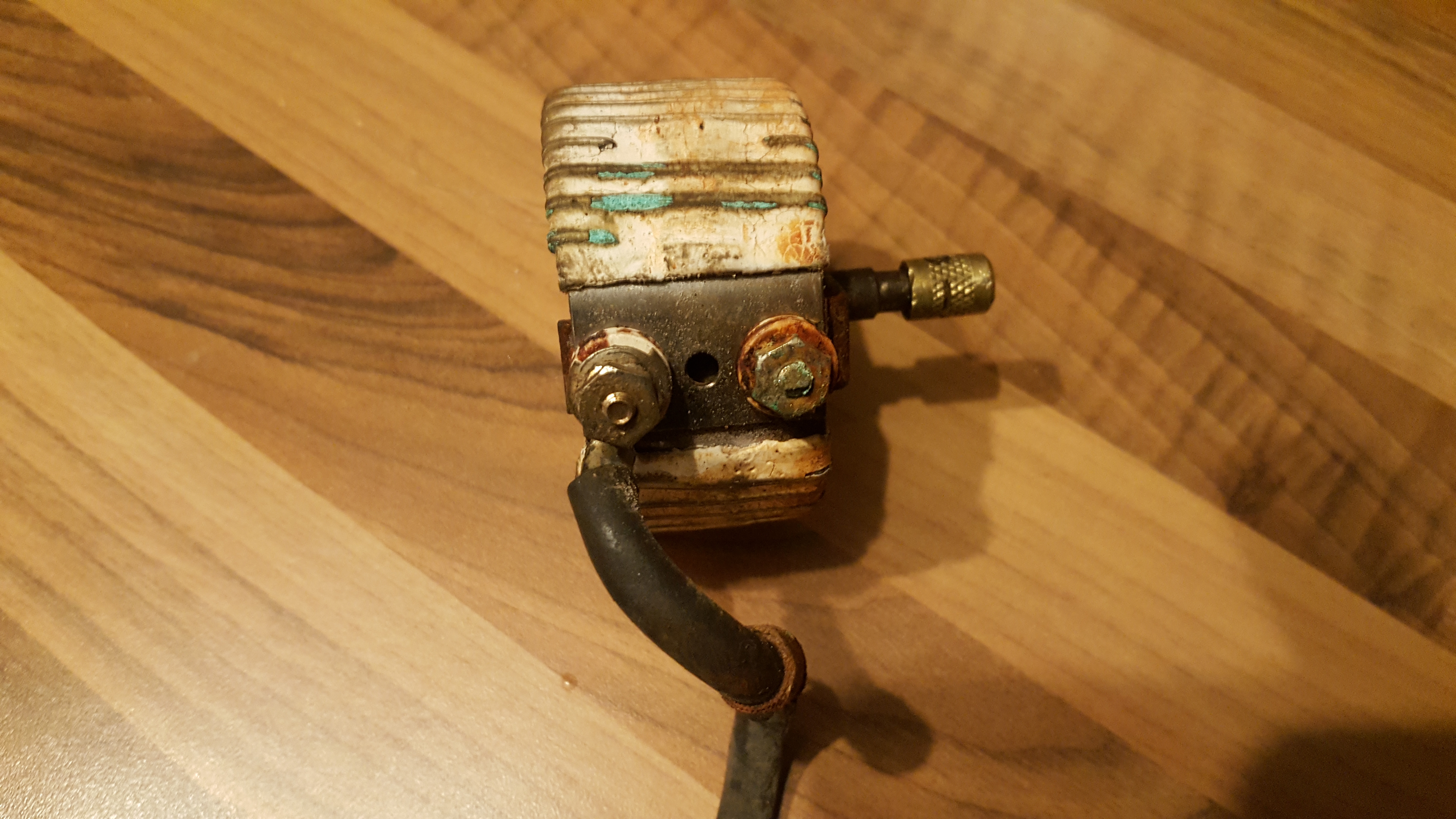

The dalek is running thanks china's now for complete strip down starting with this speed controler looks to be in need of a good clean here's hoping that white powdered stuff is not what it looks like (asbestos) any thoughts before cleaning.
