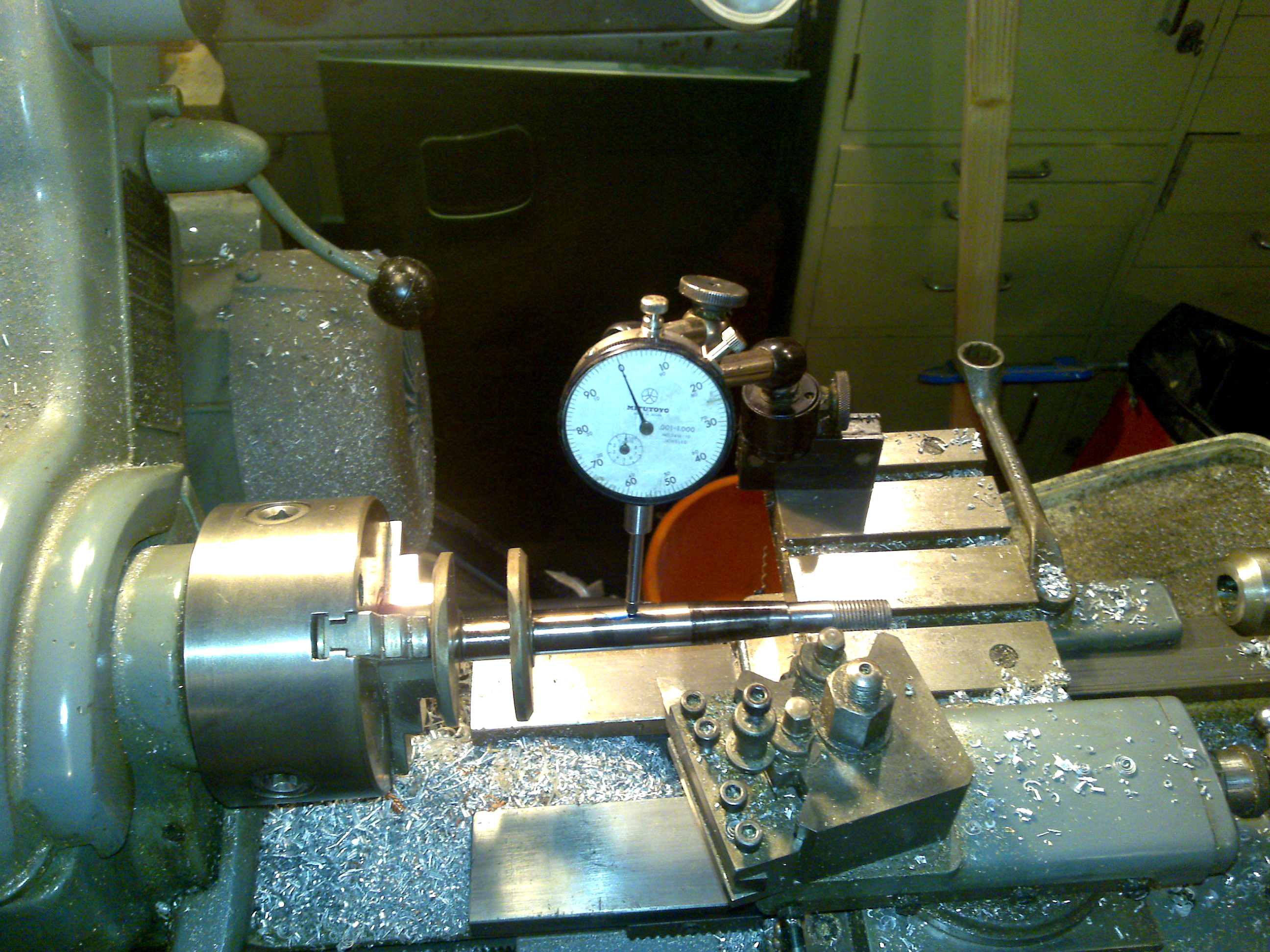

I do it like this, you can get it straight to within about a thou.
If crankcase is distorted, that is more difficult, a long 5/8" reamer can sometimes sort it depends how bad it is.
I have found a bent crank to be more common.

You'll have to forgive my ignorance, but how do you get it straight in the lathe?

Make sure your chuck is true, luckily my 3 jaw is near spot on, if not pop it in a 4 jaw and centre it with dti.Ricko wrote:You'll have to forgive my ignorance, but how do you get it straight in the lathe?
I've got a Boxford but it's a bit buried at the back of the workshop!
I've got a DTI too, somewhere safe!!
Then put the DTI on the flywheel end and see how far out it is. A couple of light donks with a wooden mallet will get it straight.
If the crank is badly twisted chuck it in the bin.
I have straightens quite a few of my own, plus a couple for other people, even trued up the needle roller crank in my race engine.
Worth having a go before it end up in the scrap bin.

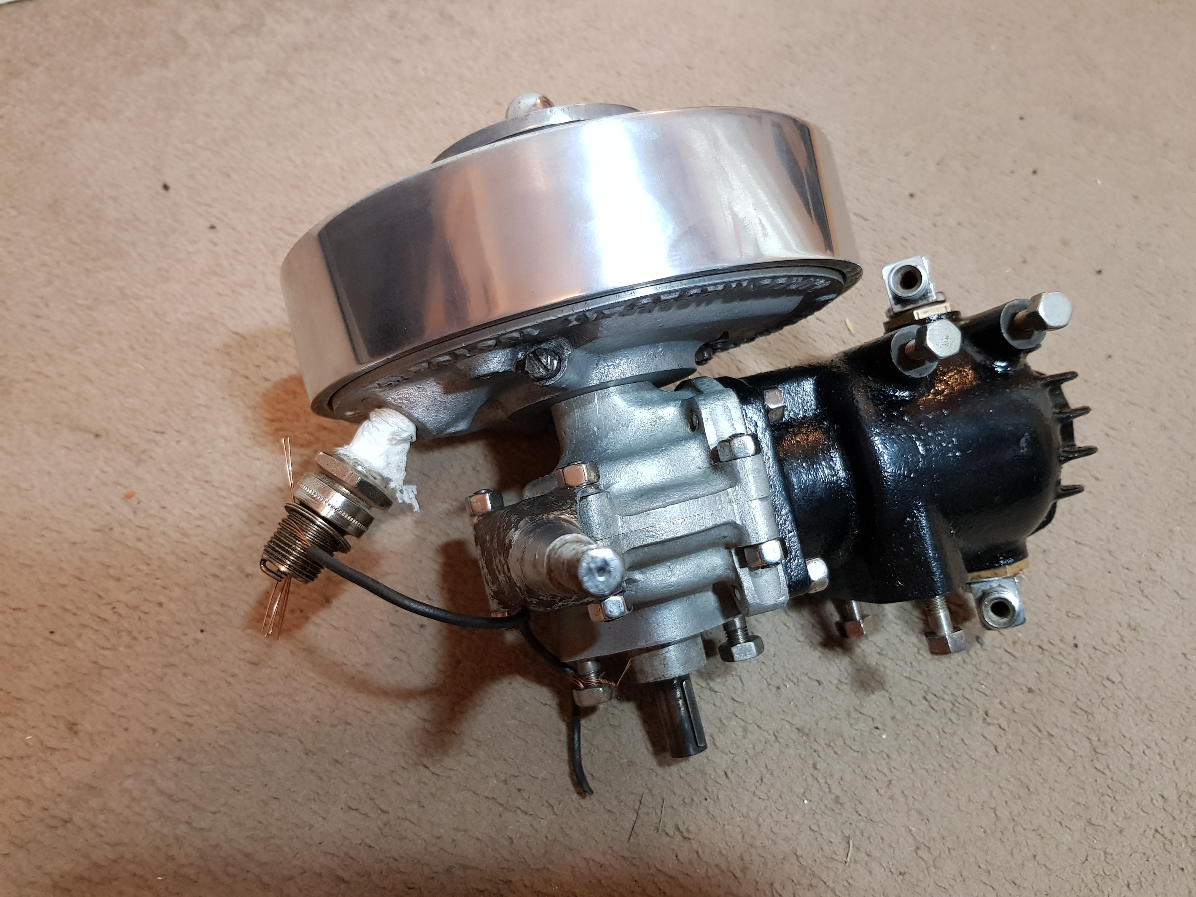

Post an other picture to show how you are getting on.
Re: New member: Forty Plus
Reassembled block
Repaired HT connector, I used some superglue to bond the Bakelite but there was also a piece missing so I moulded some Milliput to fill it.
I've removed the cover off the points ready to tackle that area. Once I have cleaned it out do I refit the magneto without the cover to set the points at its widest point??
