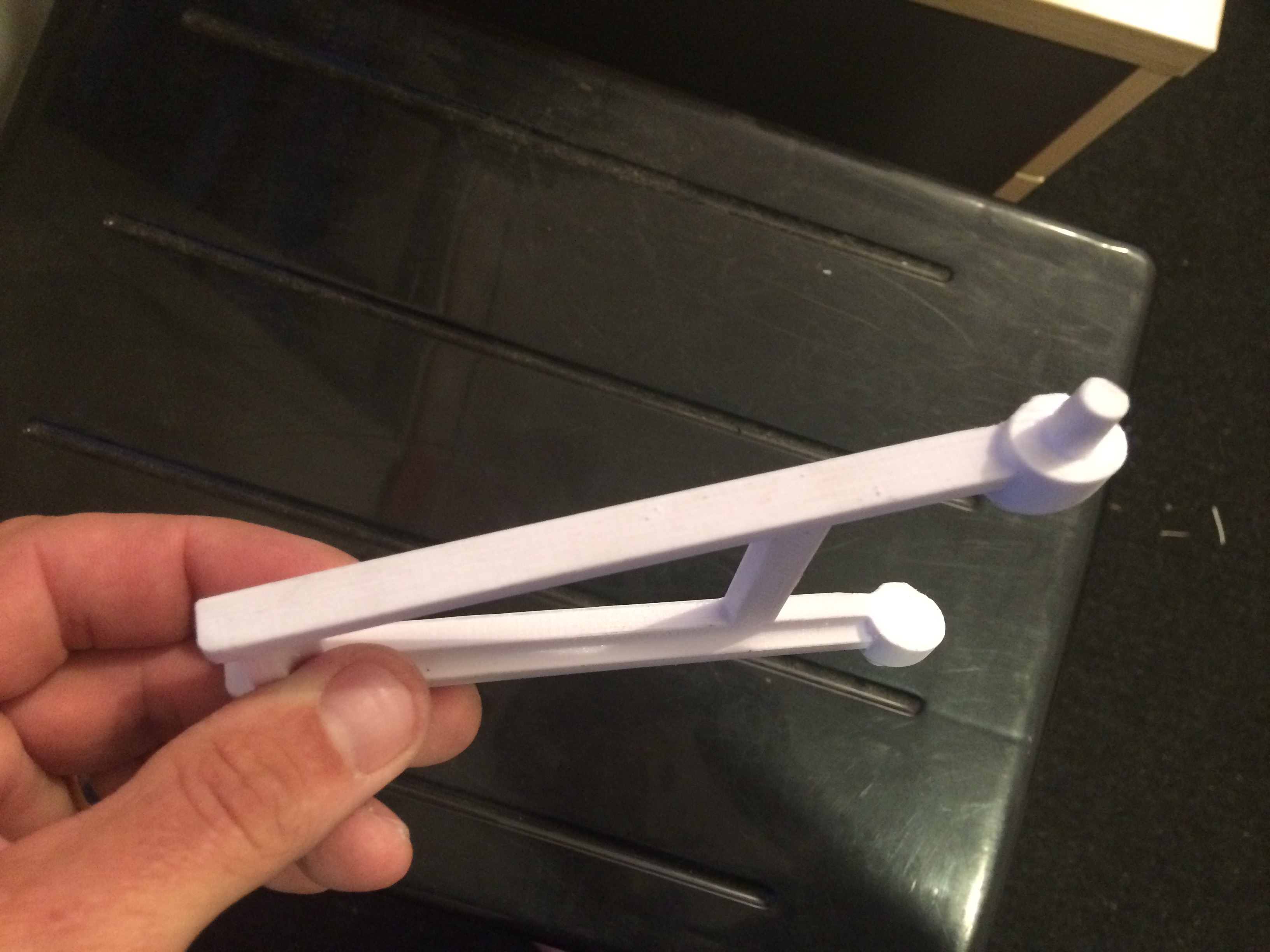

V-strut for Skeletal bracket
3d print it and use the plastic one!

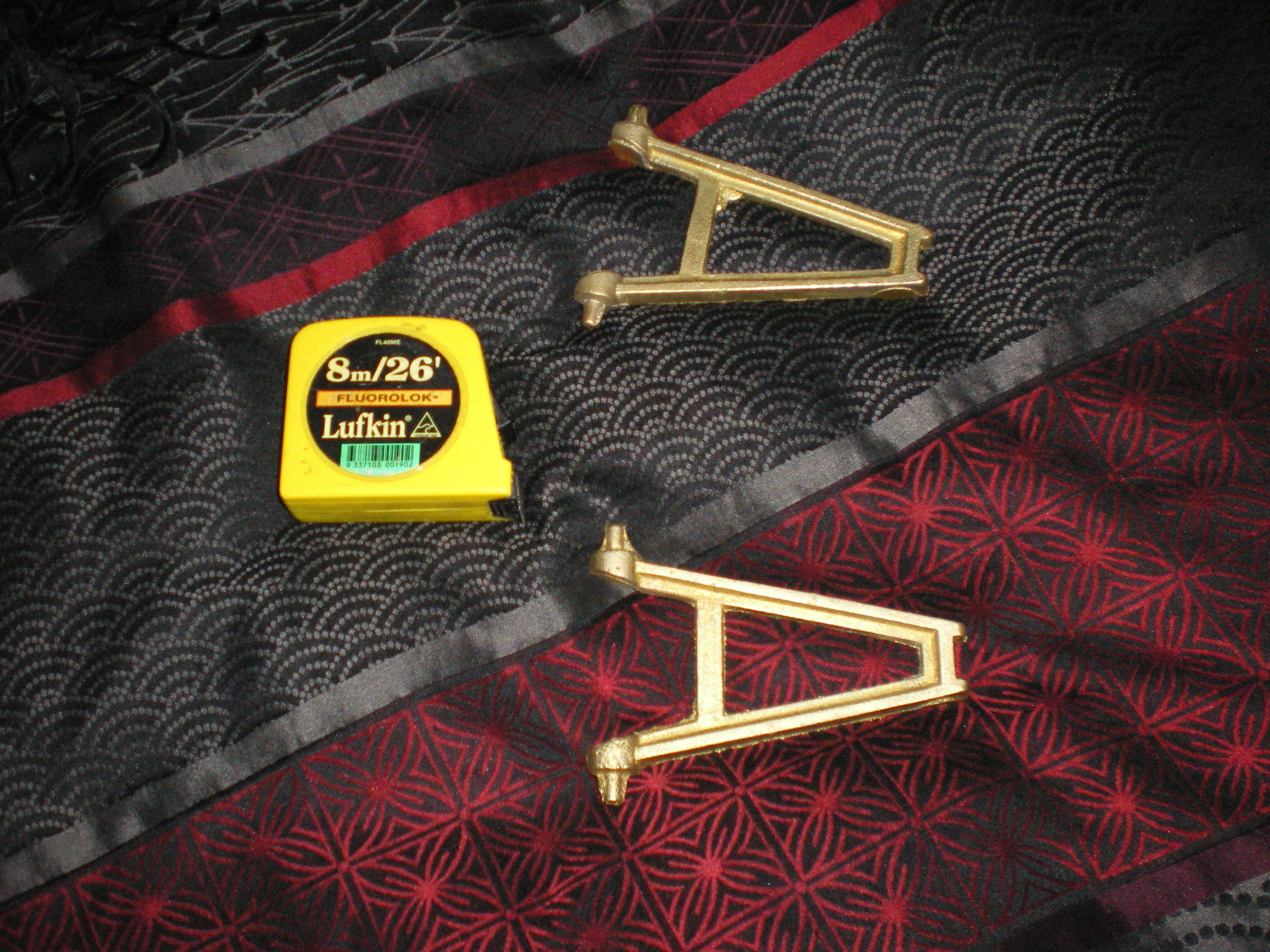

Fantastic. Just received two of the brass V struts. Thanks again....
The forum at its best. Great work

Ditto. A huge thanks again, Nudge..!

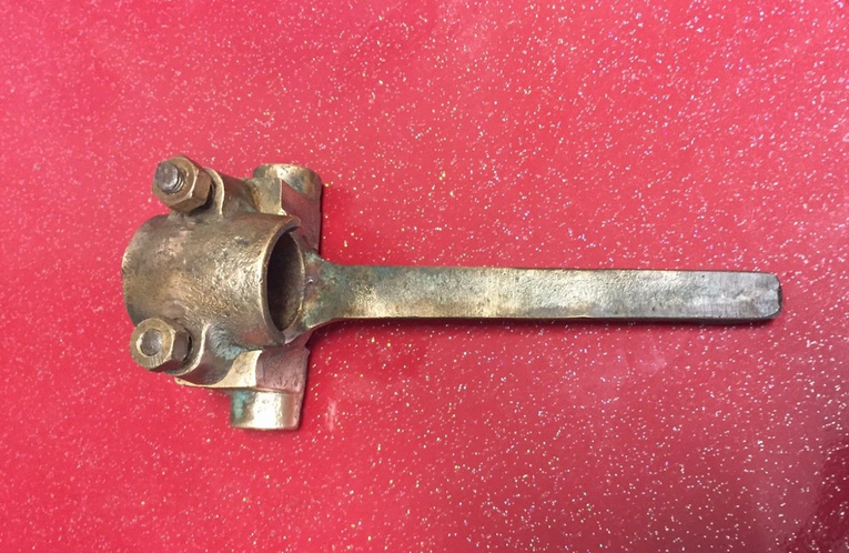

It’s the safety issues that worry me most. I need to confirm my driveshaft clamp/support lug (?) is brass & not bronze first, too.
Anyone else with one in their collection that can confirm?
Check with the internet & let us know what's the difference between brass & bronze, as the first step.
Have you cleaned one you yet Hugo? Do you think it will fit? Hope you have a good sharp file.. better still a "Dremel". if you use a stone fill it up with wax, it will stop it from clogging (same for Alli) you can do the same for sanding disks and cut off wheels!
Got a pic?
Most of the older parts will more than likely be bronze. If it is brown (when cleaned up a bit) then it is bronze. If it cleans up to be more of a yellow then it is brass.
The modern stuff is a little different... the V strut is manganese bronze (yellow) It is copper, zinc and manganese and is as hard as all hell!
The old stuff is more than likely copper, tin and lead. (brown) and soft as poo!
If there is no time restraint on a part then I could more than likely cast it myself. As long as the part is not cast iron ans not over 12Kg including gates and runners I can do it.
I also have a small lathe if the parts need to be finished..... But the more I do the more it will cost. The V struts I got as mates rates so the next lot will cost more... how much more, I don't know.

Here's a pic, Nudge...
I did do a little interwebs reading a while back when I got it, and initially figured the piece to be more likely brass rather than bronze as I thought I saw more yellow/gold in it than brown/reddish when I cleaned it up... but i'm really not sure. Just hoping someone with expertise might also have one and know for sure.
