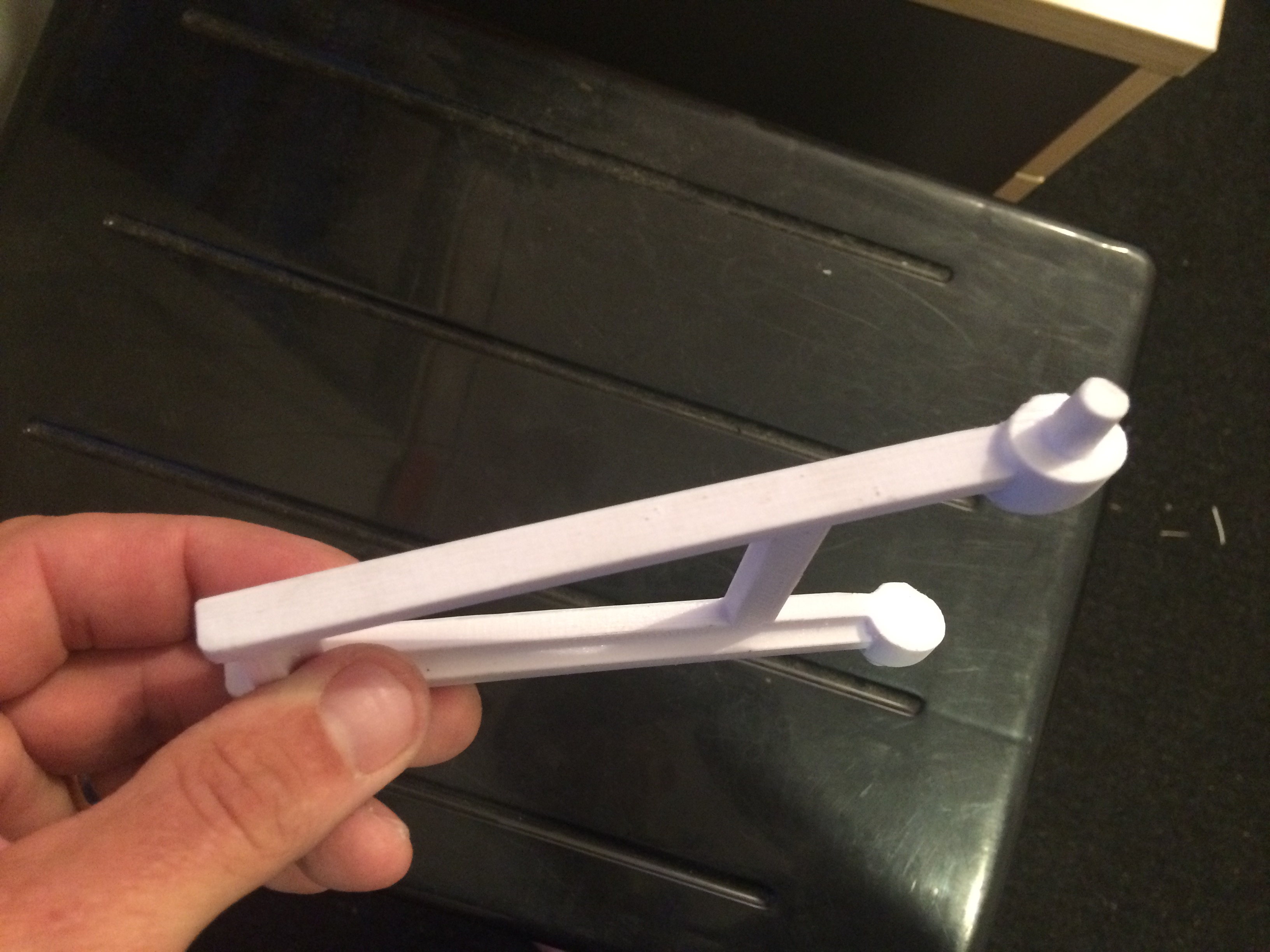

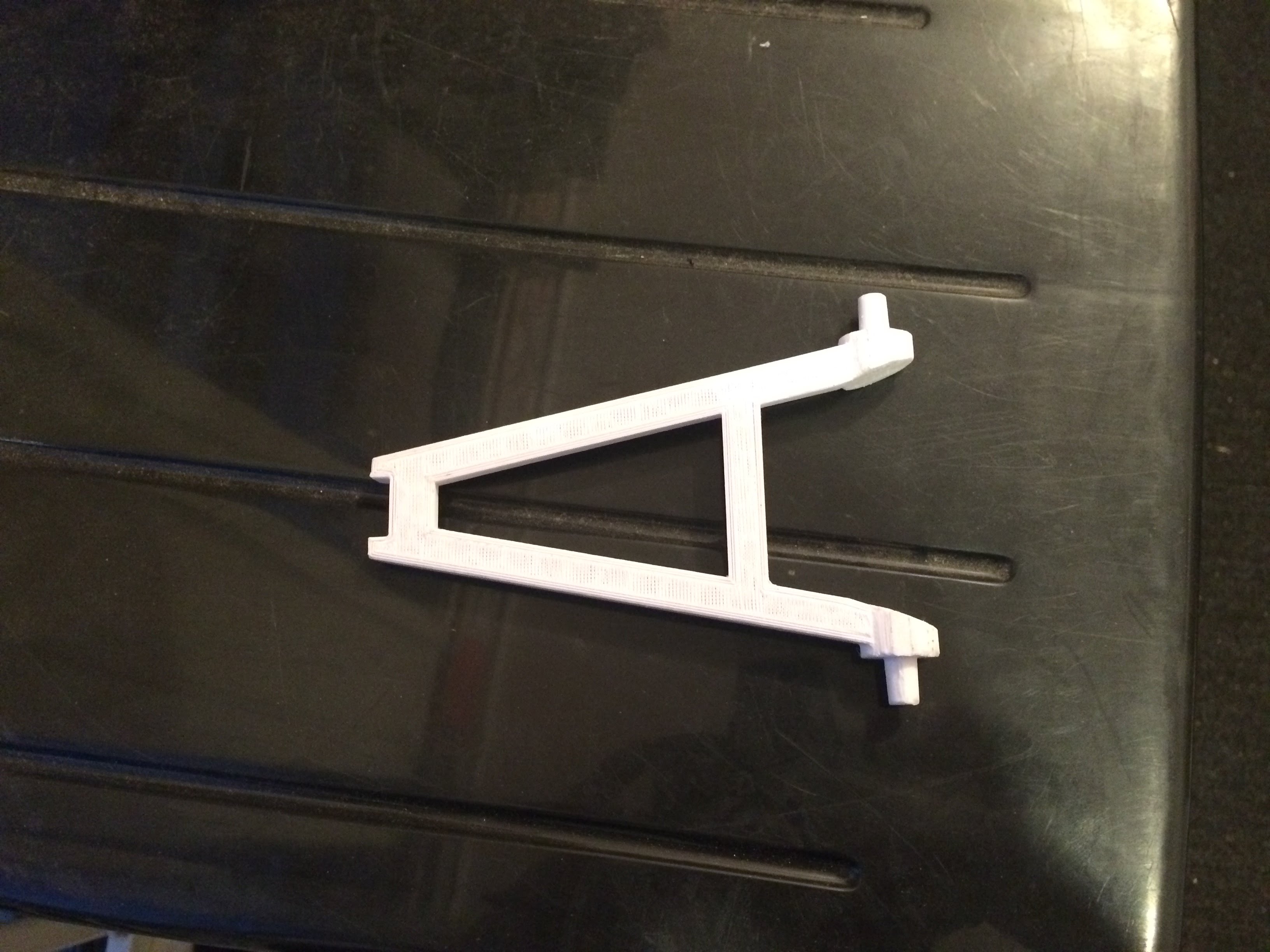

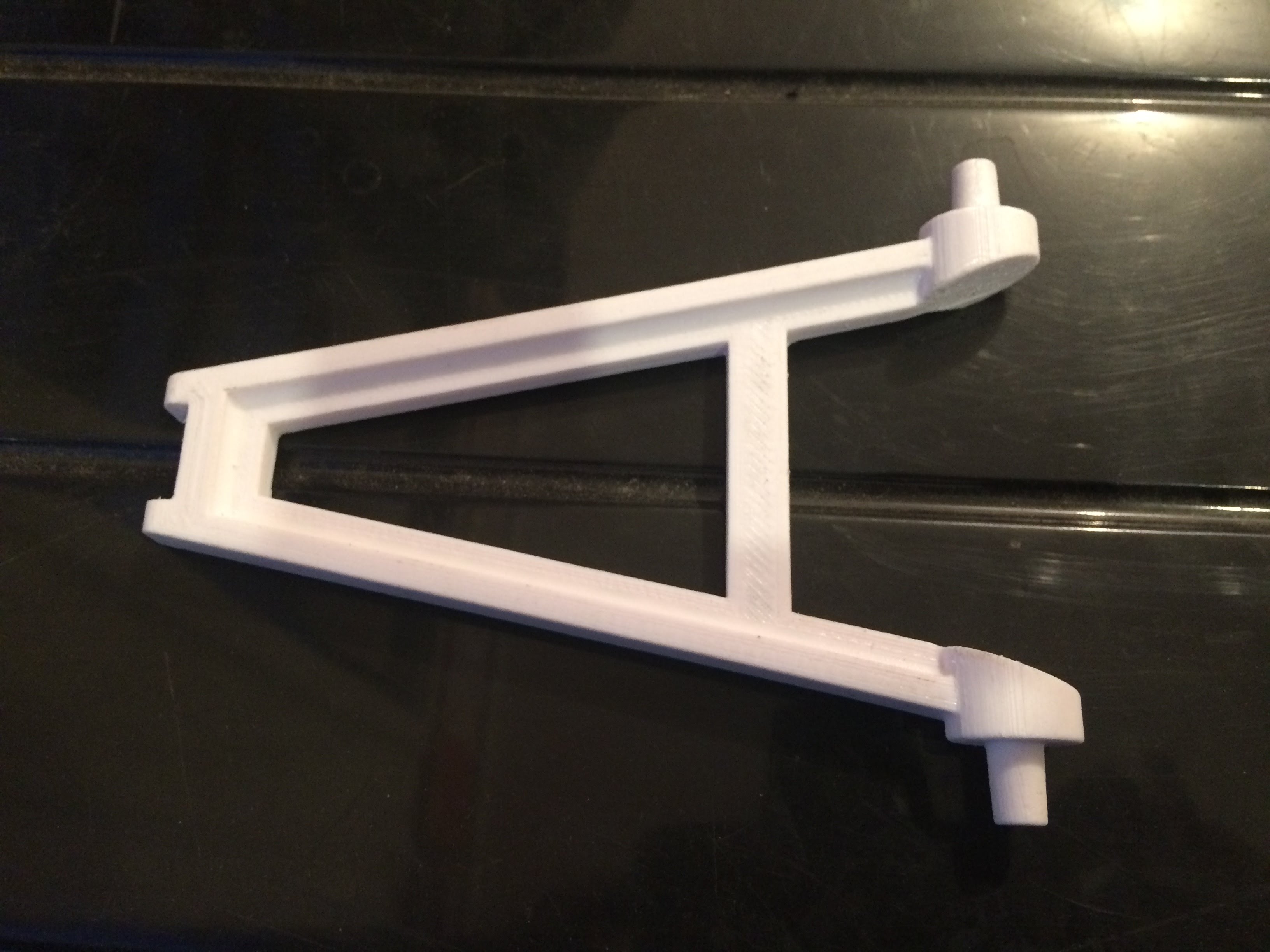

The STL file works great! Now I have a plastic part for an outboard I don't have..... Now if it was a 1/3 scale crank case that would be a different thing all together!
Ok so you want to see some pics, with out pics it did't happen right!
It took about 3 hours to print at 0.1mm layer height, I need to work out better settings for building on a raft the under side of the part is not 100% other than that it is not too shabby.

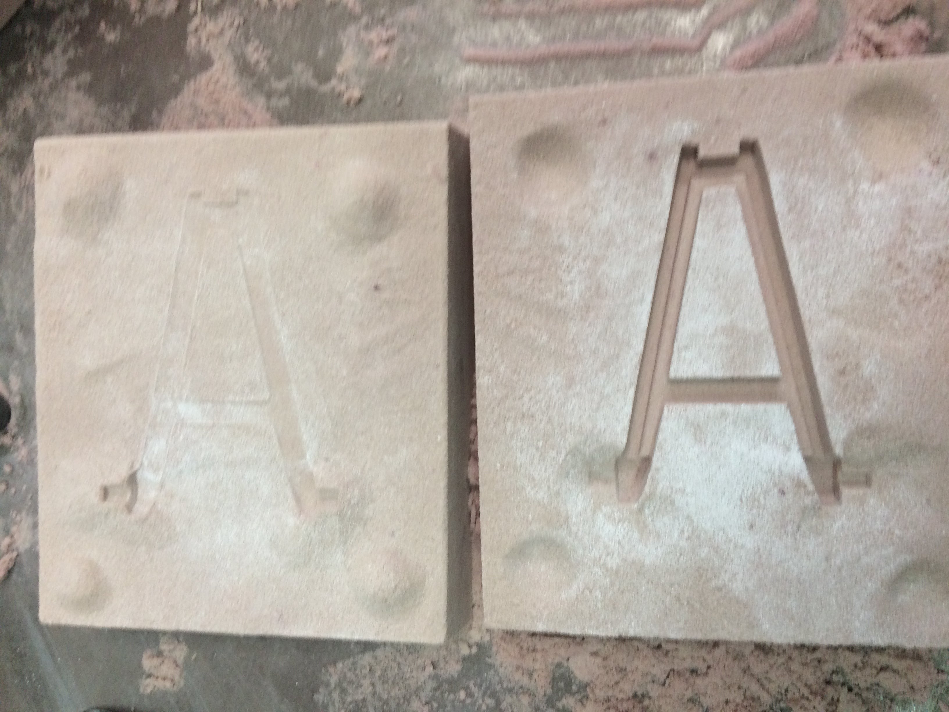

Stage one of the casting process complete
I went down to the foundry today and rammed up 6 brackets. ( I was doing them to keep the cost down)
They will end up being cast in manganese bronze(C863) it is more yellow than brown, close to brass is colour. I was going to see if I could have then made in LG2 (leaded bronze) but he did not have enough and it costs moon beams... so we will go with what we can get.
I would cast these things myself only with work getting in the way at the moment they would be a long time comming!
I will let you know more as it happens!

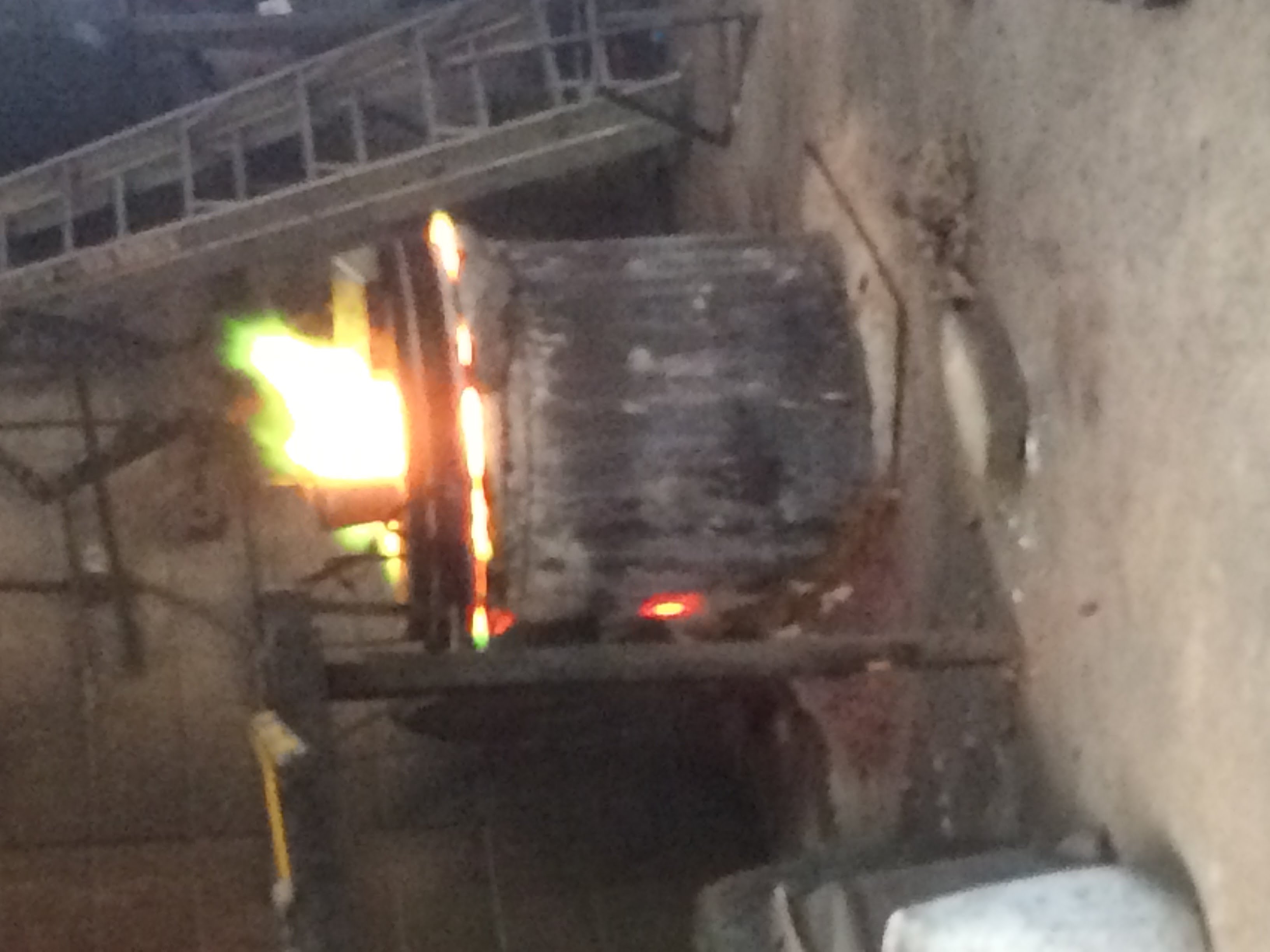

still need to cut the in gate and runners https://youtu.be/EkVZgN5HVXg
I like fire!
Now that is funny I have just tried to turn the photo around.... now there is twice the fire
