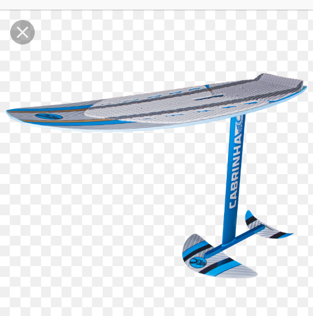

I have also been thinking about hydrofoils. To reduce the resistance of the boat in motion. But tge ones they use on surf boards are far too expensive to buy but they seem to be the right kind of idea. If only i knew someone with a hydrofoil board i could measure and copy maybe scale it up to fit the boat and add some kind of control surface. I had thort joy stick controls like a plane. Up down left right with a twist grip for throttle
Re: Boats ans Seagulls.
Look up Moth sailing dingy on you tube.
Replace the upright member with the seagull engine. Put some little sides on the board or make a super light dingy
Those moth dinghys look good
