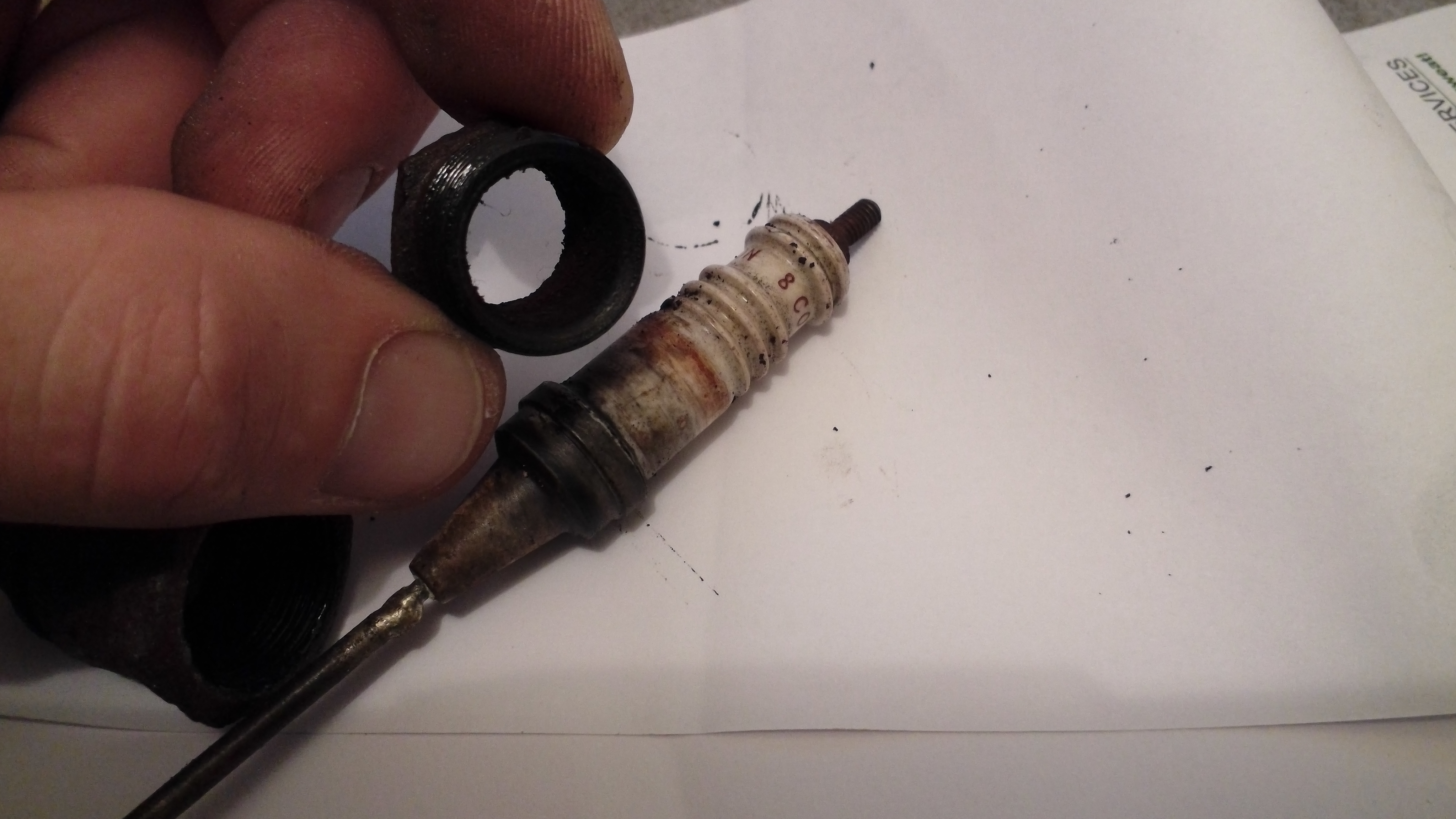

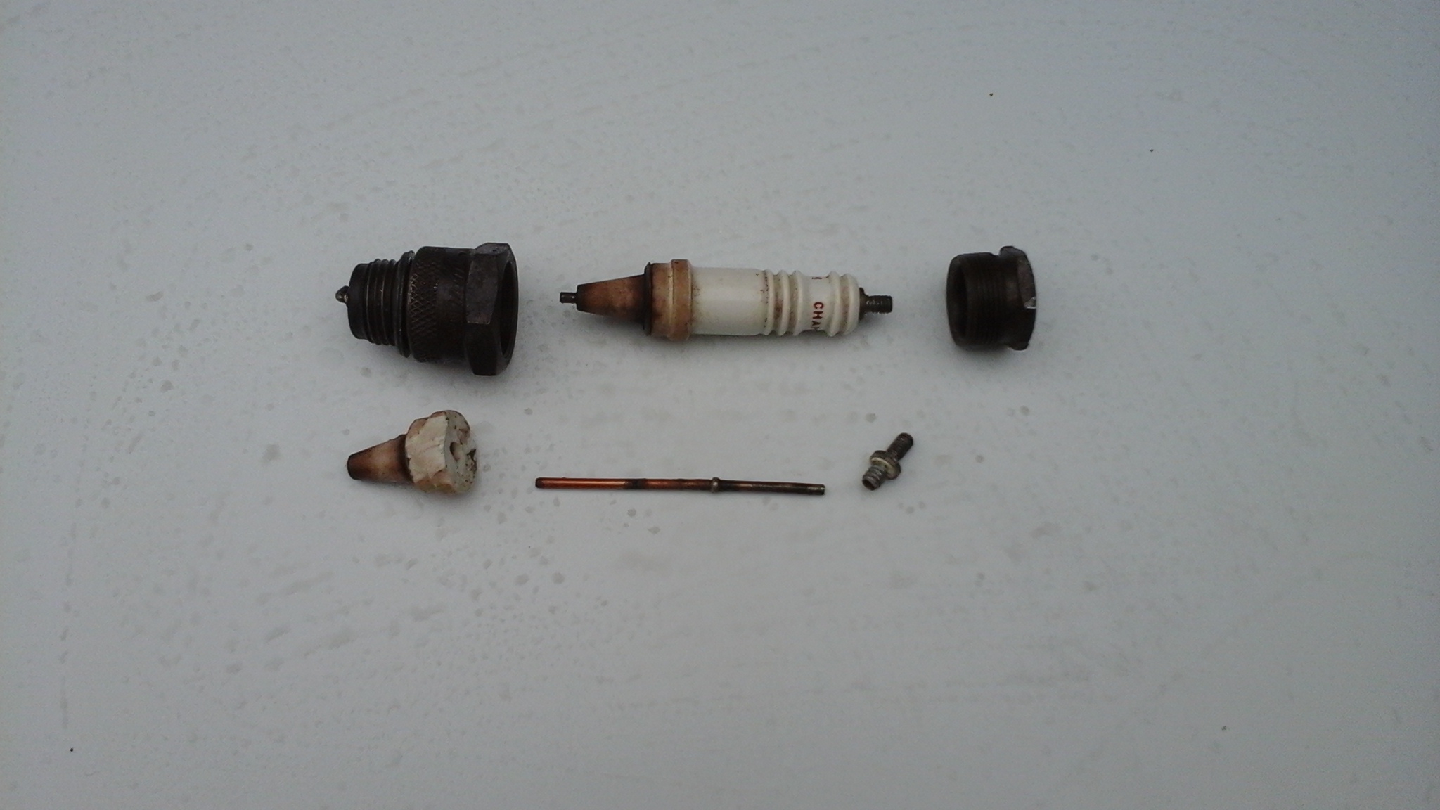

I found one of my 8 COM plugs had a fractured insulator. So I smashed it up to determine how the central conductor was constructed. The main core went from the tip to the HT threaded connector. It was simply loosely engaged into the bore of the threaded connector by approx. 1/8". There was plenty of diametrial clearance (probably about 0.010) between the conductor and the bore. This would explain the lack of electrical conductivity and also some resistance with some plugs. It would have no adverse affect on performance or reliability, which was my concern.

Jeremy may I have the metal parts of your 8 com, as that will save me destroying one of mine, please don't throw them away.

Any chance of a photo please Jeremy?

Certainly, I will post one tomorrow. Obviously my description was a bit vague!

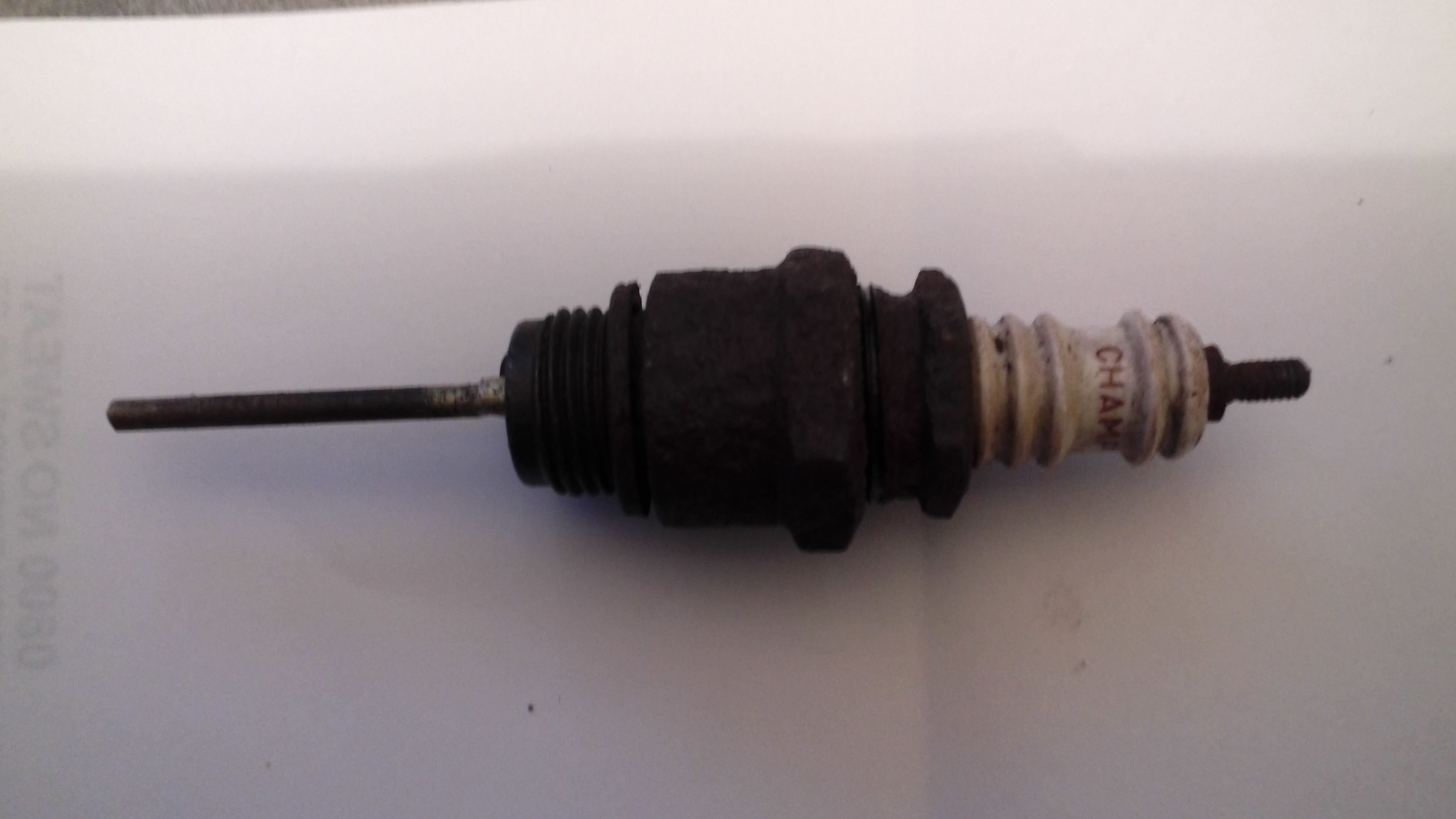

Is this what you are talking about?
This is the 8COM that I cooked to get apart. It did work after I cooked it, but I wanted something to find top dead center.

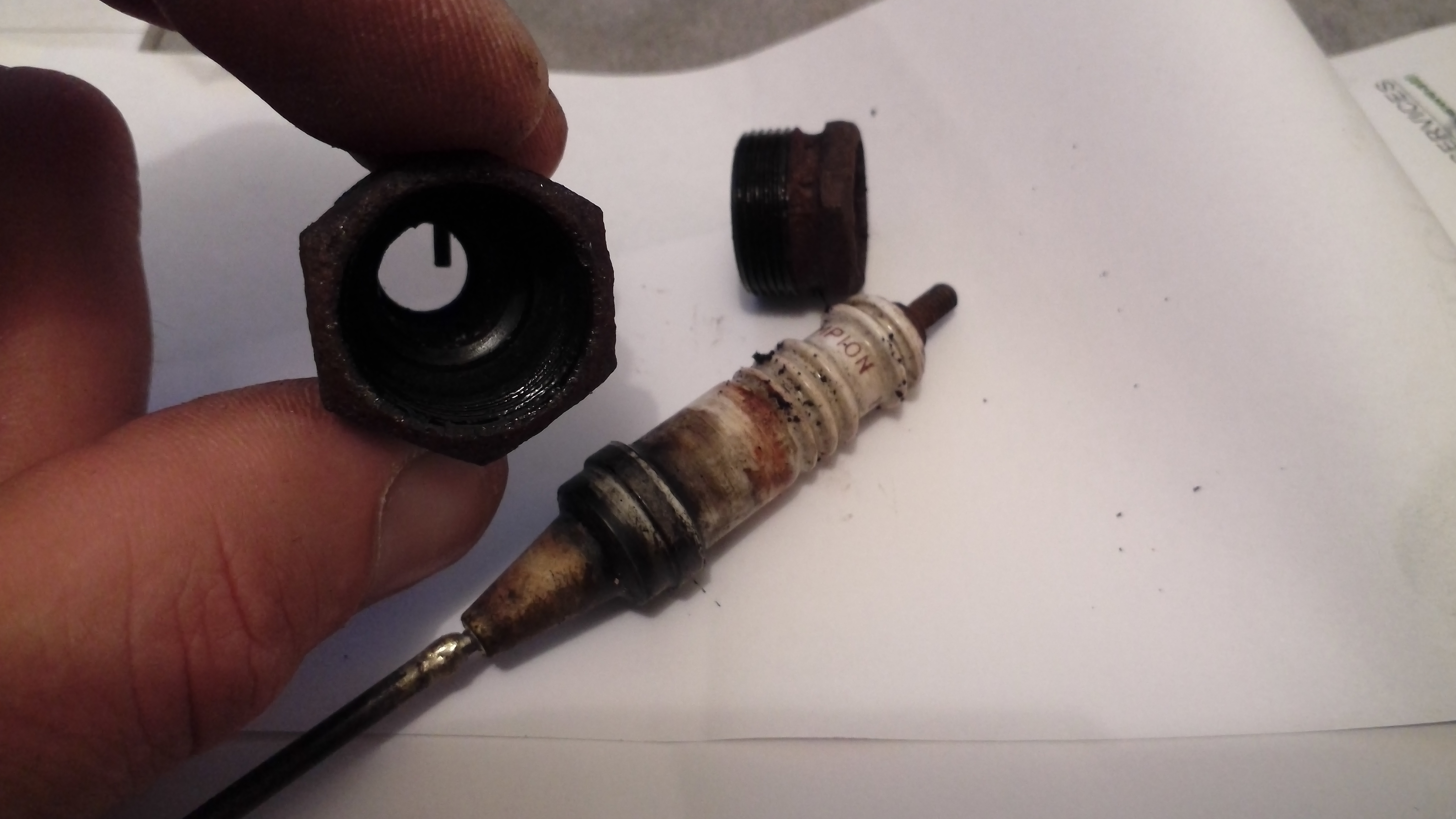

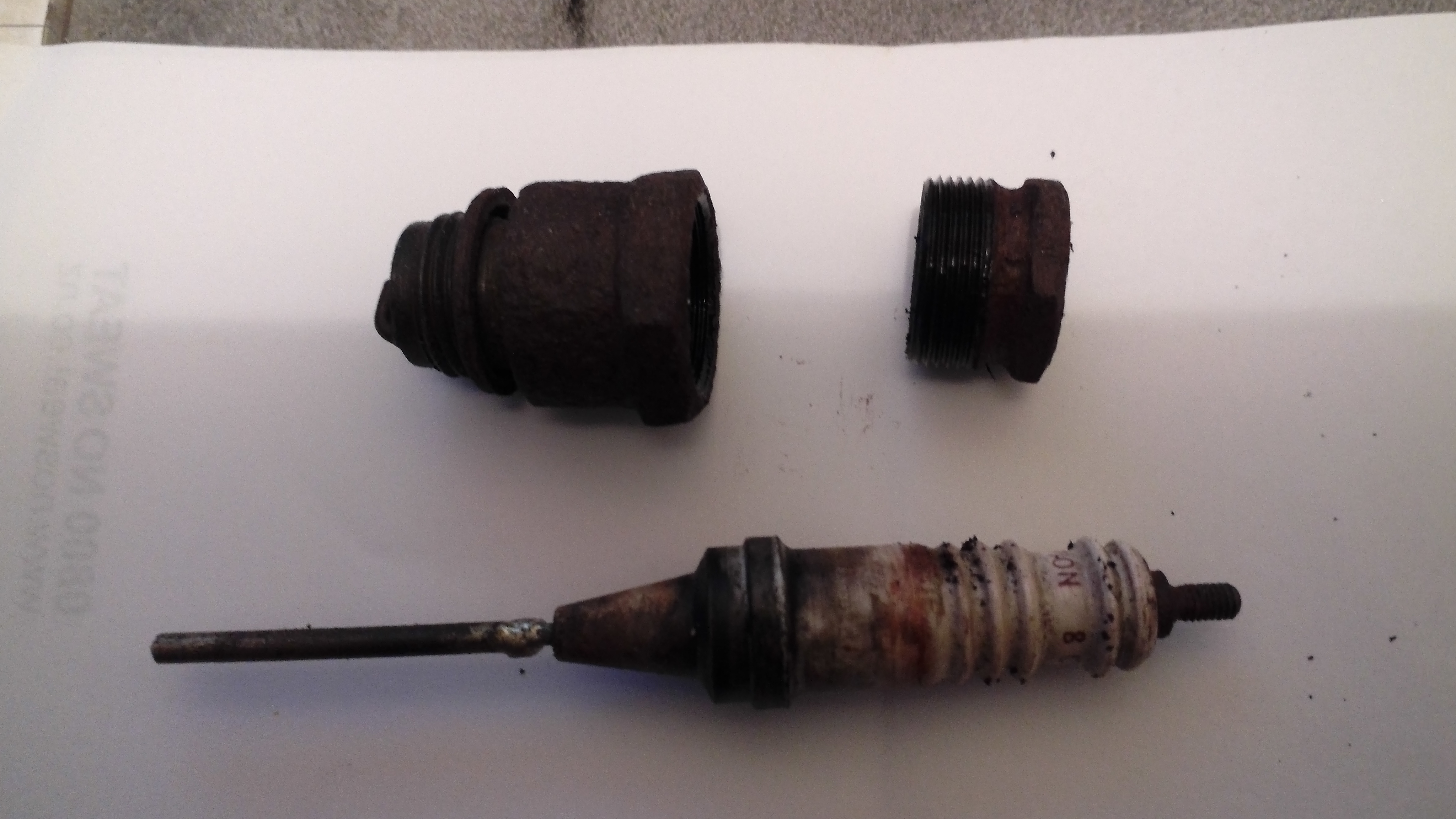

Hugo,
Here is the photo of the stipped down/ smashed up 8 COM, showing the central conductor and the top electrical conection into which the central conductor goes.
I have also e mailed the photo to you directly. Jeremy

Excellent, thanks Jeremy. The join of the connector and the electrode does seem to be a weak point. You would think it would be threaded or similar. A bit of arcing there would cause pernament problems. I'm assuming the electrode assembly was fired (in kiln) within the porcelain. Not as l imagined.
