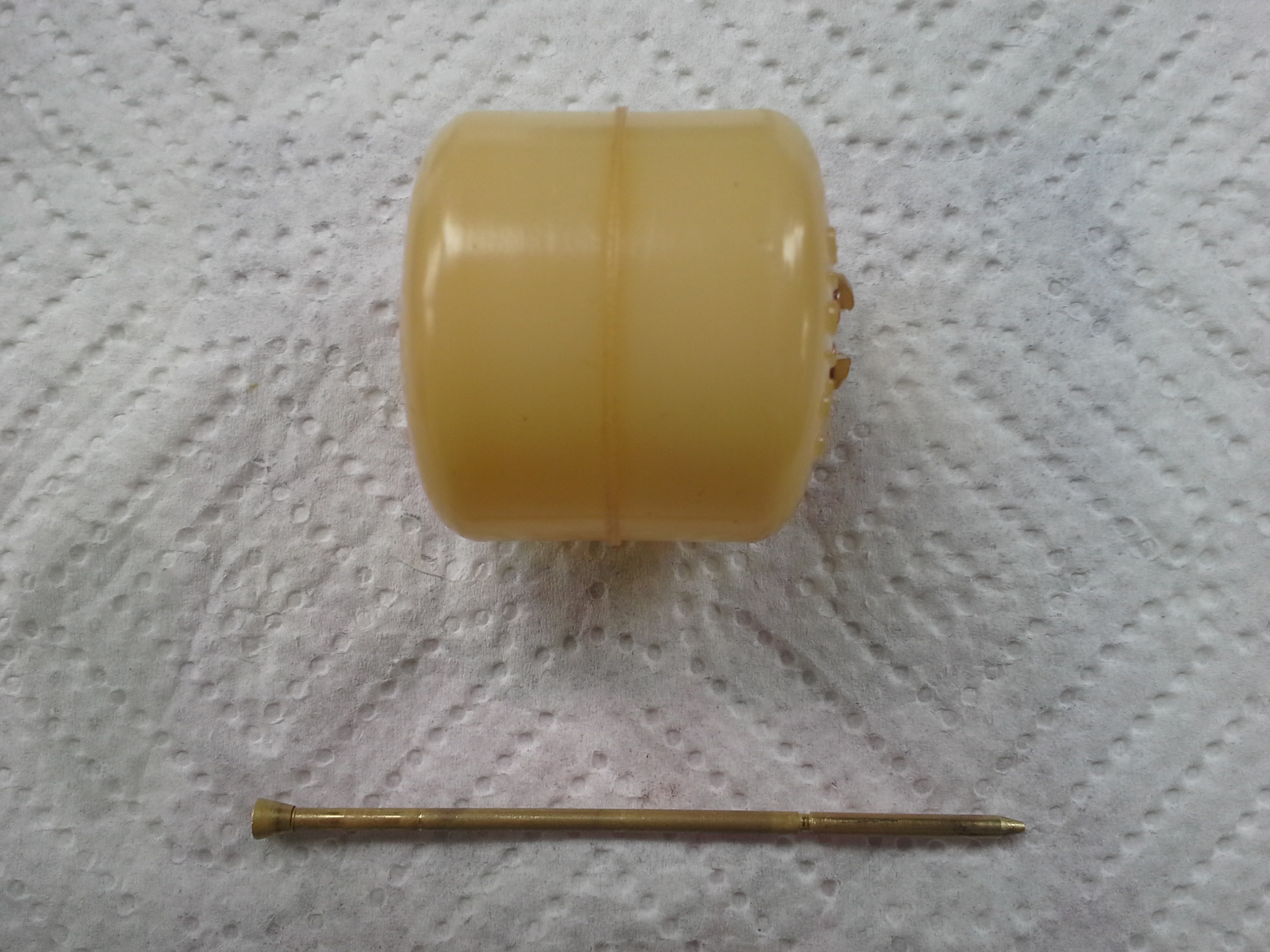

Keith--could you (when you have a spare minute) post the total length of your needle and the measurement to each notch from the pointy end?...would like to compare with what I have.
From the close proximity of the two notches my guess about compensation for different fuel specific gravities may be correct. Adjustment for use at different altitudes seems more likely however. Wonder why mine (and others) has only one notch.

I t's a possibility that someone has replaced a faulty float, tested that runs, sell it, the wrong float could cause over fueling.
Measure your float, diameter & height & post a picture, so we can rule that out.

The float is an Amal 22/016, measuring 1.253" in dia and 1.316" from bottom to the top of the clip collar.
The needle measures 2.512" total length and 0.704" from tip to centre of the notch.
