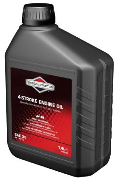

by pat777
Charles uk wrote: These powerheads were designed to run a 30 weight engine oil fuel oil mix
All of the pre 25:1 Seagulls had the same bearing clearances from 1931 up to the 25:1 era,
So just for clarity for newbies, when you say a "30 weight engine oil", Is that SAE 30 that you are referring to.
sae 30.jpg (14.34 KiB) Viewed 4179 times
Re: Upset century
Posted: Sun Sep 03, 2017 11:55 am
by Charles uk
Yes something very similar to SAE 30 but with less modern additives, there are several Kiwi Seagull racers who swear by a SAE 30 2-stroke mix & their results seem to prove their point!
It would be fascinating for all, if someone with suitable measuring equipment (GPS & Digital rev counter) would run a series of semi-scientific performance tests to see if the Kiwi's claims are valid, & to see if the smoke issue is accurate or an old wives tale.
A sort of before & after scenario on a 50 plus year old Seagull.

Posted: Sun Sep 03, 2017 12:29 pm
by pat777
Jon I can't find your new thread. If you can post a link to it please.
Thanks Charles,
So if not SAE 30, do you know a brand name of the 30 weight oil that I could look up please?
