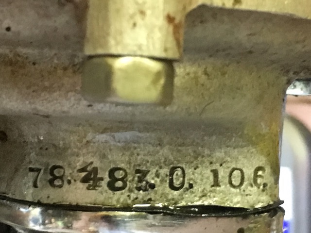

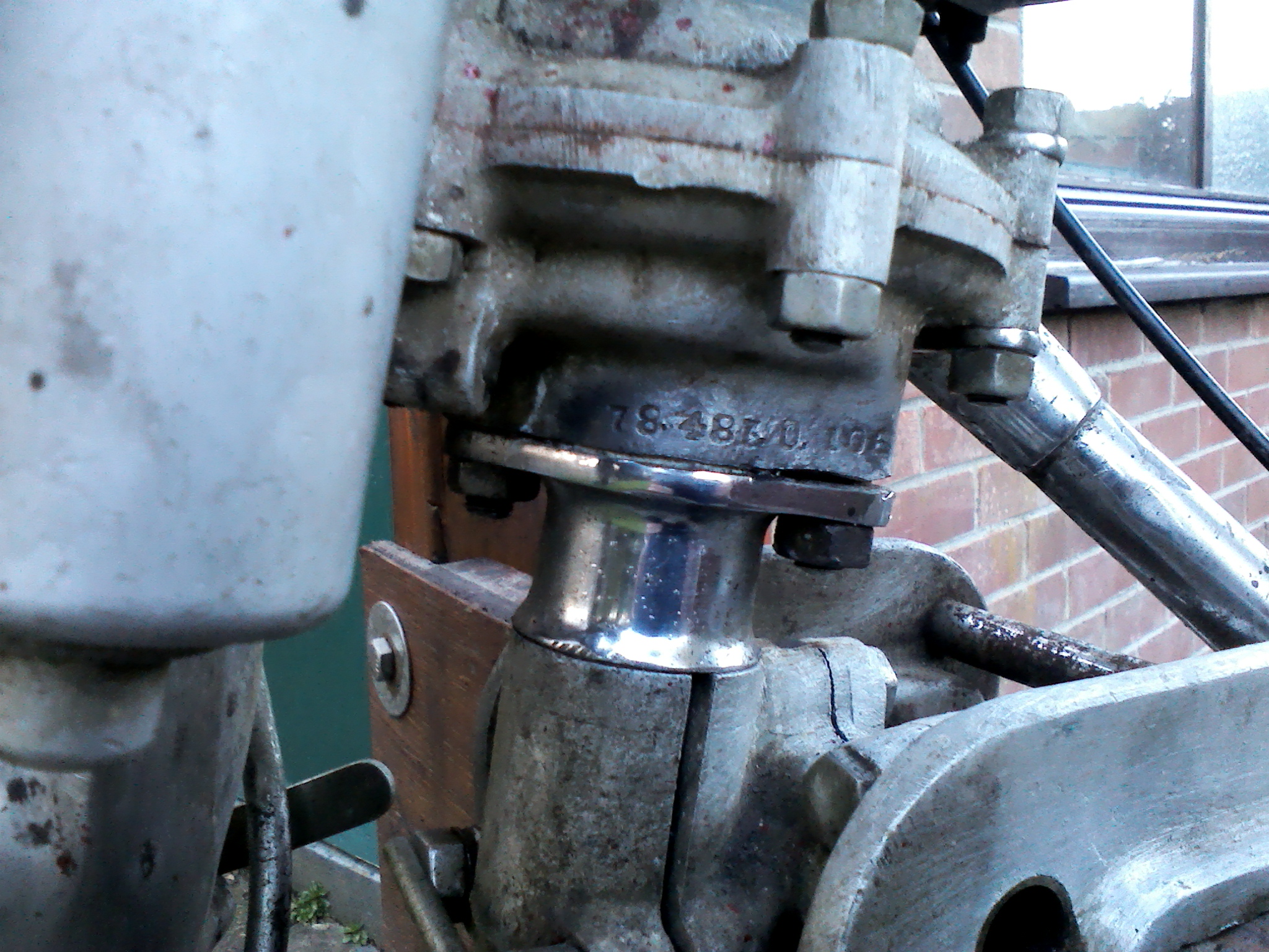

I watched careful what was going on and no overheating occurred it was also well lubricated from the re build and was also tested in water in my tank in Tassie for about 15 minutes with good cooling and water flow before the dicky ignition system let me down. It was stripped, inspected and shipped back. A boroscope showed no corrosion in the water passages and the unmistakable imprint of the original sand castings. Yes they are thin but when new were deemed to have adequate material to warrant the advertising concerning strength and resistance to corrosion. Only years of non flushing and salt water caused the damage often exposed in heavily damaged cylinders.
Rest assured that as a marine engineer who soiled and maintained old steam tankers I am well versed in corrosion.
Attached is a photo of the OA full number

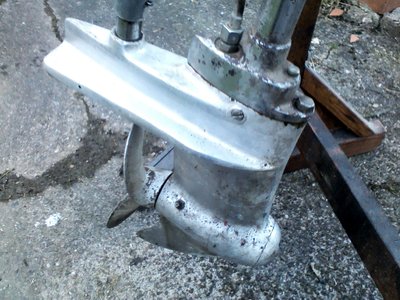

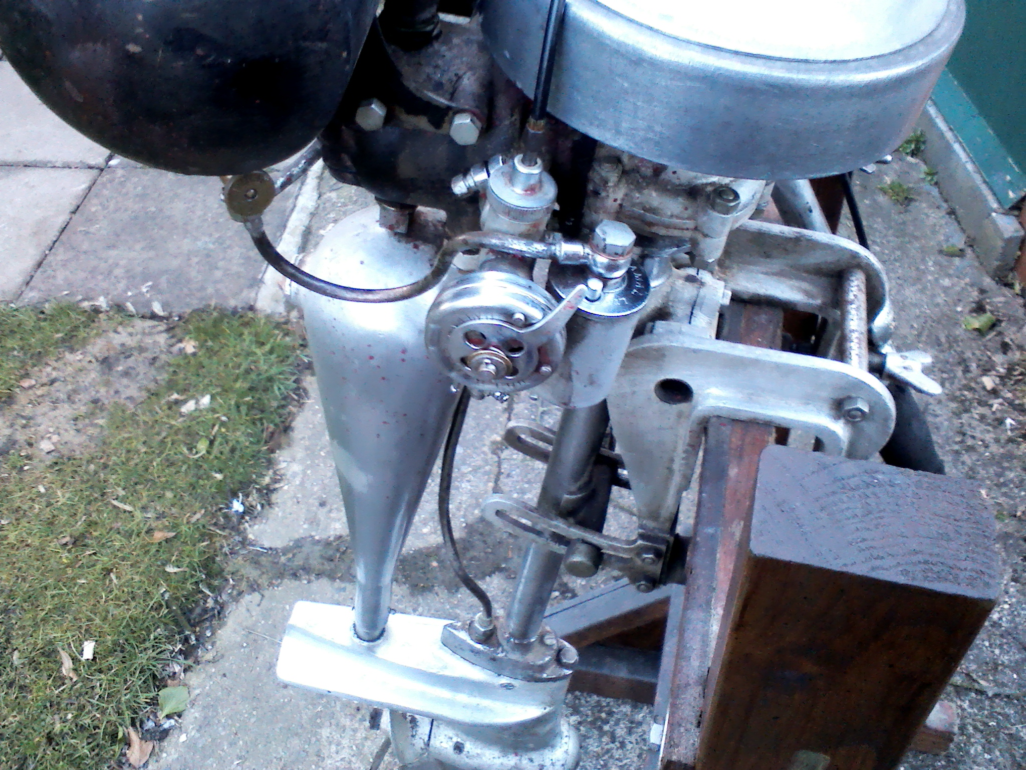

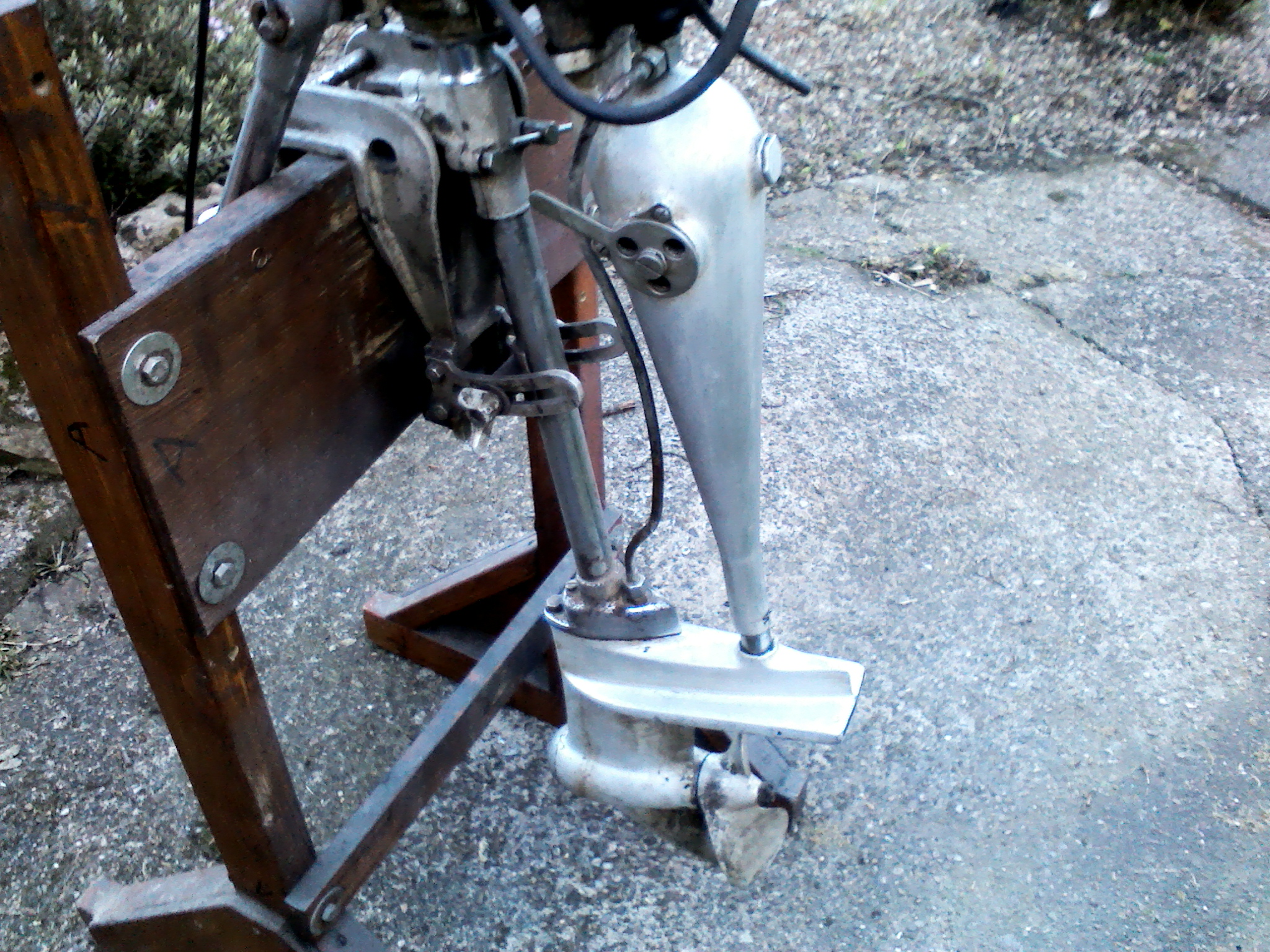

Re: Marston in the UK
Hello
Having been a follower of this forum for a few years now i thought it time to join
i have put a few pictures on for you all to look at it used to be mine.
get well soon Adrian
Richard
Richard
Welcome aboard Richard.
Very nice to hear from one of the original owners of this motor. Quite humbling for me i must say.
This is indeed a very treasured little seagull. Well, it is now anyway. After all the attention this little one has got in the last few weeks i'm going to have to think carefully where the safest resting place will be for it. It's going to be joining an ever growing flock so i need to find a quiet perch for it somewhere .
Rest assured, this won't be the last time anyone sees this little 'un doing its stuff. It will get the occasional chance for a paddle under strict supervision of course by yours truly
and a certain "other".
Nice to see a set of before and after pics for comparison. In time there will be a few more added once the engine is looking its best, but for now at least it's more a case of getting to know it better before i go digging deeper.
