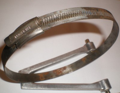

Here is an original Tank strap. British Mfg on one side of clamp and Jubilee Pat on the other. Note knurl thread 4" long only. Strap 1/2" wide.

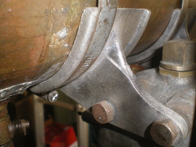

Also the tank mount is cast as such:

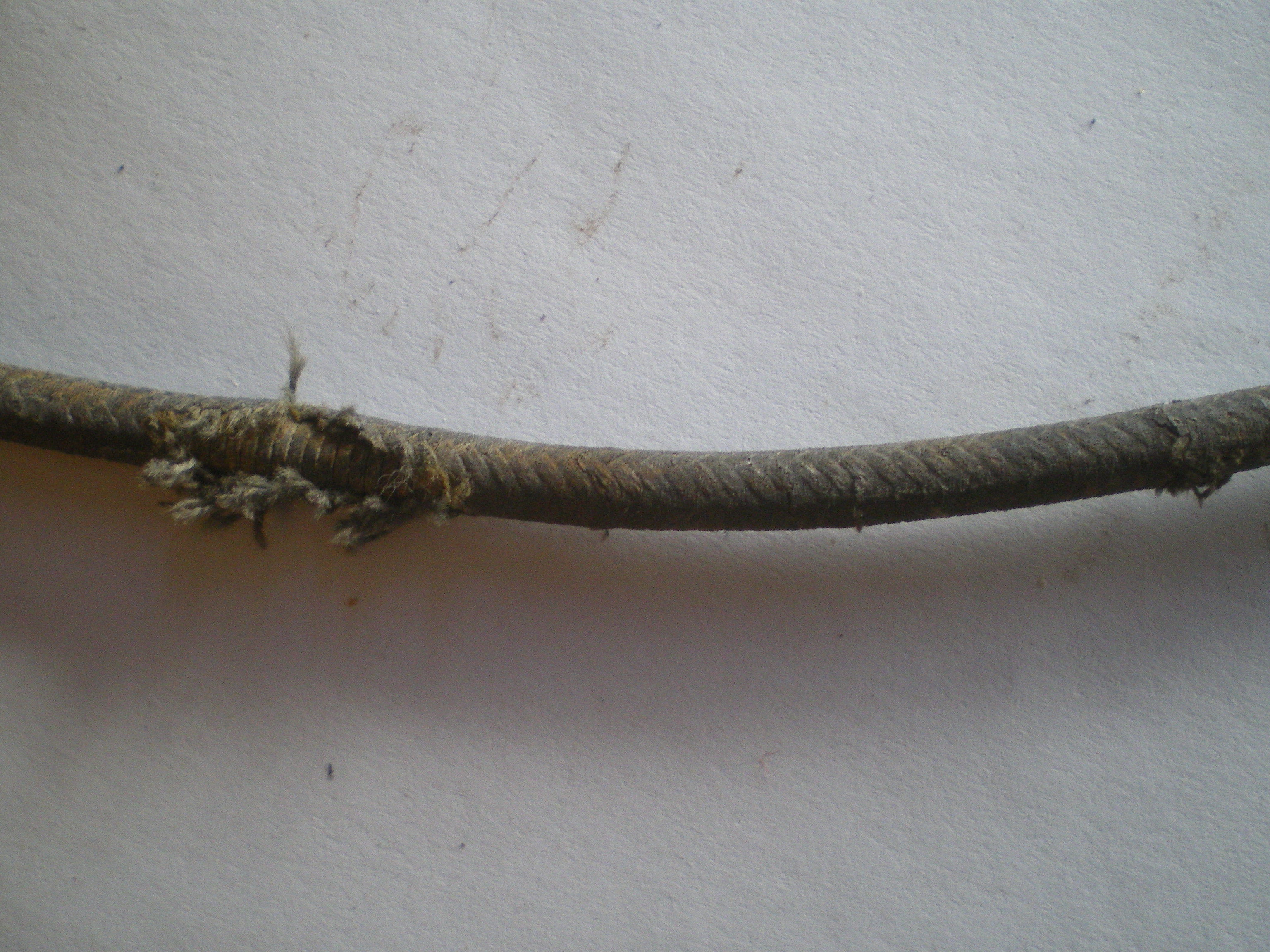

Also the throttle cable was covered with a cloth webbing. (double left click to expand photo)

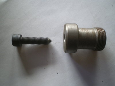

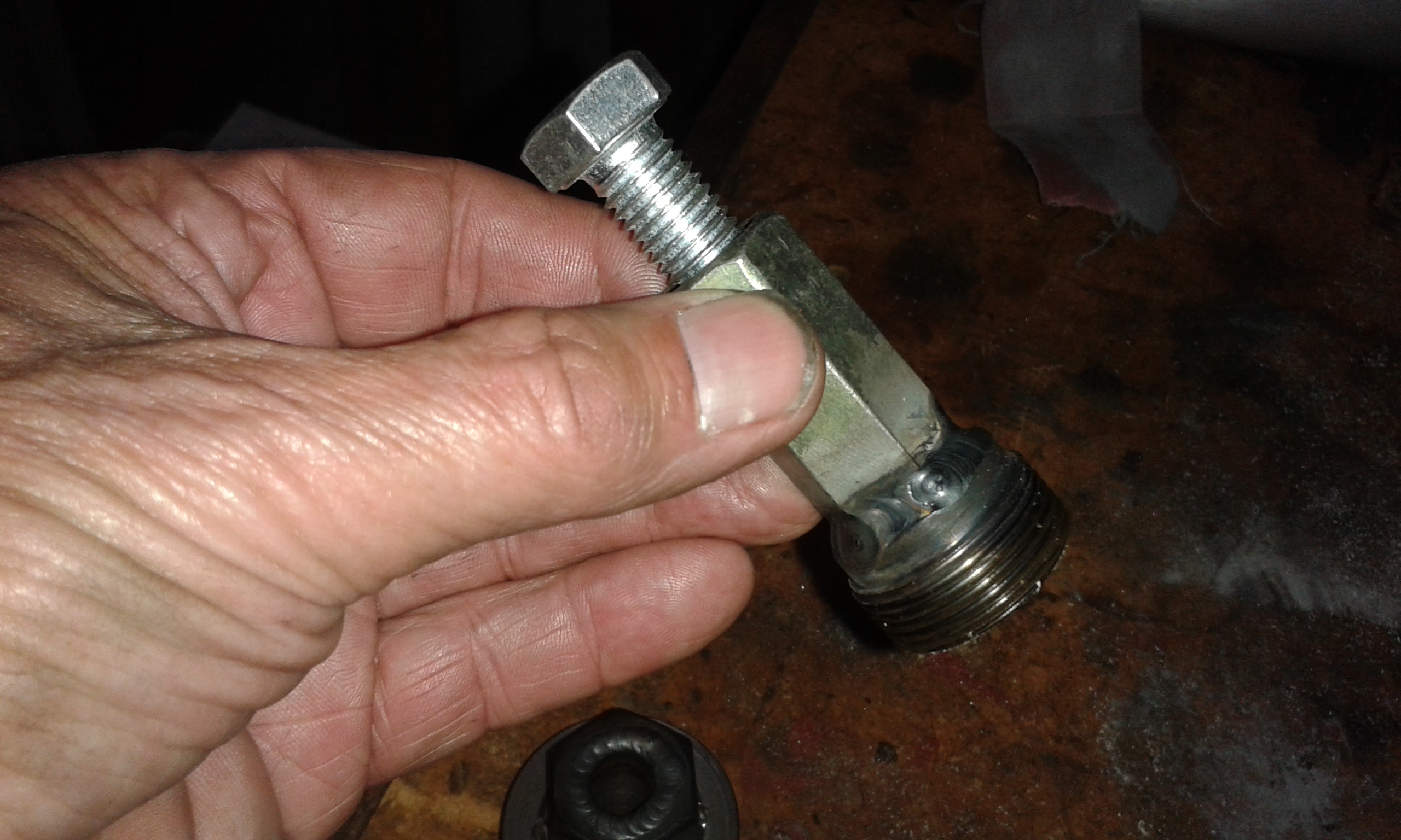

A special puller was perfected for the villiers JM magneto by the white coated boffins in the R & D team at SOS

Made by a Tasmanian devil.
Mag puller for OA
Mag puller for OA

Tassie puller in action....
JM puller
JM puller

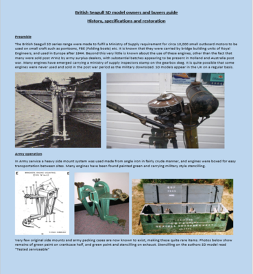

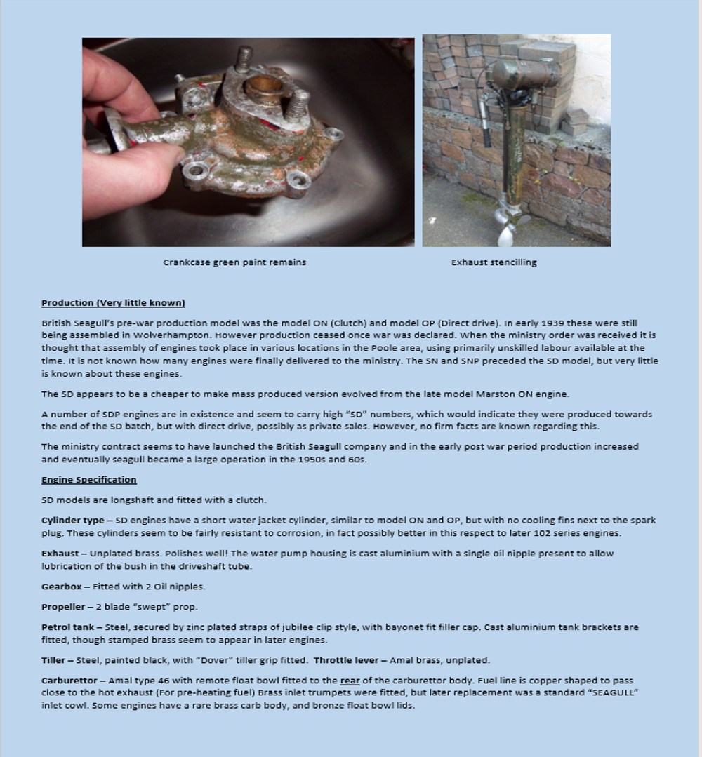

Here is the first version....

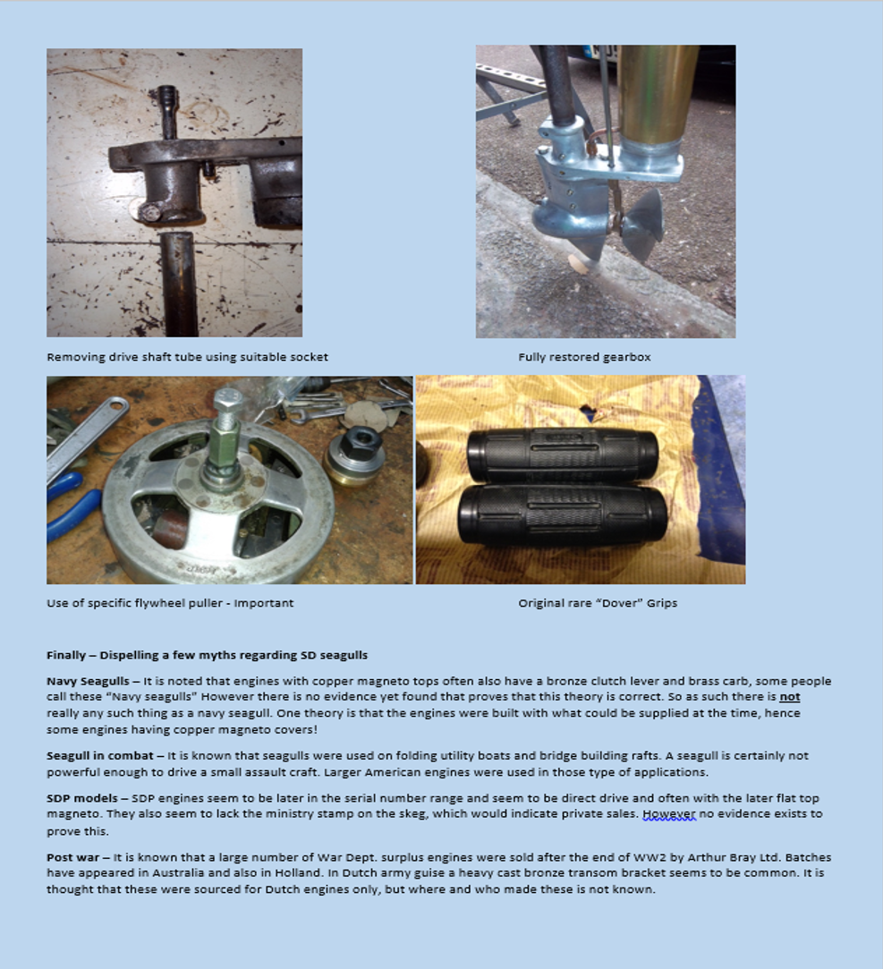

And the last page

Looks good Adrian.

Great stuff I enjoyed reading this over breakfast this morning in chilly Tassie. Both my AD's are in the UK so couldn't pop out and check their correctness. that will have to wait till May!

That I like... well done. Be nice printed on some glossy paper.
