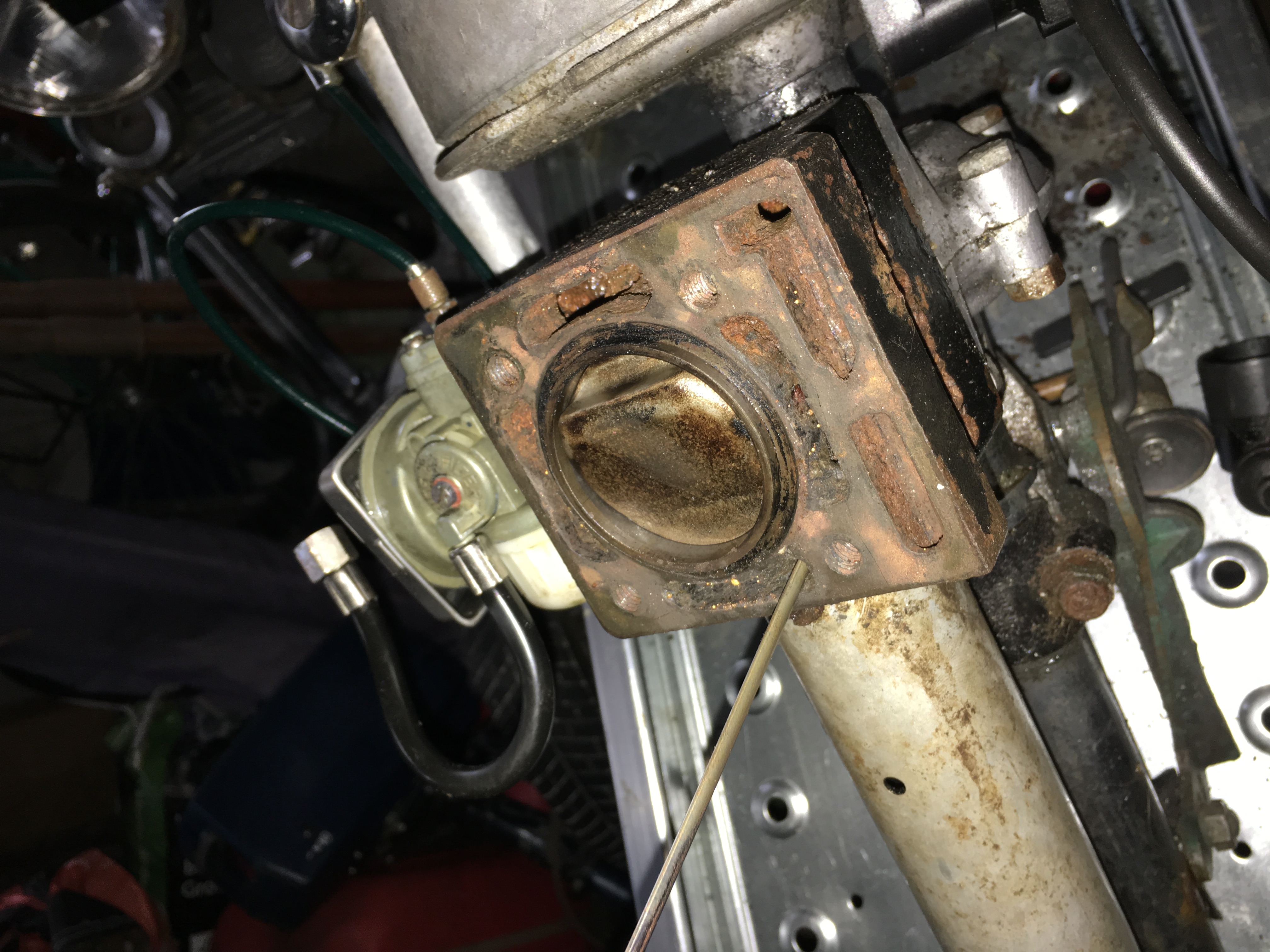

Shamba wrote:As promised some pictures; here she is head and tank removed.
Note the new stainless clamps and "hook" from SOS.
I got round to removing the head this lunchtime having sprayed everything in penetrating oil for a couple of evenings. Came apart easy with no heat required.
To my un-tutored eye the head looks okay. No carbon at all. The bore looks clean also with no obvious scores.
The water jacket looks pretty solid with rusty gunk so well worth getting the head of and having a poke around in there.

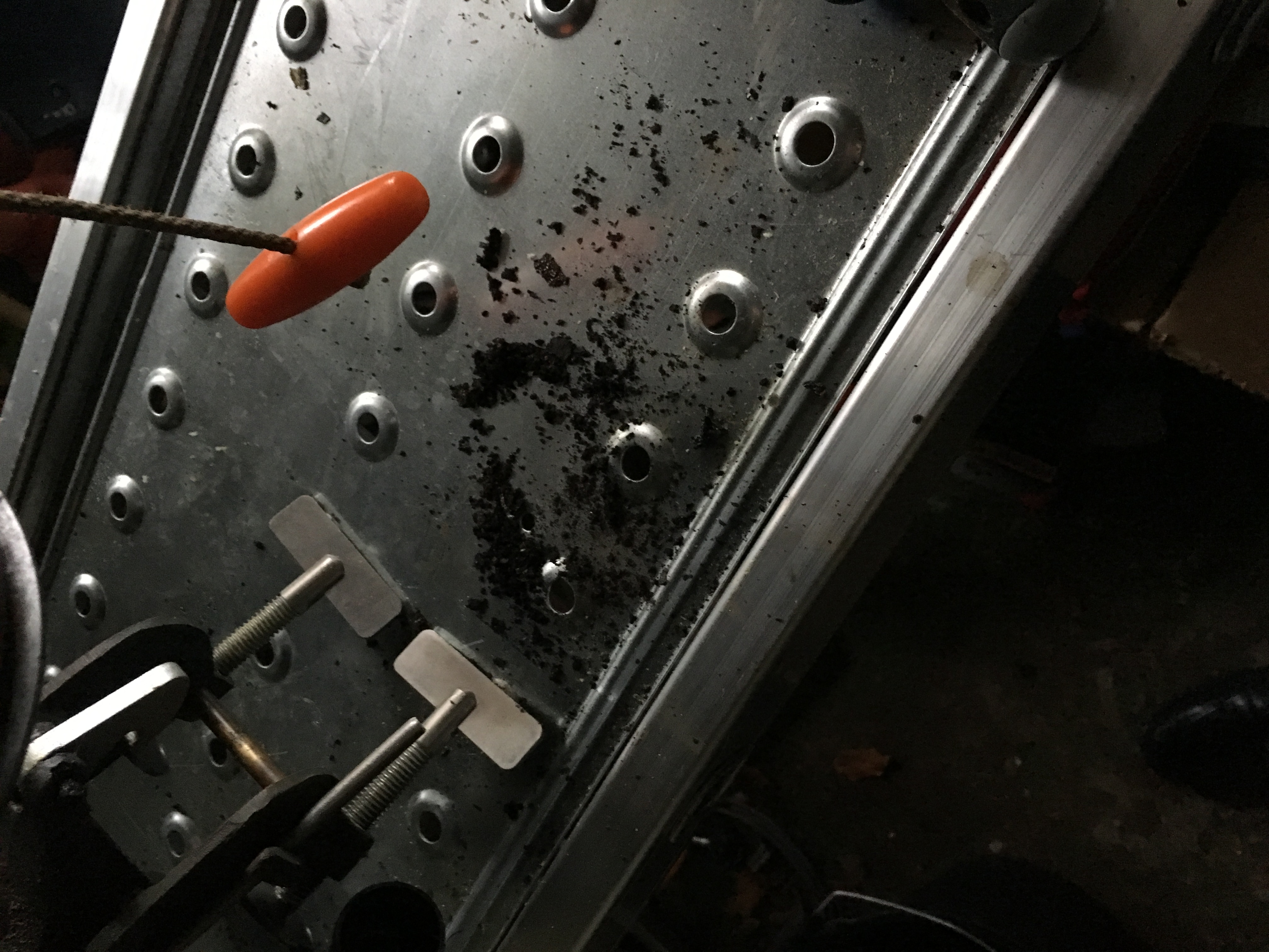

Not a lot of progress to report I'm afraid but I thought I'd share what there is.
This is the sort of crud I've been digging out and as you can see there are now some visible cooling galleries, although I think I have a way to go before they're clear.

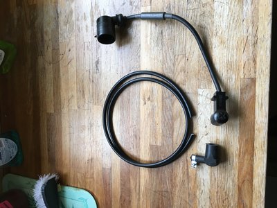

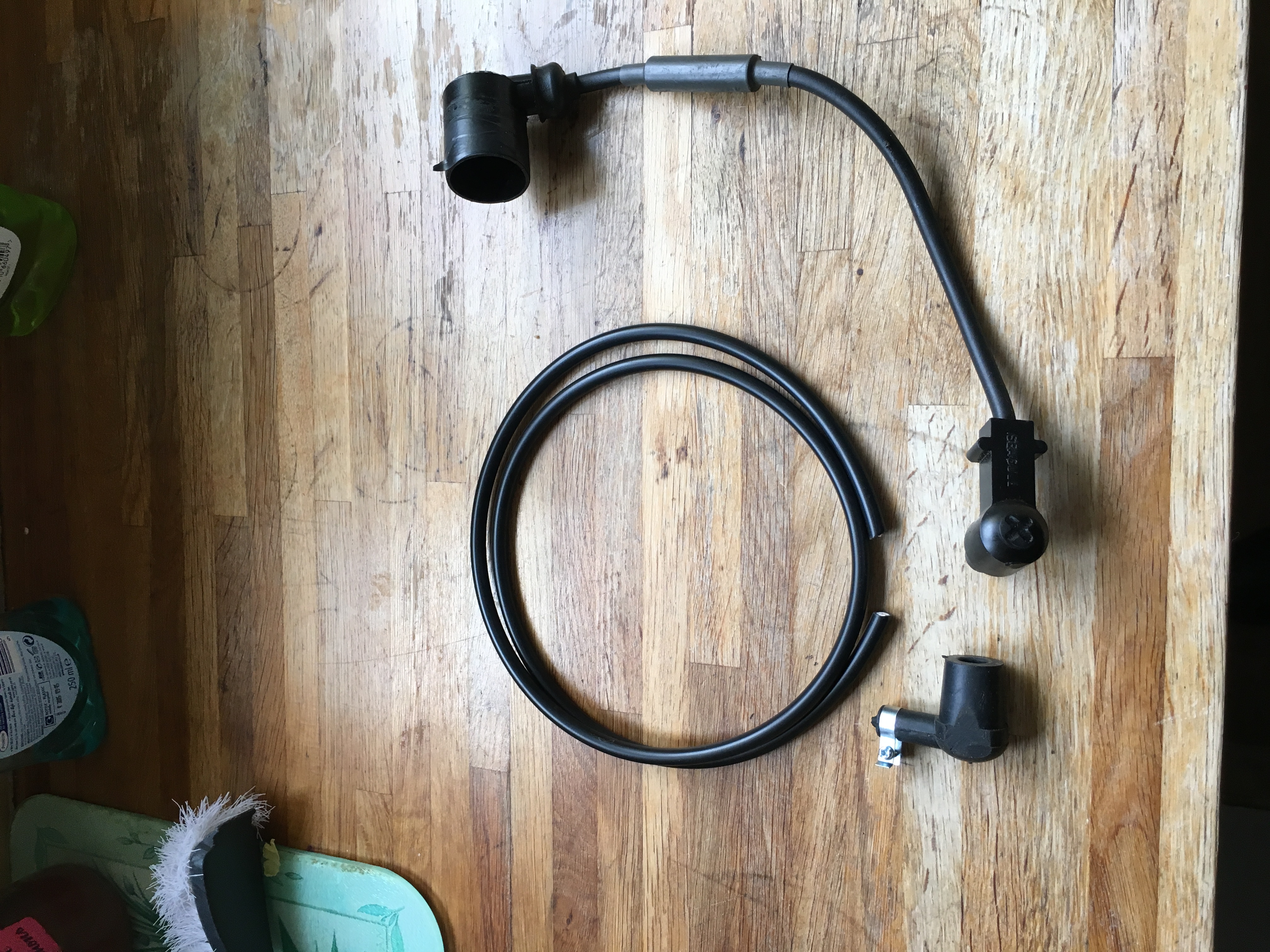

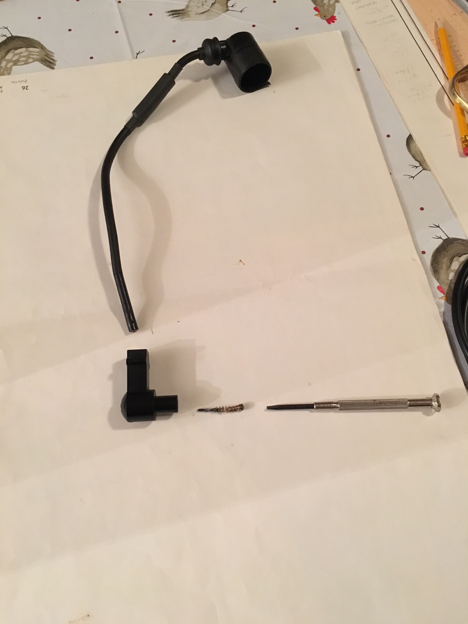

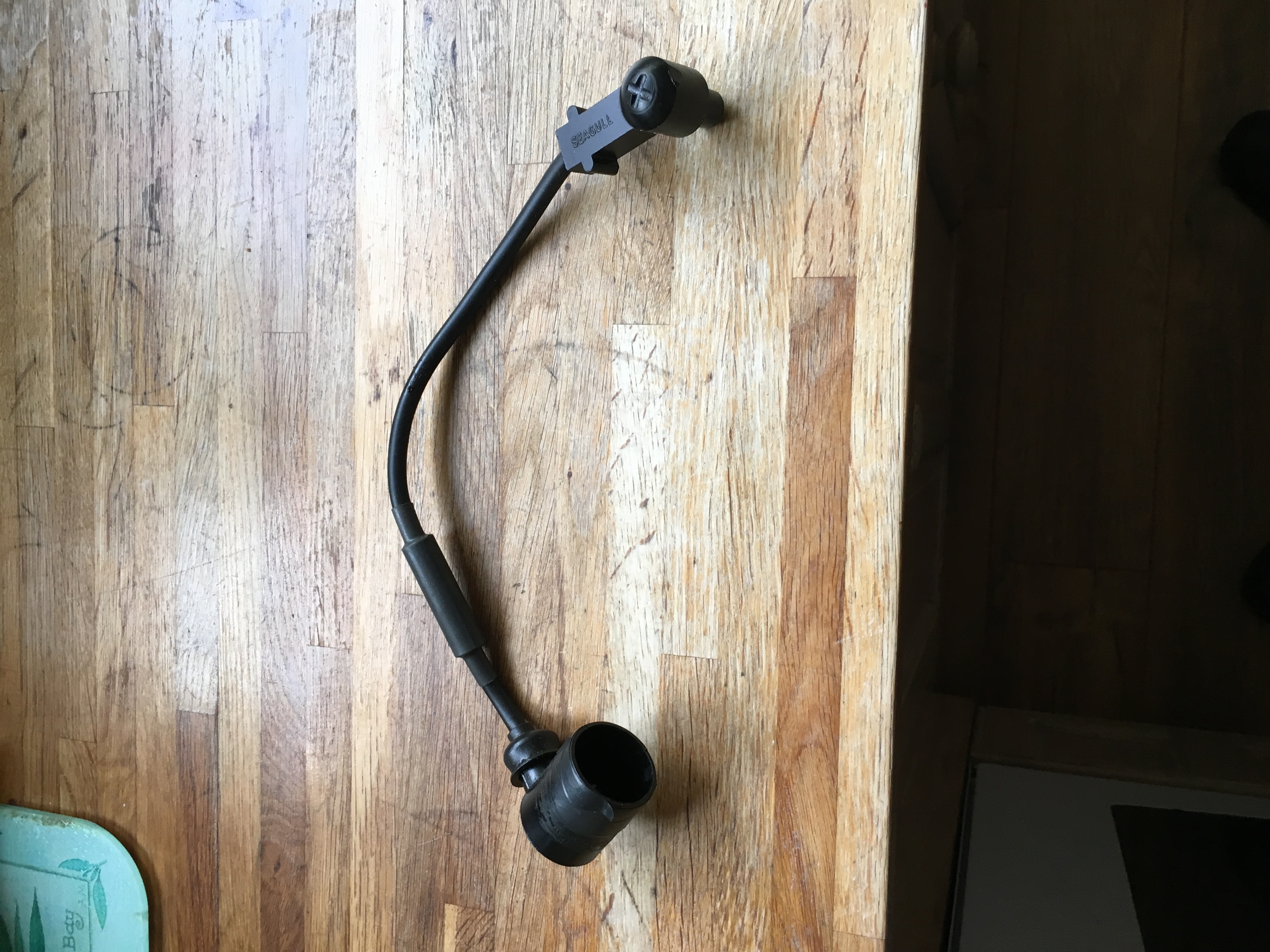

My next questions are regarding the HT lead that I'm advised to replace. Here it is (note that the plug cap is cracked unfortunately for the bakelite lovers amongst us) I have a new plug cap and want to change the HT lead as well. I have some new HT lead and s plug cap but how to I get the magneto end attached. My understanding of earlier comments was that it would unscrew but application of reasonable force has failed to effect any dismantling.

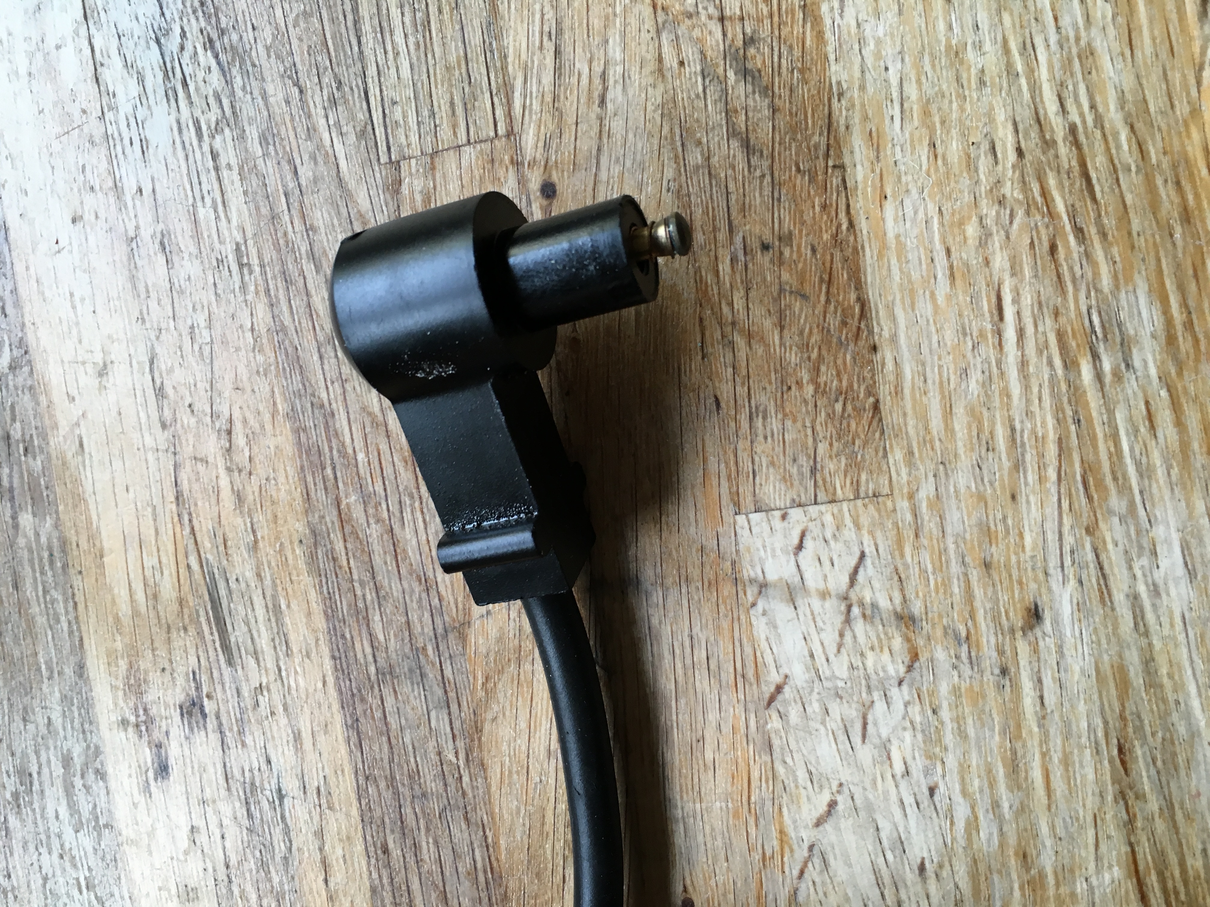

Does this thing....
....come off so I can make up a new cable
or not?
Does this thing....
or not?

Yes it does,you need to remove the pin from the spring,very carefully,then insert a very fine screwdriver and undo the wee screw that holds the spring and cable in place
Re: GFP 40+ starts but won't get going
If you look at the end of the HT lead that goes into the magneto, you will see a brass contact with a small Spring underneath. Carefully pull the brass connector out and you will see a small screw where the bottom of the spring sits. Undo that screw and the HT lead will come out. Refers the proces with a new length of HT lead, and when it is all assembled do a quick continuity test with the meter. Job done.

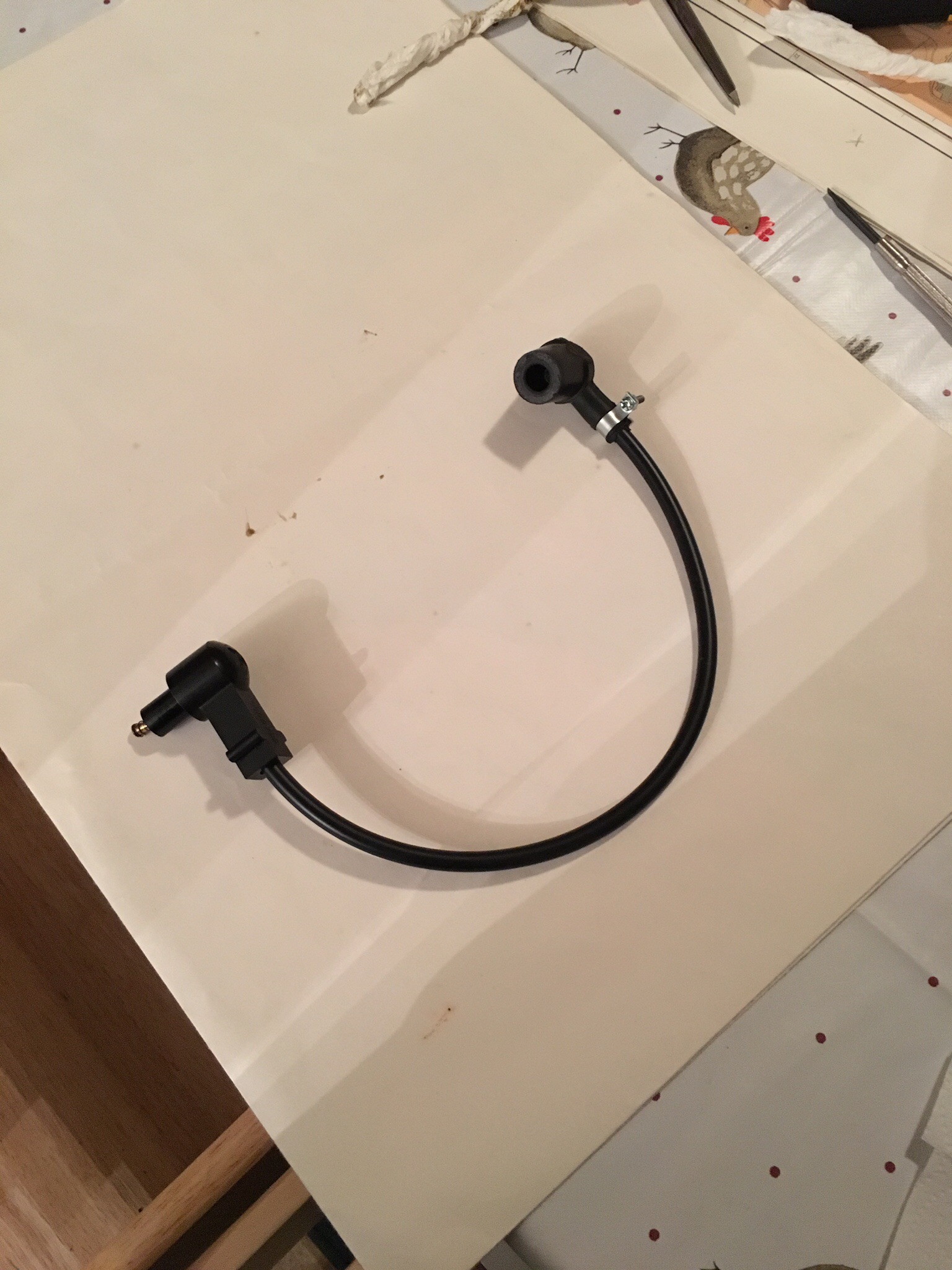

Success. That happened exactly as described
Allowing me to assemble a new ht lead thus
Thanks guys. Couldn't have done it without you

Who the heck sold you an HT lead without the inboard end? Or maybe you were just making a new one on the cheap!
Well done if you stripped and rebuilt that inboard end without the spring going out of shape!
By the way, do not use the metal clip on the HT lead outer end on the plug, a driop of Sikaflex or Silicone will stop it falling off and seal it.. the clip just goes red rusty. If you really think you need a clip, use a small black cable tie.
That suppressor in the lead dates the lead to 1978. it was a diasyer for Seagull they had to scrap thousands and replace loads.
The steel screws on the end of the suppressor get one sniff of salt air and go rusty, rust is an excellent insulator!
Amazingly I still find loads of Seagulls with these 1978 leads on them. I bet Seagull sold them to dealers and they did not scrap them, but sold them!
New lead and cap £16.75 from SOS.
By the way the membrane over the filter is old fuel turning to varnish, a good carb cleaner sorts it!

Just a little tip Steve, a small masonary drill works quite well at removing the crud from the waterjacket. Gently though.
No complaints from me using rtv . Been using the stuff for years with no problems.
RTV it is then. I was thinking about some "dentistry" with a Dremel-like tool for cleaning out the water jacket galleries. I assume that a masonry bit works by whacking the crud with the spade like tip without any real risk of drilling the casting?
