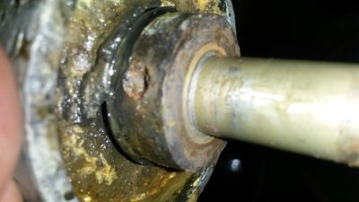

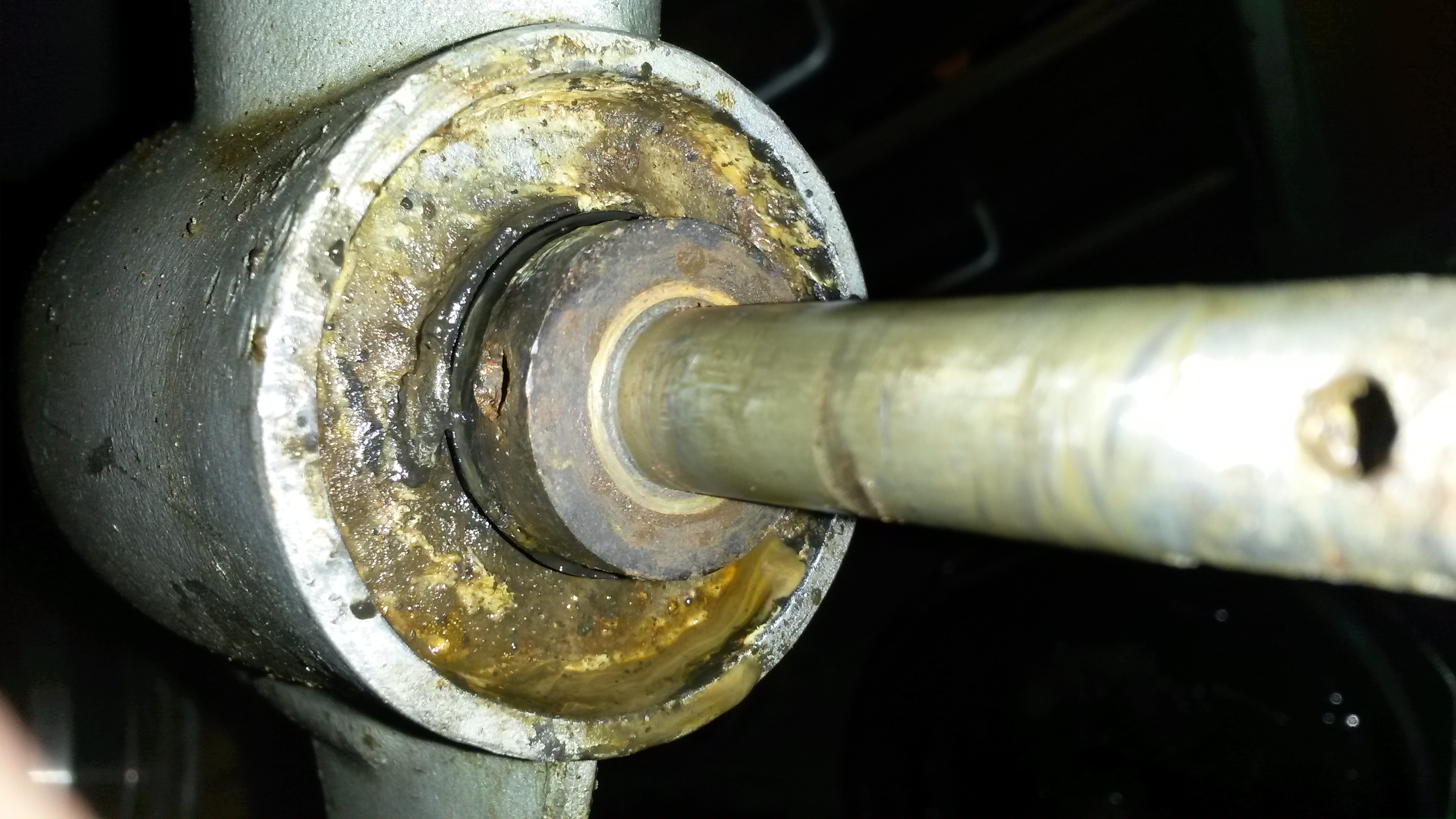

Well if I push the prop and turn it, it can actually miss the cogs and turn freely if that makes sense?
When I had it open the rubber washer looked a bit past it, should they be fairly thick? I'm thinking if it was thicker it would hold the gears better.
Also this is a 89 fort featherweight, would it be a sealed box? Should I not have taken it apart?

There shouldn't be that much play on the prop shaft in/out. This amount of play (backlash) is taken up by a thickness washer ( in some cases one thicker one and one thinner one together) right behind the main gear and in between the end cap bushing. While the prop is submerged and providing thrust, the direction of the shaft moves slightly forward and the full force is resting against that little washer. If this little washer is missing/badly worn, it might explain why the gears disengage while under load!
The rubber grit seal you mentioned is normally a bit thicker than what you have and will help to keep the oil where it needs to be for a bit longer, and also help to firm things up a tad.

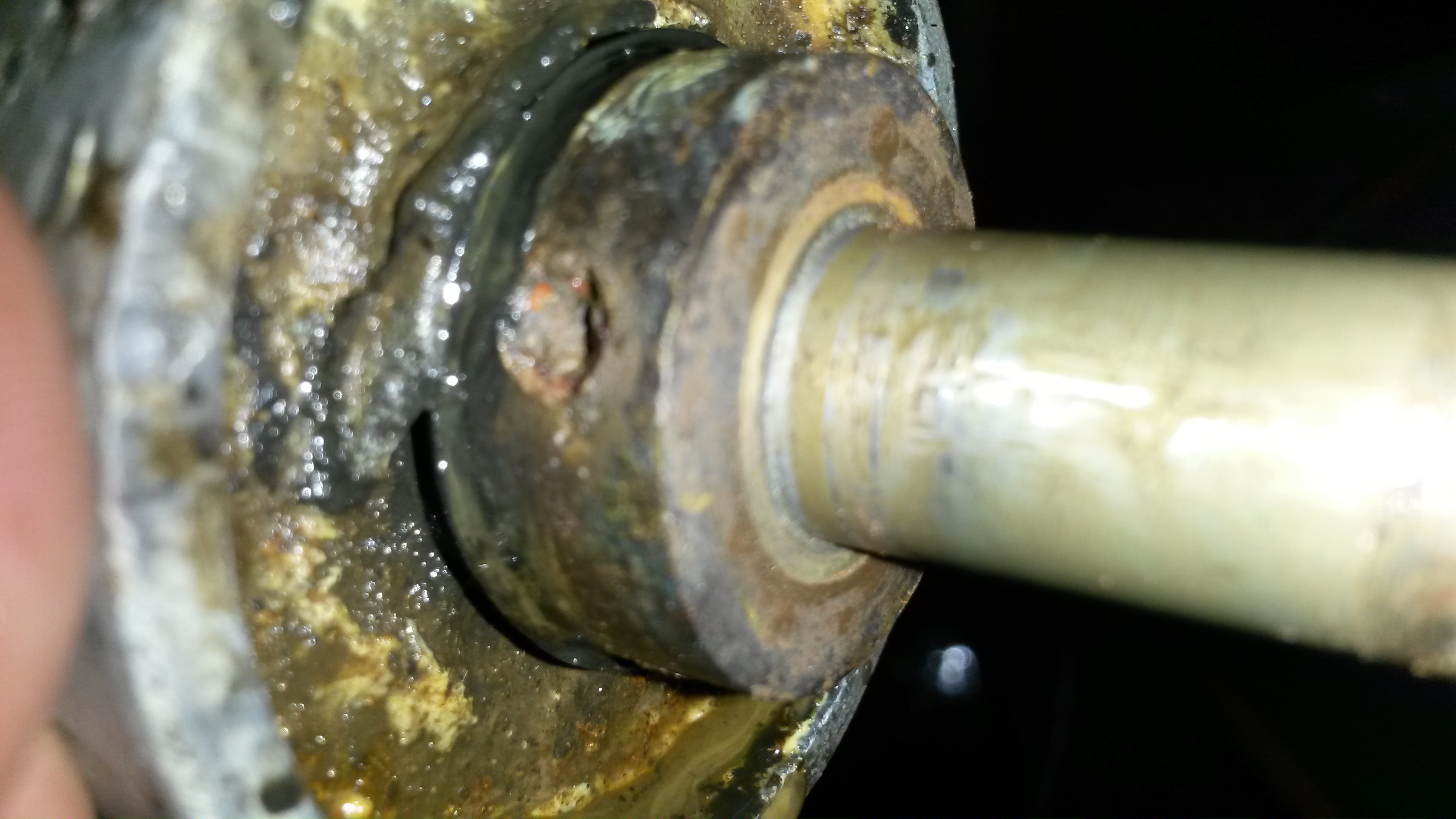

I've never had It on a boat, its new to me.
Well the rubber one seems very thin and worn, if I can get the bush off and the shaft out could I pack it with any old grommets to hold It back?
To remove the bush is there just a pin through it that needs punching out?

The same as the shaft I would Imagine, see what end float you have to see if that's the problem and add a washer, stainless one maybe.
Re: Draining the mayo out the gearbox
That is a pin through that bush isn't it? Not a grub screw?
