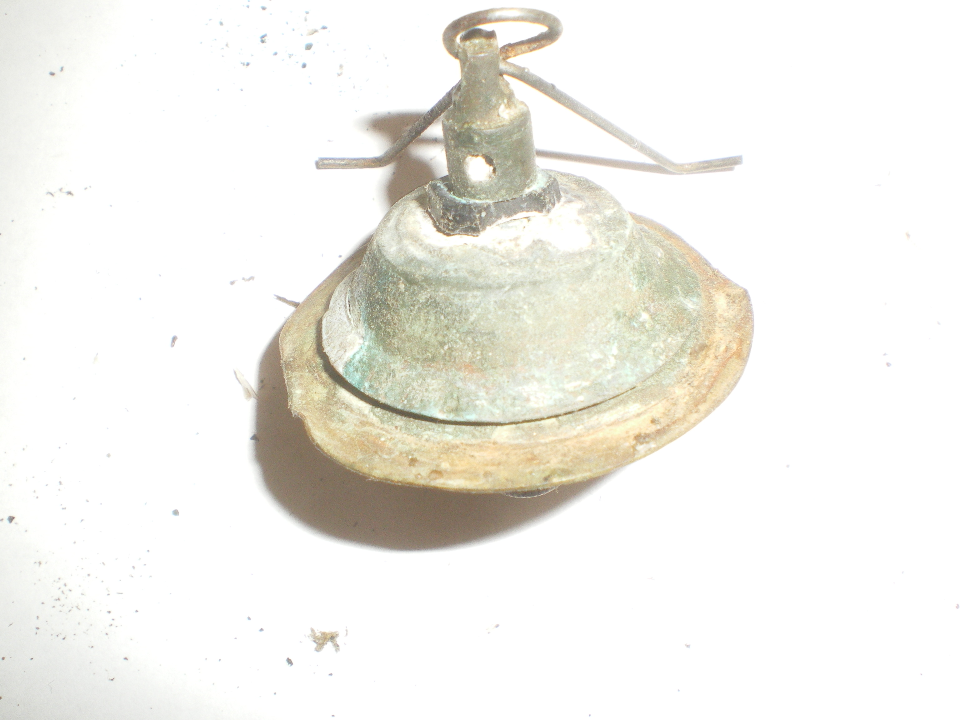

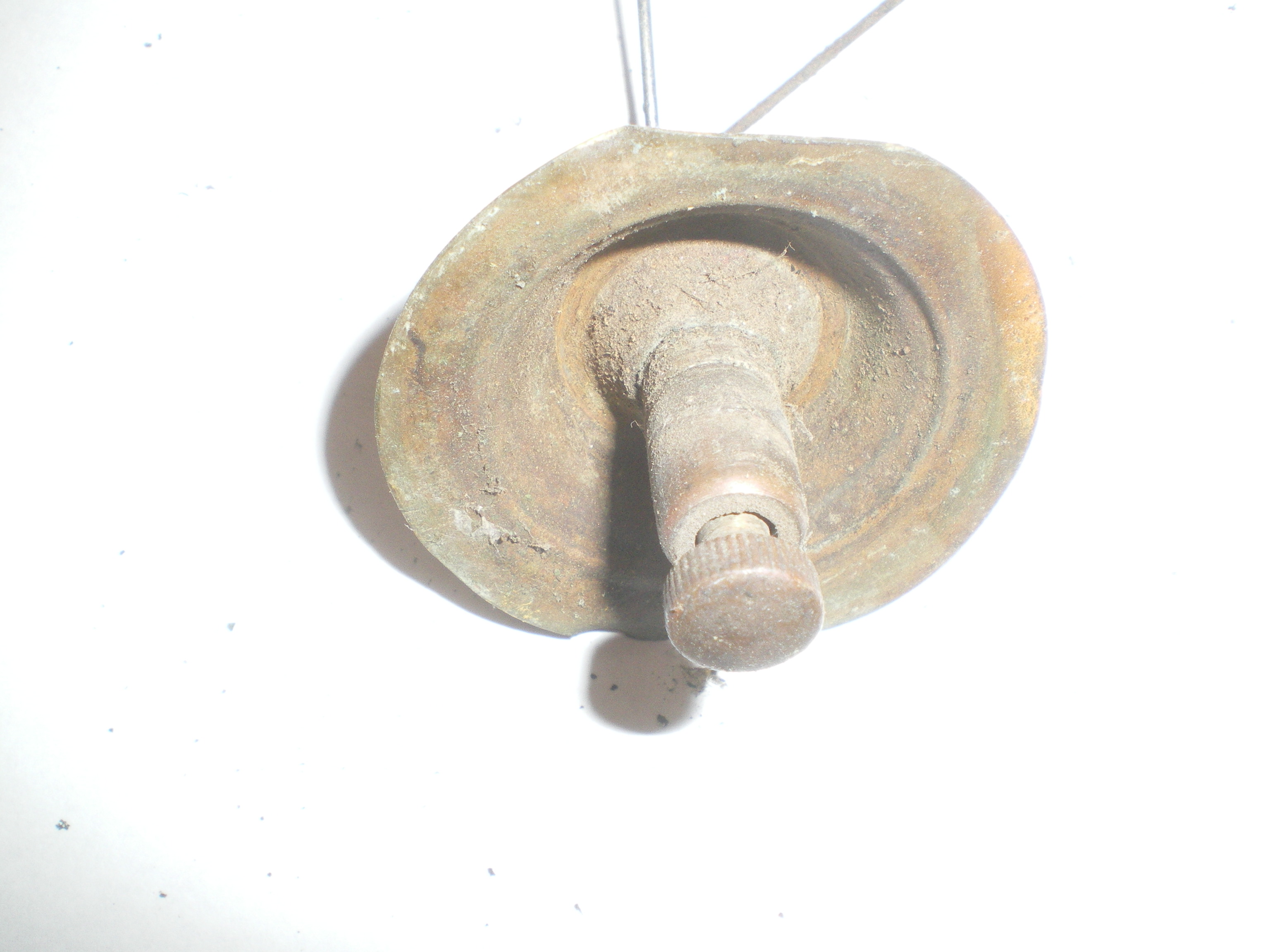

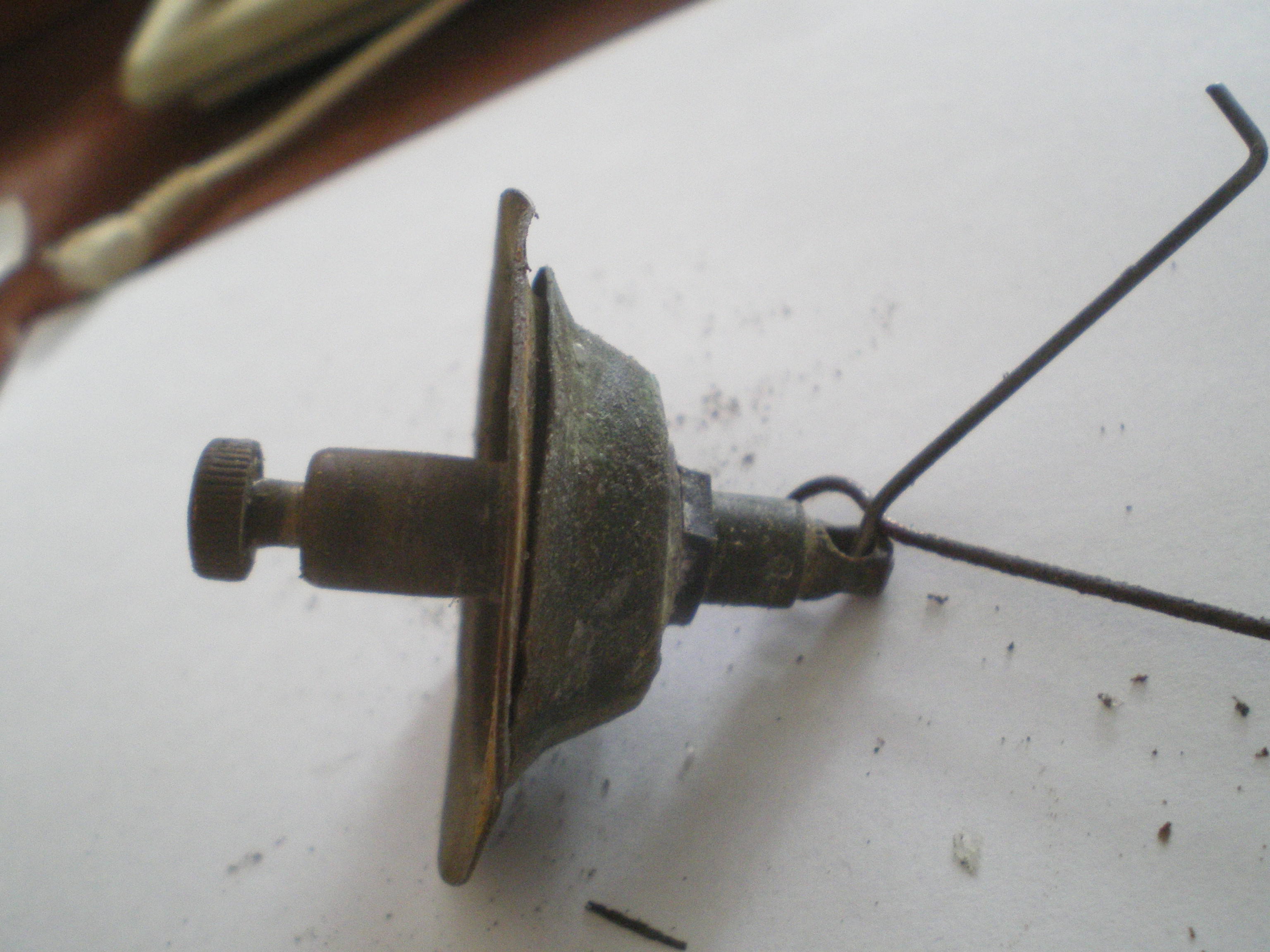

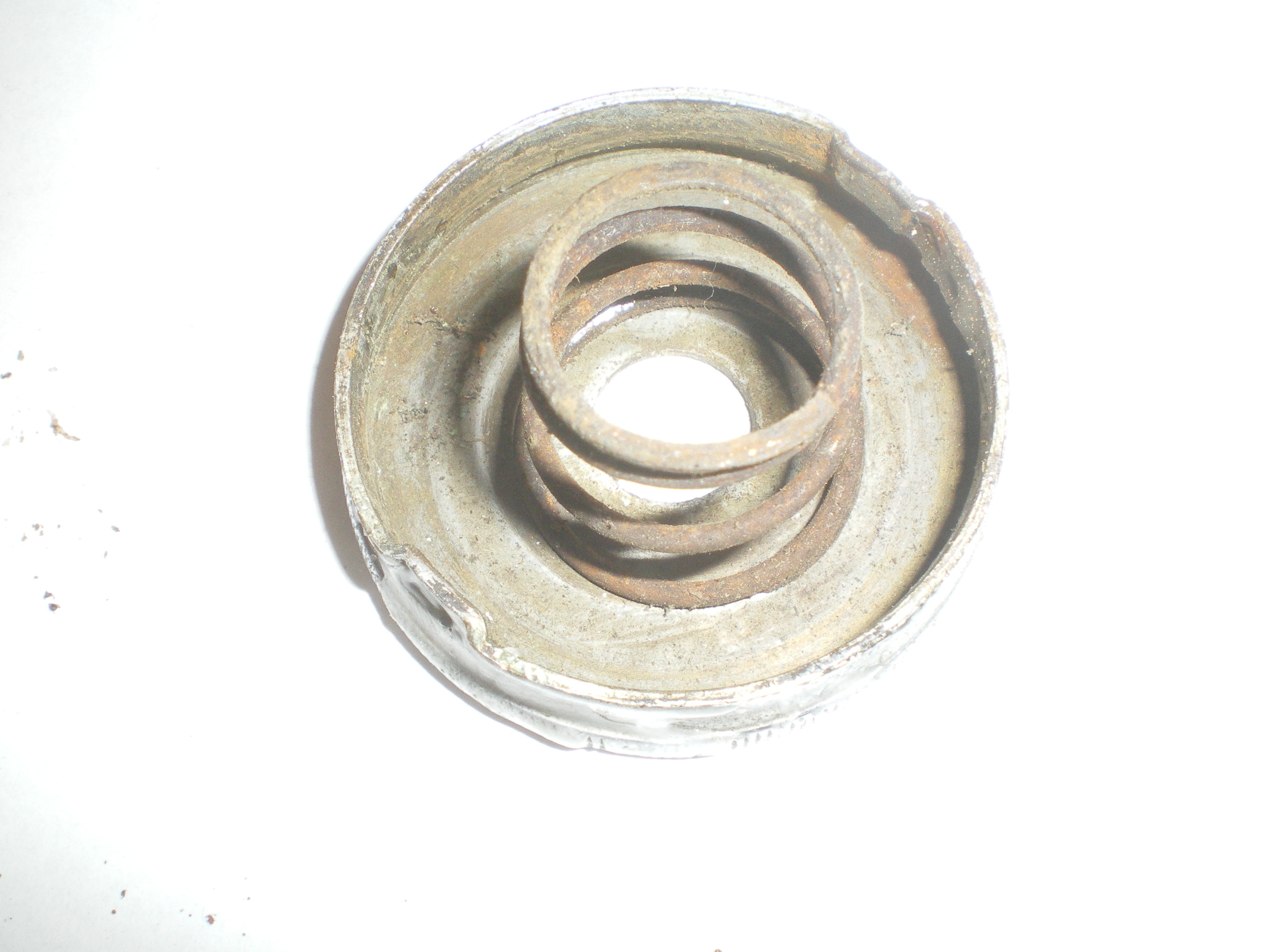

Does anyone have some photo's of the stripped down fuel cap ,that they can post!
I would like to try and remanufacture it ,if I can . If not I will get a price from an engineer ,so a few can be made .
Dave
Dave

When I get a chance Ill strip one down, and as Charles suggested, make a drawing . From the interest there could be a number required, at least 20 by this string alone. But lets not get ahead of ourselves. price will defiantly come in to this.

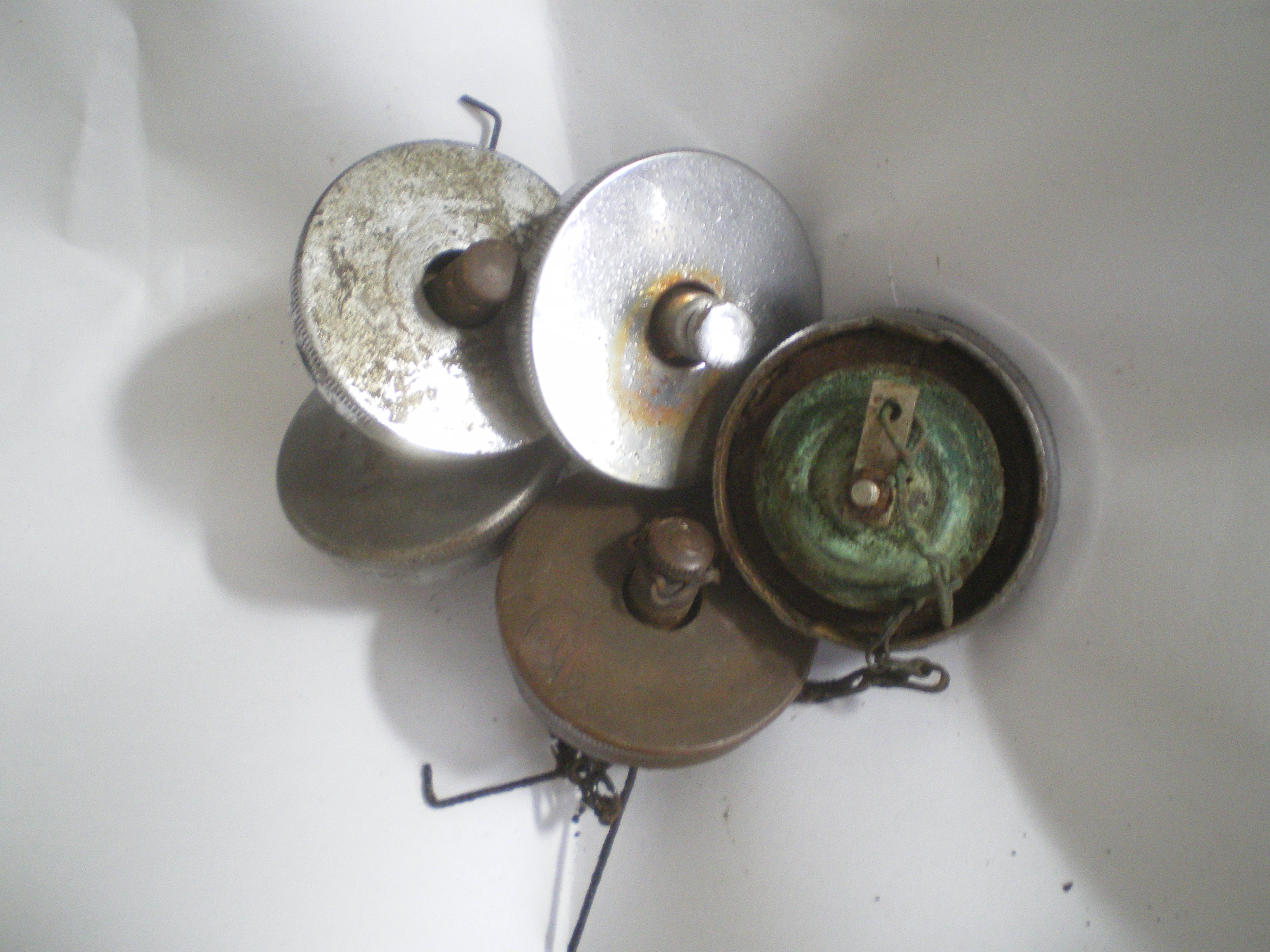

Hadn't realised we can drag photos in now....
Brass ones seem to be a tad rare
