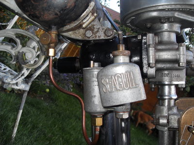

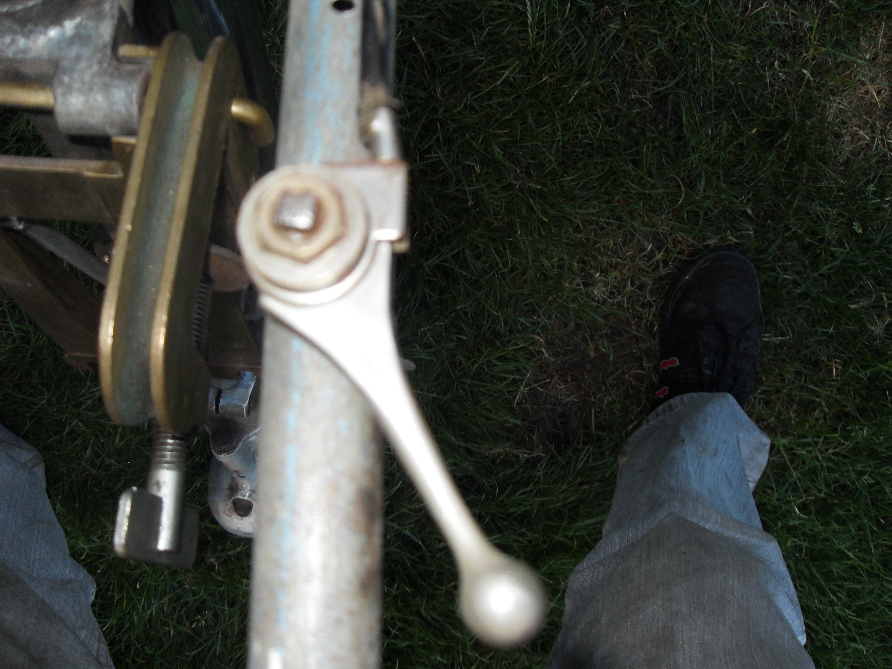

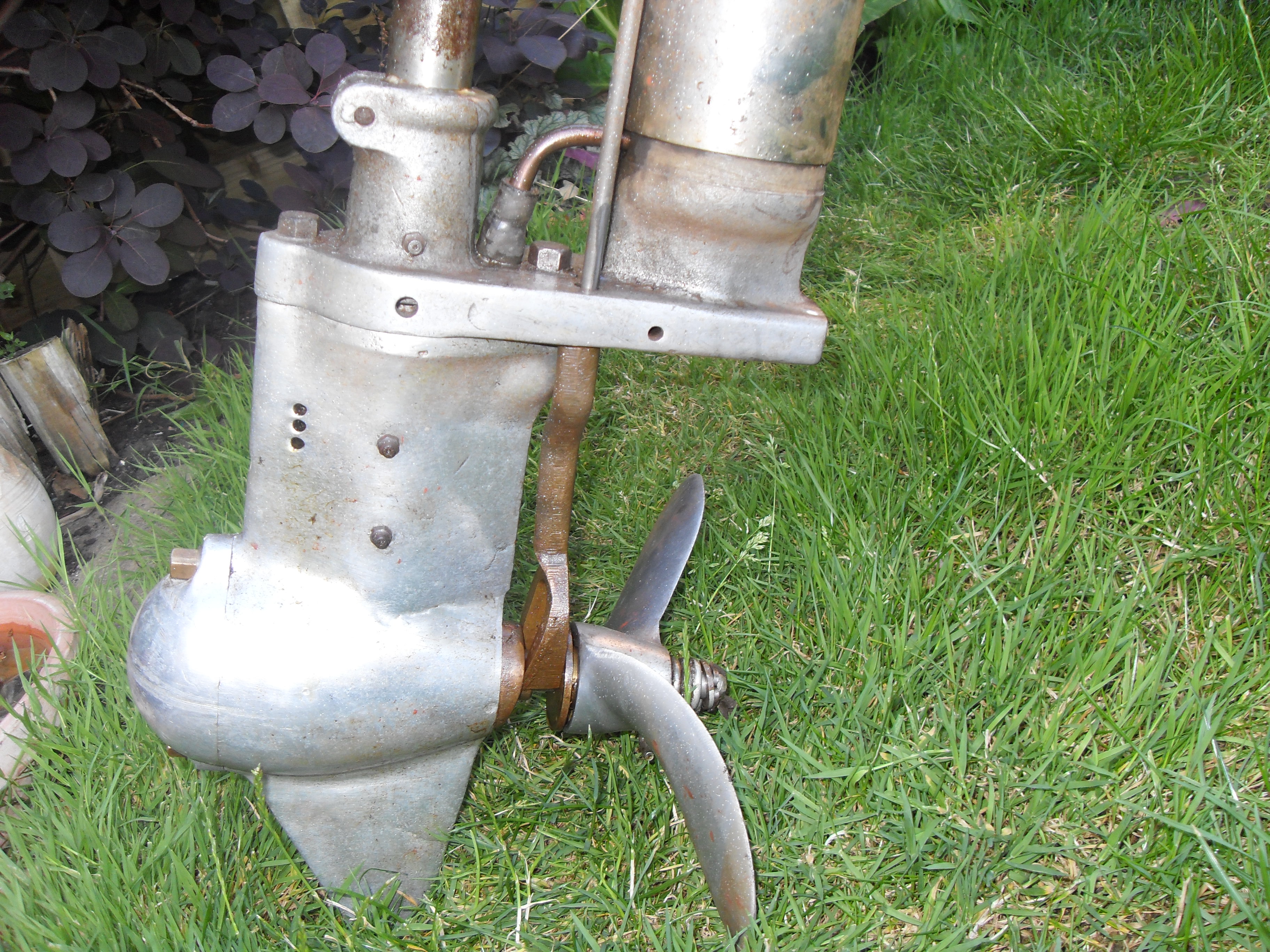

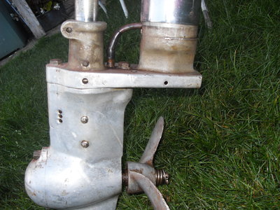

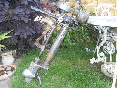

Right, here we go then.
This was a "You Tube" star (and probably still is if you look at Nianders website you'll see it on there)
Serial number SDP 11449.
First things first, this is and has been a work in progress over the last 2 1/2 years and apart from a few "corrections" made by me i reckon it's not that far off being more or less correct. (there's still a couple of things i need to look out for yet before i'm happy with it)
Hopefully Mr.Oyster will jump in with some comments as well.
For those of you that dont know (or perhaps might have forgotten) i am also collecting data on SD and SDP motors.
I'm attempting to carry on from where Oyster left things. (i have made some progress but not much)
Take a look at the pics below
enjoy...

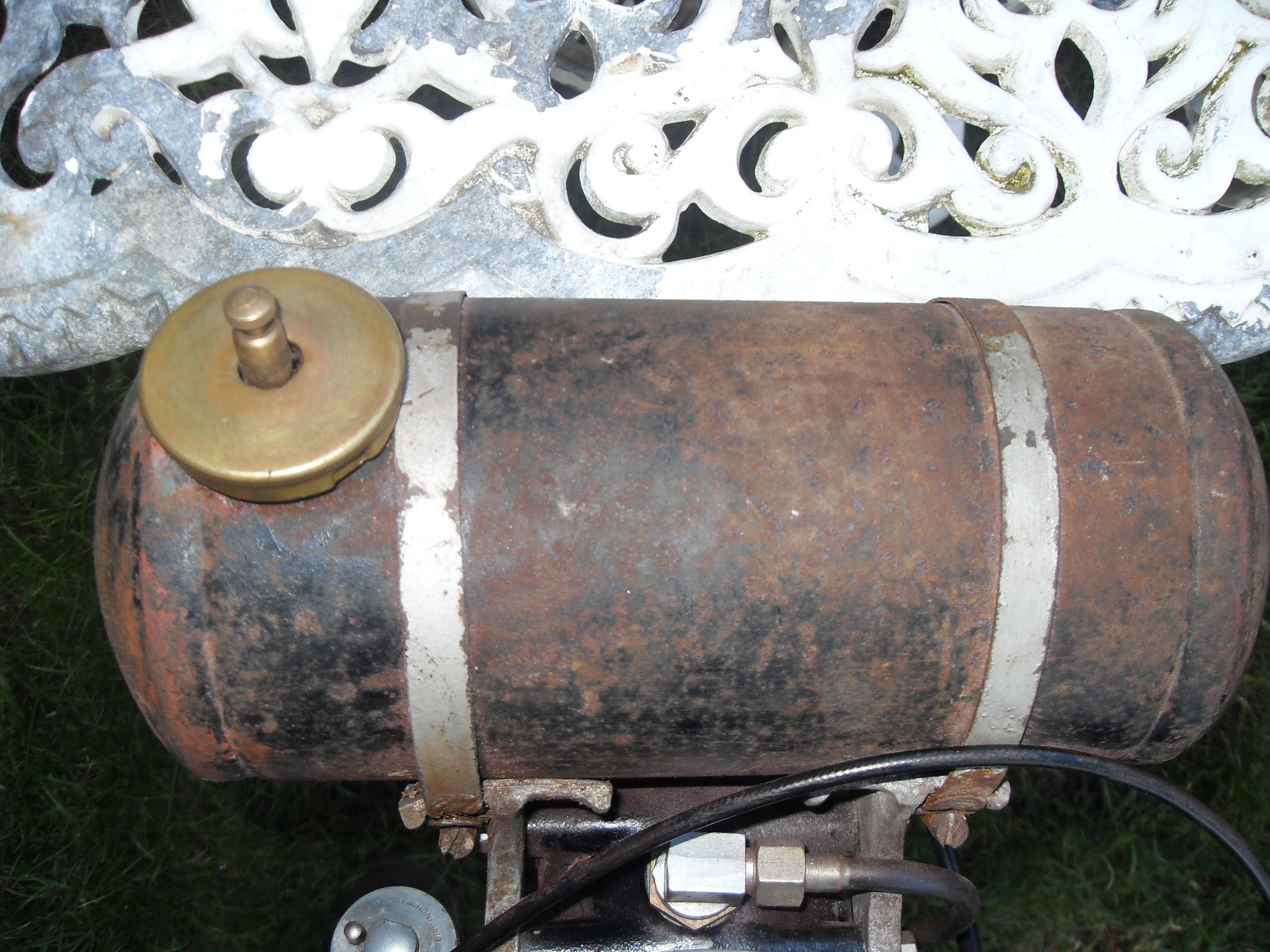

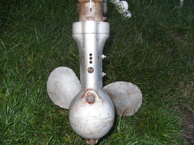

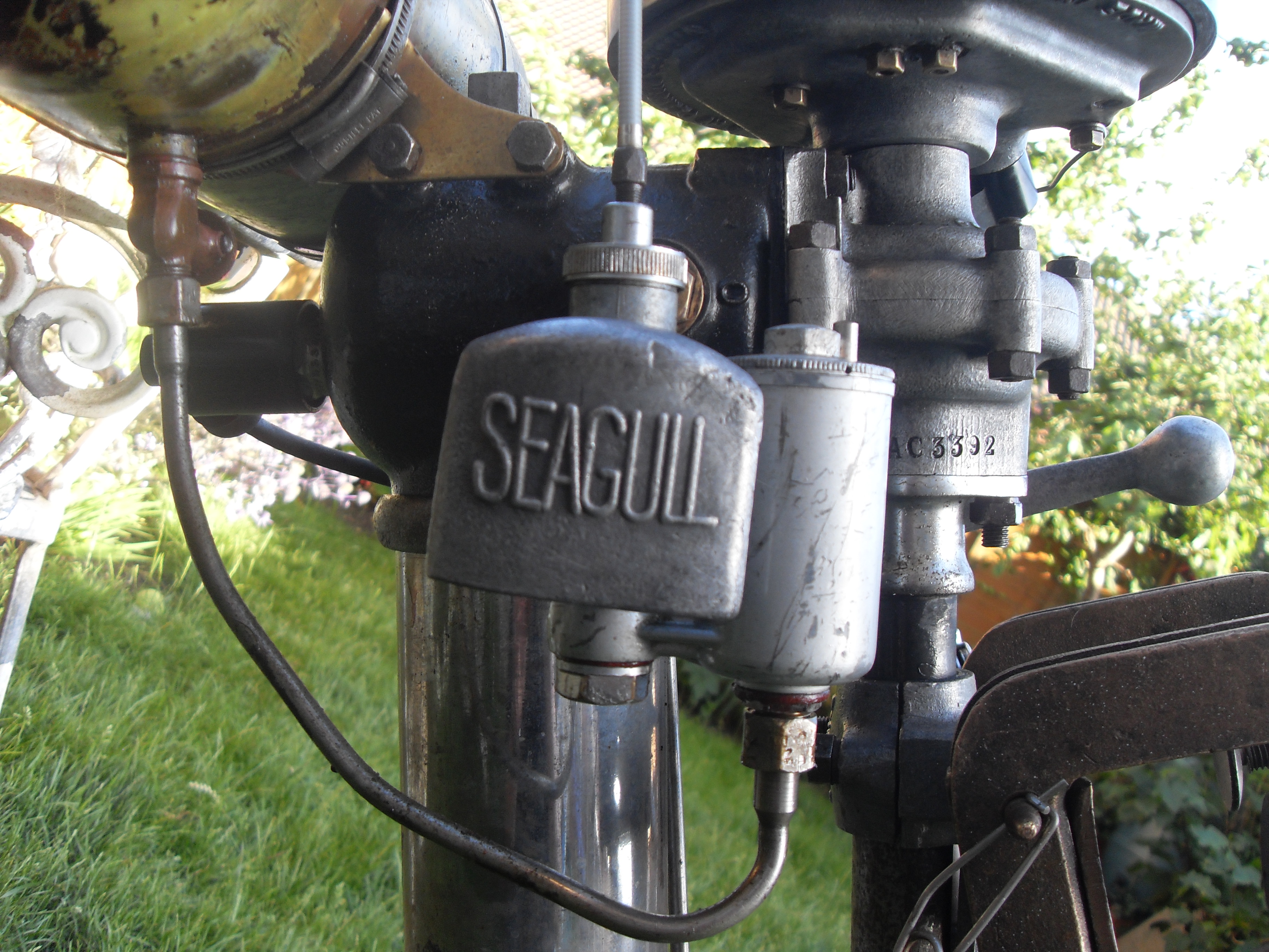

Re: 102 SD Skeletal bracket wanted
a few more

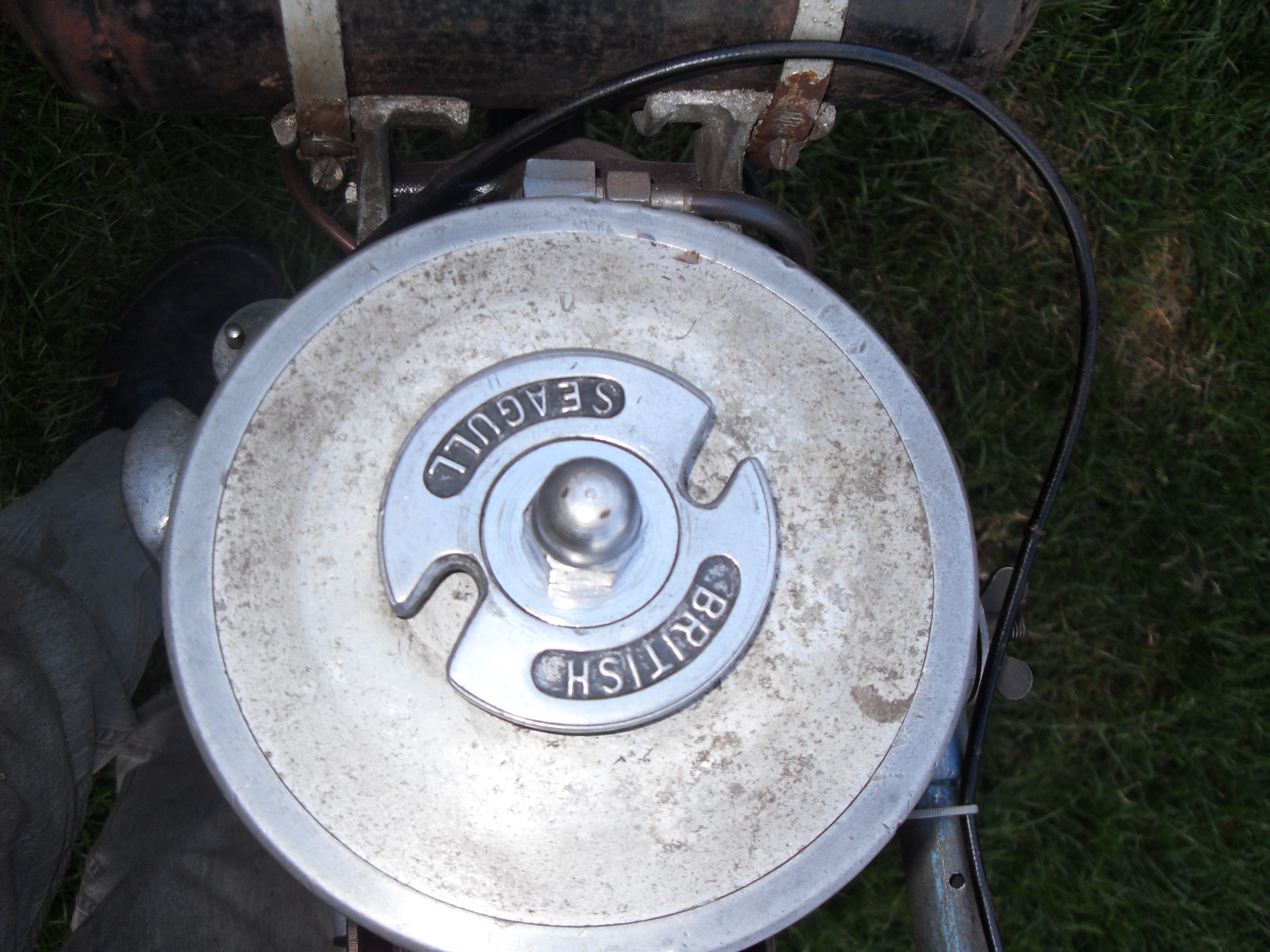

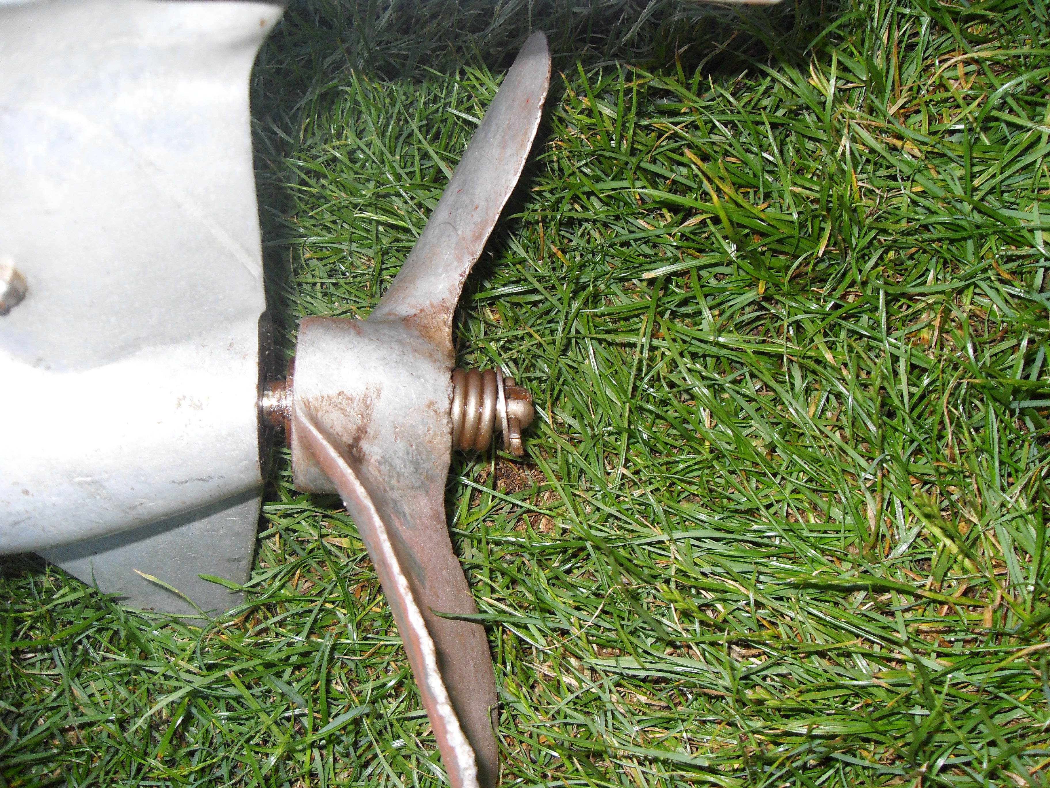

and a few more

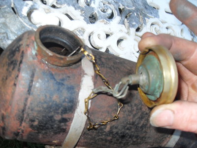

The Marston Registry has the correct size brass chain in 6 inch lengths & the 2 brass "key rings" that fasten the chain to the tank split pin & the fuel cap, this was purchased for register members who wished to use all the correct components for their restorations.
There is still a few spare sets left, if any of you SD restorers want a set they cost £2.00 + P&P.
Email me.

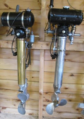

An SD and OJ. The SD has the copper cap the OJ is aluminium. The SD has a much more brass including the Carb (all except float bowl)
The OJ needs a fuel cap and dove grip; the SD needs a throttle leaver that should be the same as the one shown on the OJ.

Wow , Those motors are stunning !  I noticed the carb float bowl housings are on different sides to each other ! Is there a right / correct way on which side to put them , as I did read somewhere that they should be on the side furthest from the fuel tank! If i position my float bowl further from the tank, the Amal writing on the housing will be behind ,and out of view !
Good question Dave.
The float bowl position is largely dictated by which fuel line is fitted. As we've been talking about after many many years of service, things break!
Fuel lines can fracture etc. and get swapped with a later variant leading to lots of confusion when trying to restore a motor such as these back to their "original" condition. Early ones were copper (sometimes plated with either a zinc plating or similar) or even chromed as with some of the Marstons.
But most SD's and SDP'S would appear to have a copper line to keep them looking right.
Anything made from plastic or rubber that might be fitted to a "wartime" 102 will almost certainly have been fitted well after the initial build date.
(what i term as "running repairs)
There's plenty of pics on the main site of SD's and earlier Marstons. Take a quick peek and you'll see some of the key differences.
But.... the position of the bowl for most if not all pre 1945/6 motors (still trying to firm things up with my data) would be dictated by the fuel line currently fitted. Most seem to be on the left (look closely at a 46n float bowl to see the manufacurers lettering clearly on display) whereas in later years BS recommended the bowl be positioned on the other side to prevent "gassing" (flooding) when the motor is turned off.
SO, depending on how "accurate" you are wanting to be with things, the purists among us would say to the left.
You've already seen pics of my SDP, but take a look at this below,something different again (but i reckon it's probably correct for its age)
I can't quite bring myself around to tidy it up yet, i like it as it is..... honest looking

Has anyone actually pointed out just a new authentic petrol cap won't work with a screw threaded tank?
