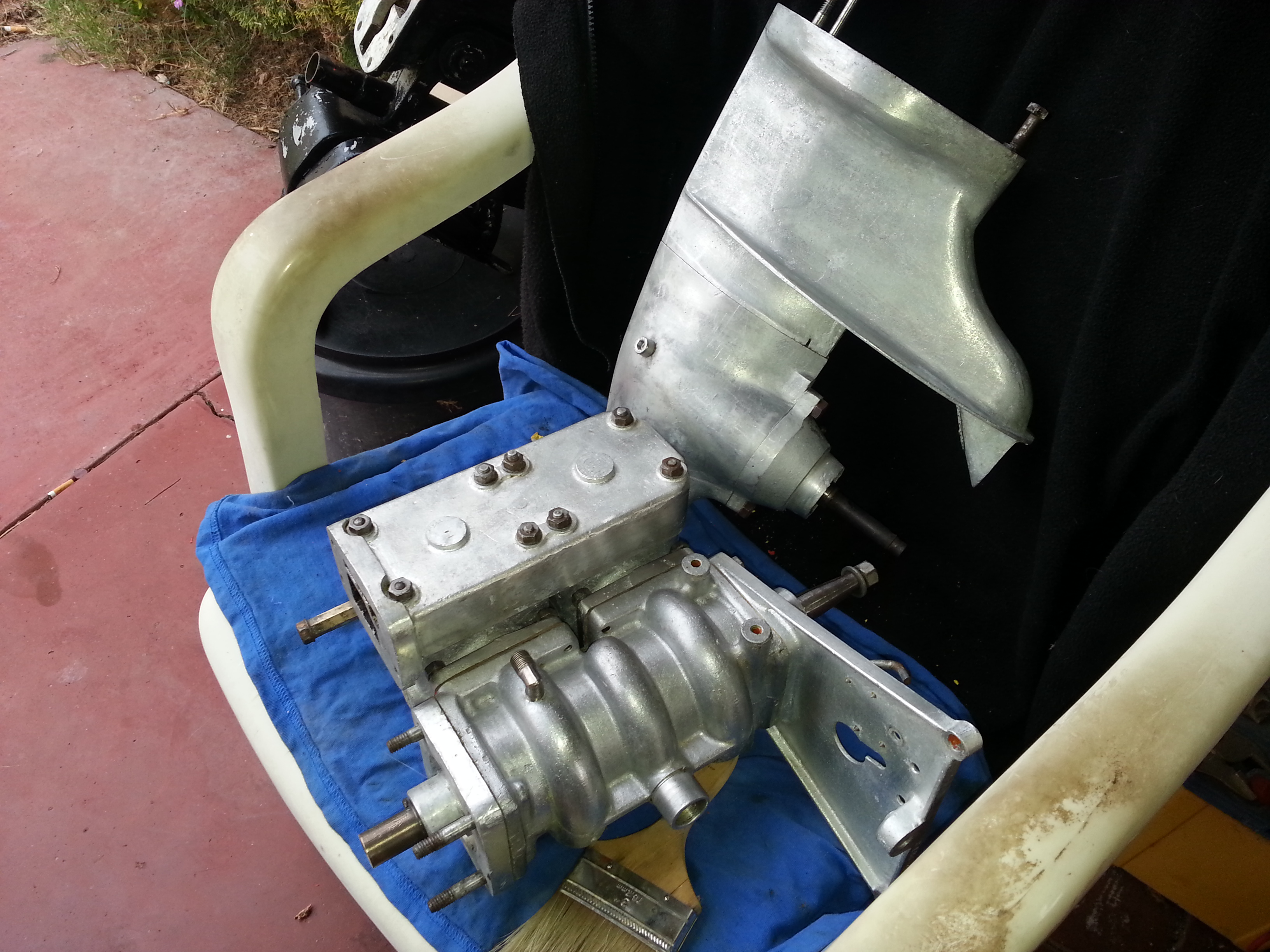

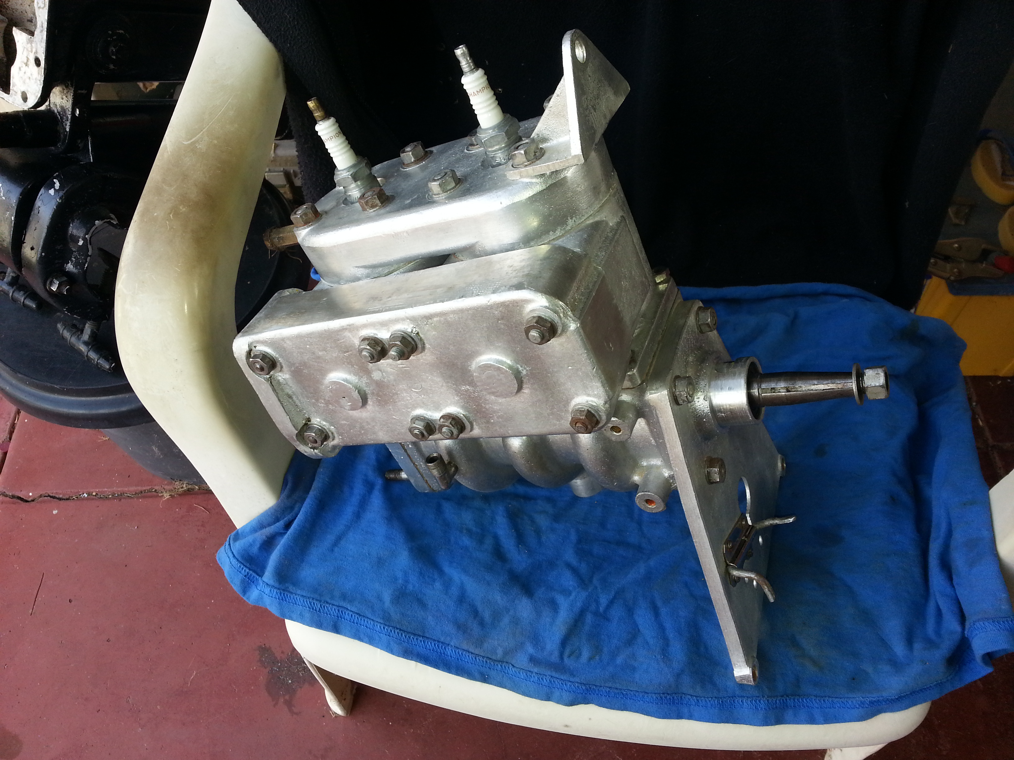

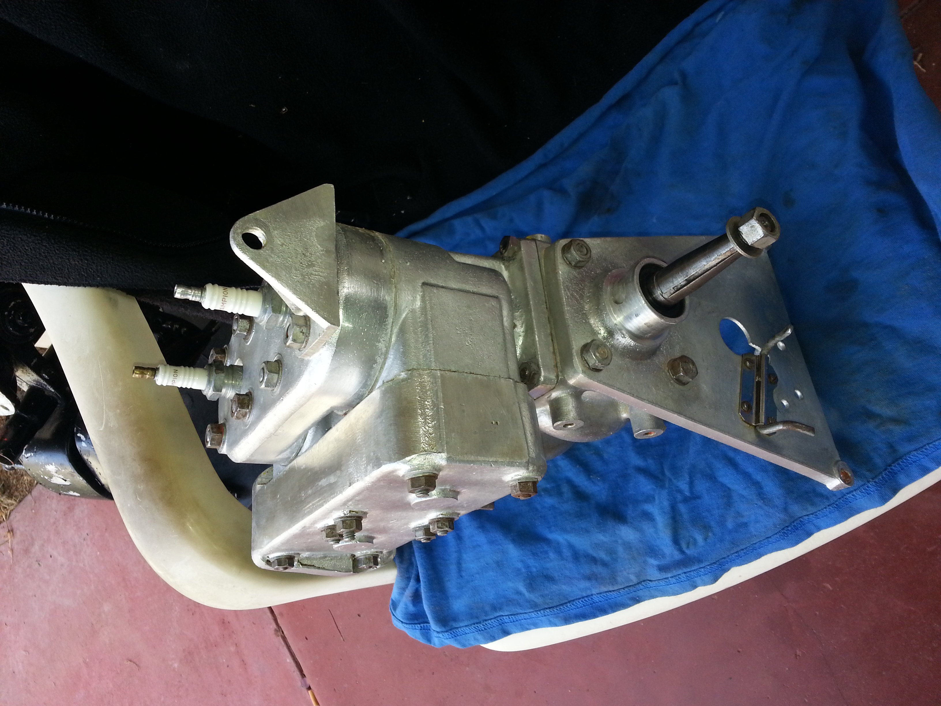

Progressing a little slower than expected, but coming along none the less.
Focus of the last week has been to remove the old paint, and in the main we've succeeded in doing that. Following are a few pics of the main components. Still some paint difficult areas to be removed, as well as remains of gaskets etc etc.
Engine. Due to difficulties experienced with the gaskets (separation of parts and gasket removal an absolute pain in the butt), I've decided to leave the engine intact. It turns over nicely and makes no strange noises, so I'm reasonably confident the decision to not separate is best under the circumstances.
Upper and lower cowls. Darker spots are where corrosion had set in under the paint, and will require some further treatment.
Trunk - Drive/exhaust tube.
Gearbox
Transom bracket assembly. Having a hard time separating the parts but hope to have that sorted on the next day or so.

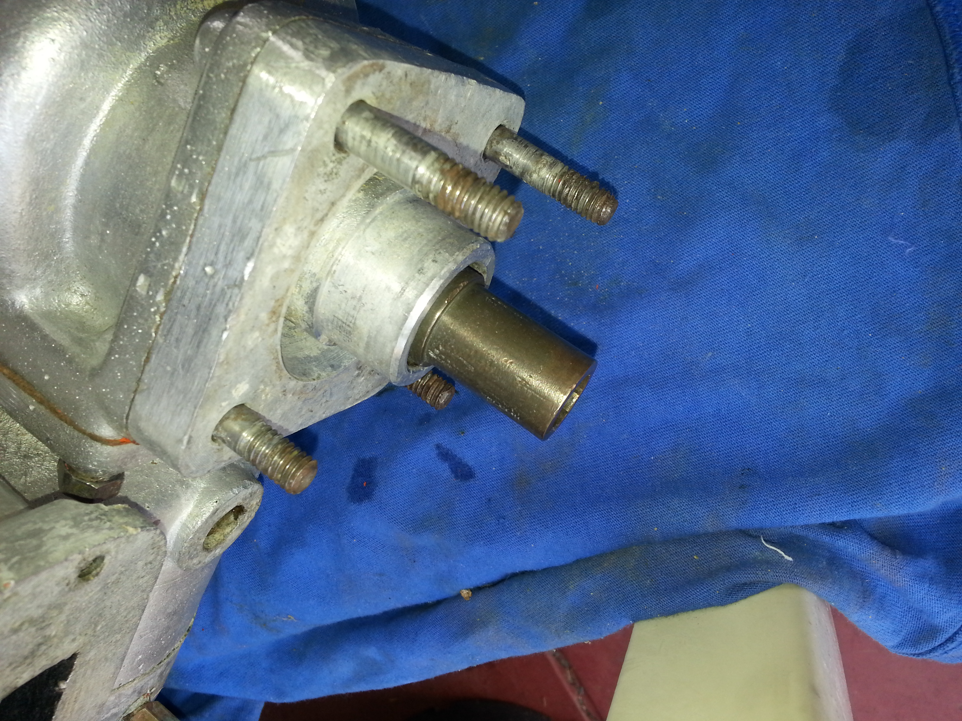

Not sure which way to head with the water pump at the moment. It's frozen solid inside the gearbox housing and simply won't budge. This outboard will probably not see water after it's done, so if I cant find an easy way to free it up, it'll just stay there. Nice bronze housing!
Some may recall I previously mentioned the recoil starter was inoperative. The issue with that is now clear and I'll be able to sort without too much difficulty.
Gearbox

Re: Australian Riptide Sportsman
G'day Stelios, I hope life has been treating you well.
Decided a day of light duties was in order. Started the day by taking a bunch of measurements for Bruce, and hope that some of those may give some clues as to the increased hp of his Sportsman.
Spend a good part of the day on the wire wheel removing rust from all the hardware and linkages. Taps run through all the nuts and dies over all the bolts and shift linkages to ensure an easy re-assembly ie when the time comes. All nuts, bolts, washers, screws etc now soaking in a jar of WD40 waiting to be used again.
Spent a bit of time straightening the tilt bolt and correcting the threads and am more than happy with the outcome there.
I then moved on to cleaning up some of the remaining parts including the recoils starter. This basically sits in the underside of the upper cowl with a backing plate between the two. The backing plate has 2 small pieces of folded metal. The one off the center hole holds the backing plate in to position again the cowl (this piece had previously broken away) and the other (folded at 180 degrees) secures the recoil spring. With the backing plate free to spin, there is no recoil affect, hence I need to do a small repair here to make things function correctly again.
Finished off the day with removing the emulsified oil from the prop shaft housing and main bearing.
Hope to pick up same manifold gasket material during the week, as this is what was used between the engine and lower cowl and again between the lower cowl and drive/exhaust tube.
Next week is Greek Easter so it will be full on with family gatherings etc. If I find some spare time, I'll clean up the ignition system and make a start on the stainless mid-cowl.
Then it's primer, topcoat and reassembly with some time in between of course.
