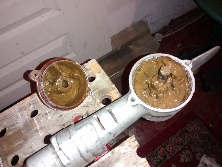

OK some pictures as I take it apart. First off lots of gearbox sludge:
Gearbox Sludge
Gearbox Sludge

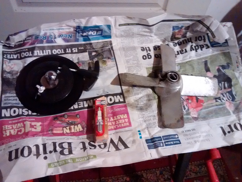

And some parts that have arrived. replacement prop, spring, pull starter with dome nut, and D16 spark plug.

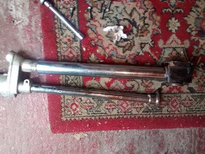

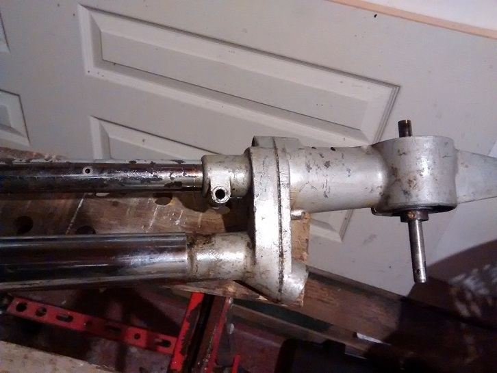

I have heated a small protrusion in the gearbox housing that I assume contains the end of the countersunk screw inbetween the chrome poles. No luck yet. I have also heated the clamp part after removing the bolt. Should the lower half come free now, or do I need to undo the countersunk screw first?
Frozen screw
Frozen screw

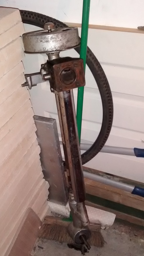

For now I have sprayed more release oil on the screw and the clamp part of the casting, and left it upright to hopefully soak downwards:
Stored

Re: Crank appears to be seized on a forty plus model??
Apply some heat to the area the screw locates and then fit the biggest screwdriver that will fit in the slot. Give the screwdriver a wack or three downwards and then use a spanner on the screwdriver (Square section screwdriver) to gently apply torque to try and unwind the screw. Take your time and keep applying plenty of heat.
Replace with allen screws! Good luck. :P
I use an impact driver with a flat head scrwdriver bit after heating the gearbox casing. Usually works quite well, but there's always one that refuses to budge isn't there. :roll:
Heat and soak with some penetrating fluid and with a bit of luck the fluid will get drawn into the threads over time and help to release things to get them moving.
Allen screws are of course an option as a replacement (i prefer the original screws)
The contents of the gearbox looks fairly normal, sort of coffee coloured sludge is about right for oil that has emulsified over many hours use. BS reccomended every 10 hours or so between oil changes but these little engines are quite forgiving really. Just clean all the goo out and check for wear on the gears (fingers crossed it should be ok).
The villiers carbs are 1/2" and really very simple to work on (and there's loads of them about)
As for seperating the gearbox from the pumphousing it all relies on those 2 screws. The torque tube can be a challenge to remove from the pumphousing. I made a tool from some old dexion racking, the holes were quite conveniently placed apart to attach it to the top of the torque tube (where it would normally attach to the bottom of the crankcase) with 2 bolts. Apply some heat to the pumphousing and give it a twist backwards and forwards and eventually it should come out. (at this point you might want to place the pumphousing/torque tube in a vice but protect the aluminium casting with an old towel or similar) Normally works well for me.
best of luck

I had not realized that impact drivers start at only £10 or so - good enough for the job?
I put more heat on it today but still no movement, even with a socket handle attached to my screwdriver bit. Also my blowtorch keeps randomly cutting out even though it has a new gas cylinder. The end looks a bit rusty, I wonder if this is causing it to cut out.

Well after more fighting with the screw I think I need to get hold of an impact driver, still no movement.

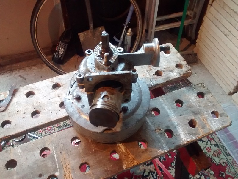

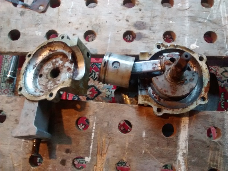

Bit of progress today, I found that with the piston at BDC I was able to pull the cylinder away from the crankcase, allowing me to separate the engine from the leg. Separating the cylinder from the exhaust tube was then easier.
Still no luck with the screw in the gearbox, but as the gears seem to turn ok I do not actually need to remove this to repair the engine. I will however need to remove the flywheel from the bent crankshaft. I have not been able to do this yet.
I found that I needed to heat the lower bearing to remove the bottom crankcase half.
My replacement crankshaft comes with a "SEAGULL 2" conrod, the one inside is a "SEAGULL 1". Is one preferred over the other?
crank case halves
crank case halves
lower half
lower half
