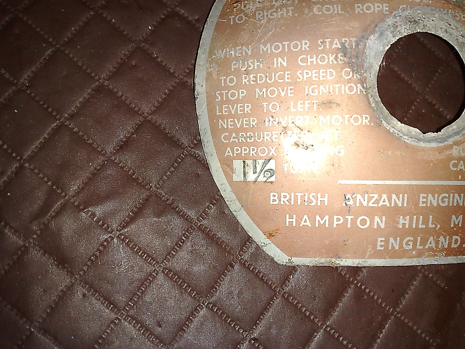

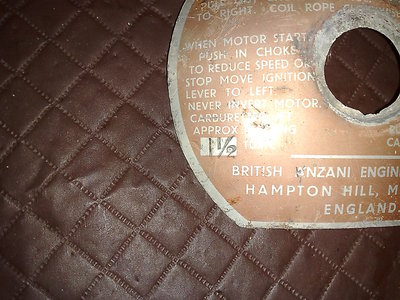

The black tank label has no numbers on it or anything about being MK1 or 2. The only number I could find is on the crank case

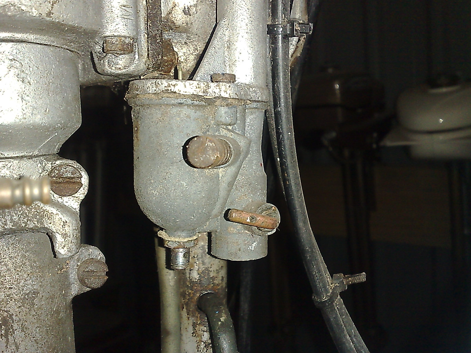

This was the carb that was bodged to the engine (I'm sure it would't have a home made looking bit of copper pipe between the carb and the intake)
It could be that the owner before me wanted to be able to control the speed of the engine better so changed to the newer carb?

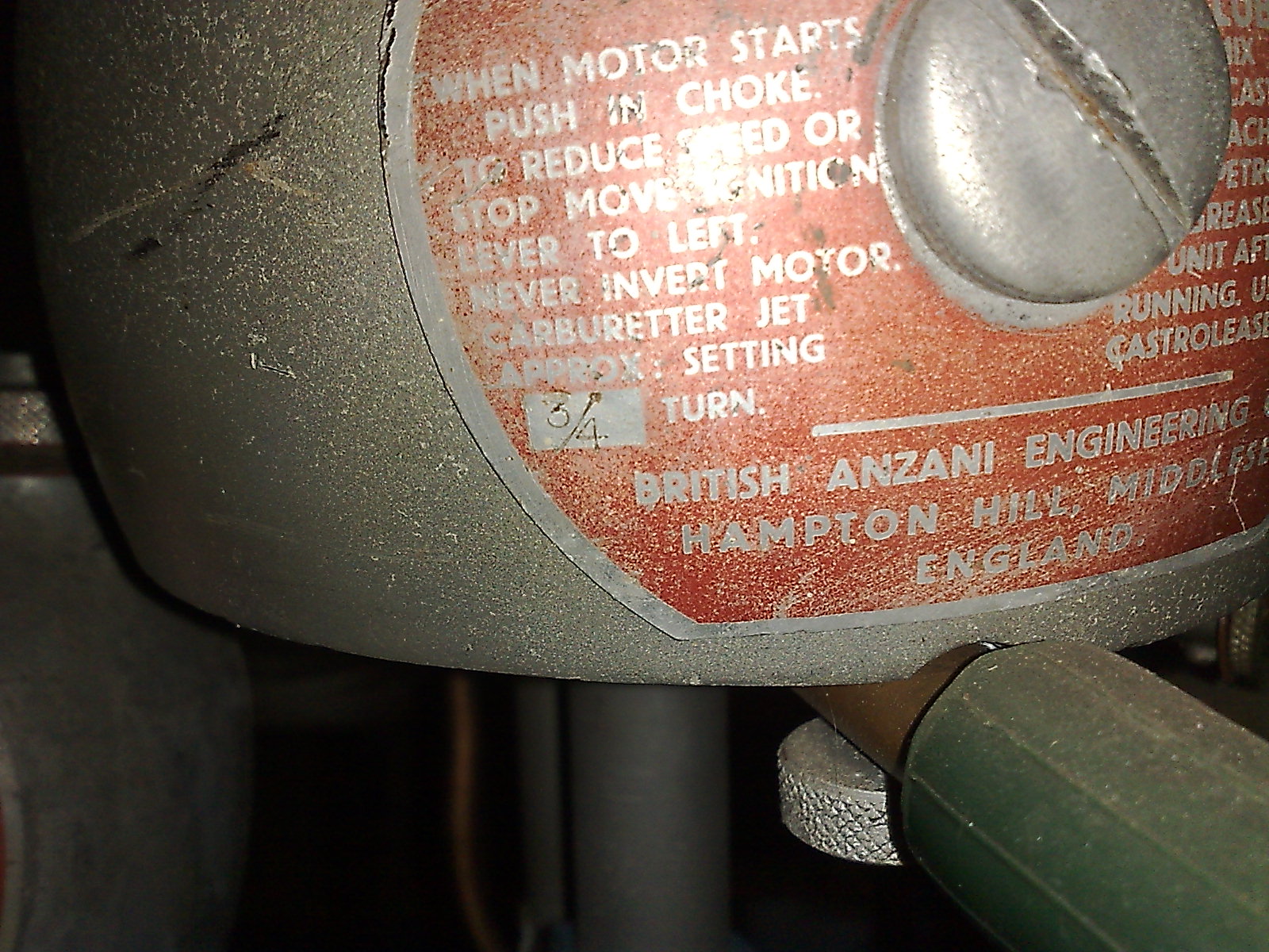

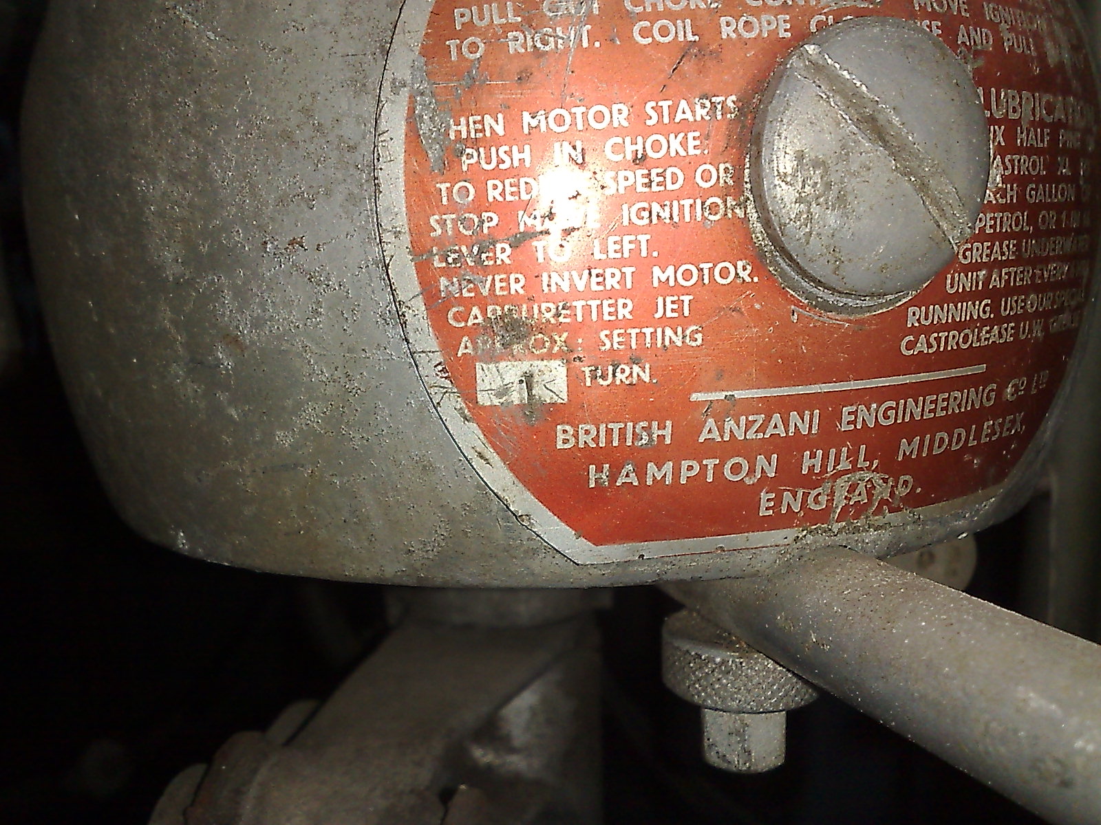

Minor #M202 Black
Minor MKII #M1405 Red
Minor MKII #M3640 Red
Minor MKII #M3942 Red

Looks like your black mk1 is a touch older than mine, it would be interesting to know how many mk1's where made!
Is one of the mk11's showing the carb jet set to 1one turn and the other at 3/4 of a turn? if that is the case it could take a bit of mucking around to get them going if the name plate was swapped!

I am sorry but neither of them had a "Carb"
The "Black" one is an air valve.
The MKII red is a "Mixer"
The Air valve can NOT be duplicated and the mixer...............................you have to find one.
Cheer up however.......................just get yours to run with the carb you have and a fixed static base plate advance.
It will still look the goods with Hat on aye.
The tanks and cowls are completly different fitment between the two. You can not mix and match if lucky enough to have ones in hand to actually try.

Bruce your probably right about the MK 2 being a mixer & not technically a carb as it has no cable operated throttle slide but it does have a cable operated disc choke & a float chamber, does this make a Tillotson or Walborogh pumper without a float chamber, a mixer or a carb?
I'm waiting for the man with the pictures of the cowl less MK 1 to forward me the details so I can illustrate what I understand the MK 1 to be, perhaps I'm completely wrong, it's happened before.
What's your definition of an air valve?

If you saying that the Anzani black labels that you two have, are fitted with air valves not mixers like all the red labels, a picture of a mixer from a later motor, is not going to help this chap much, your going to have to take the cover off yours.
The mixer valve on the red labels looks just like a carb with all the throttle slide bits removed.
