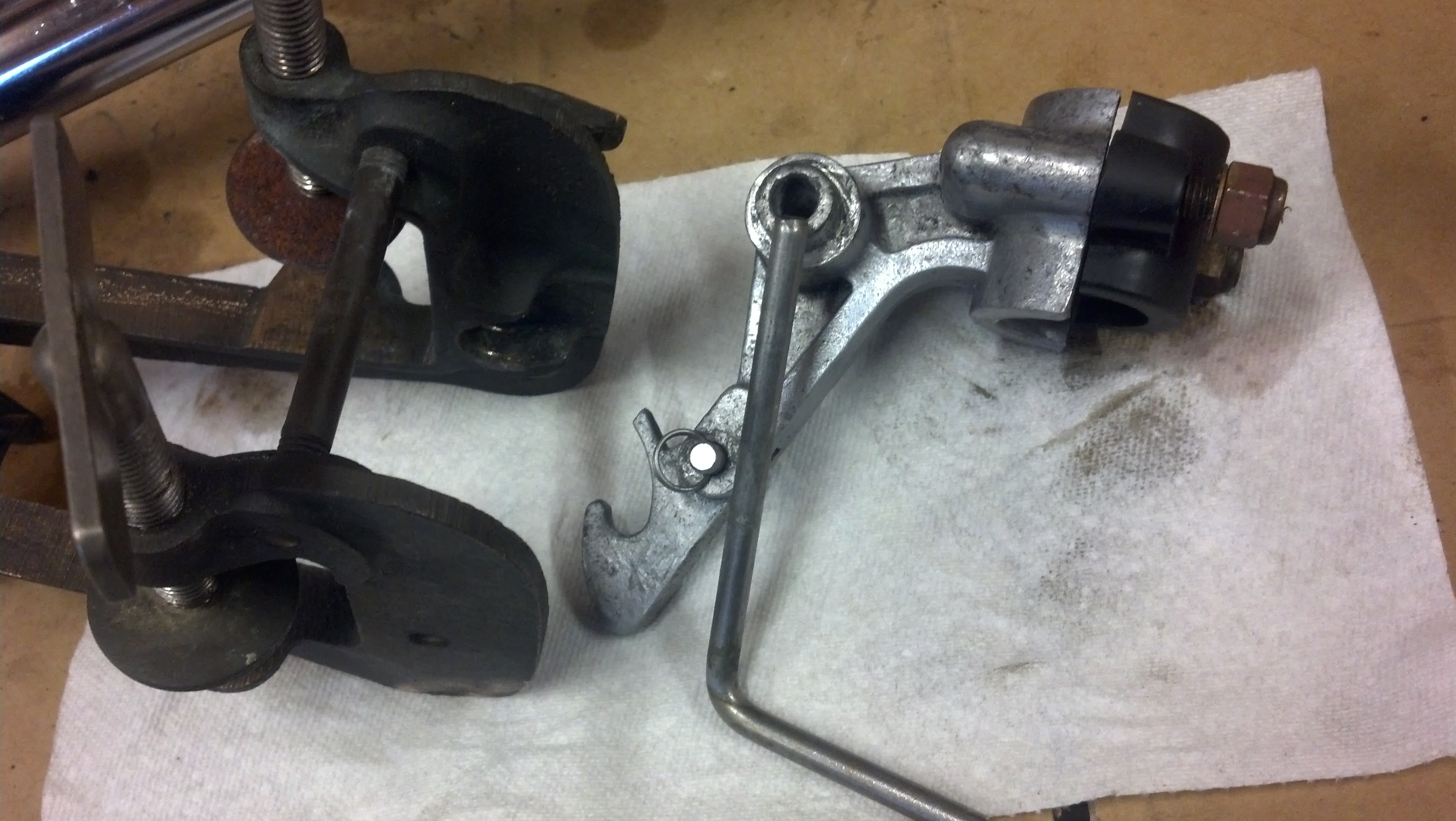

The pin shown is on the other side clamp so..............

.....???????????Collector Inspector wrote:The pin shown is on the other side clamp so..............
shouldn't be easy to take the pin out or turn it?

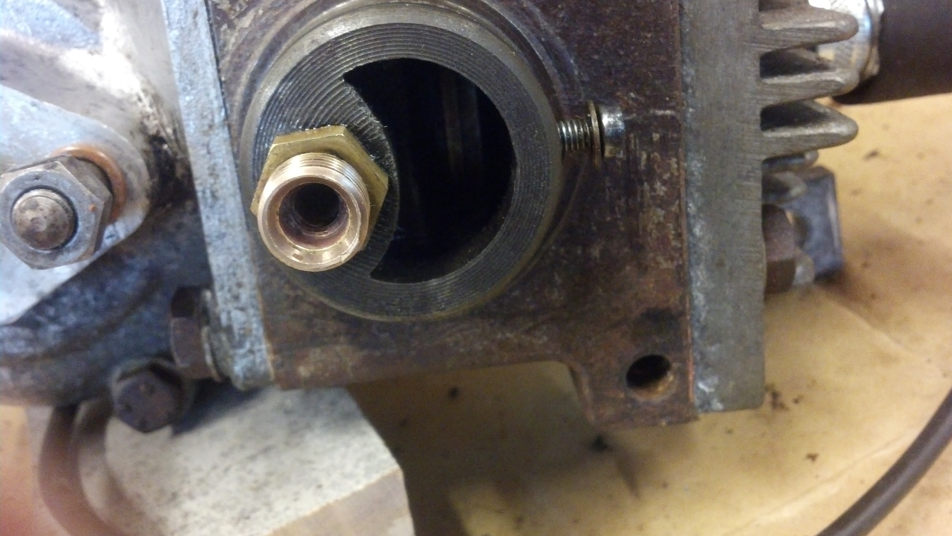

trying to take the gas tank off.... both nuts come off easy, but one bolt is stuck in the hole .....looks like lots of brass "rust" around it.......what to do??
2dogsnight
- Posts: 40
- Joined: Wed Jul 16, 2014 5:00 am
- Location: Pacific Northwest
Re: 79 Forty plus, clutch, long shaft
rust was like a concrete, holding the bolt in place, started picking at it with a narrow metal pin......after getting part of it out, bolt give out and finally had the tank off the motor....

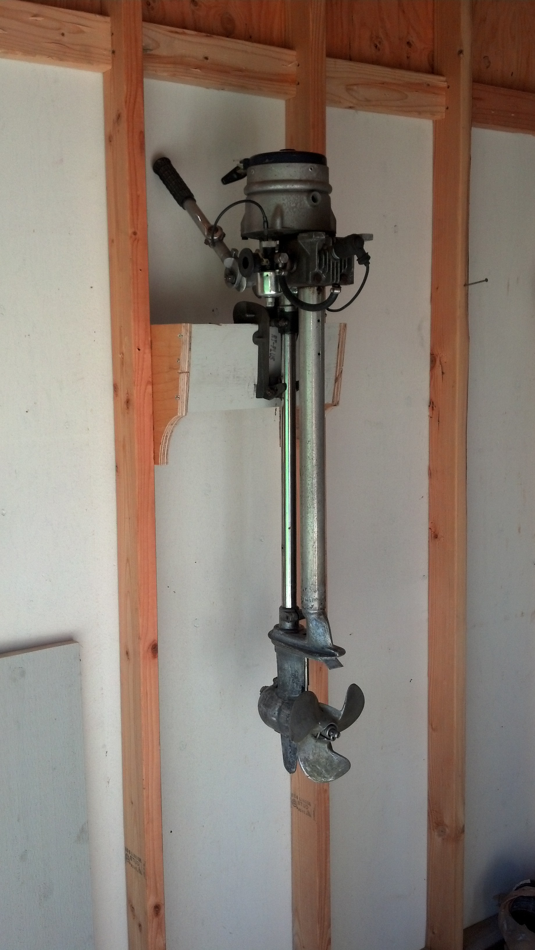

motor on wall stand, no tank
http://images2.snapfish.com/232323232%7 ... B259ot1lsi
.......now need to clean the tank inside from whatever is blocking the fuel from flowing to the carburetor - carburetor was rebuild.

finally got the pin out....lots of corrosion, that's why the pin was not moving much....now is working well.

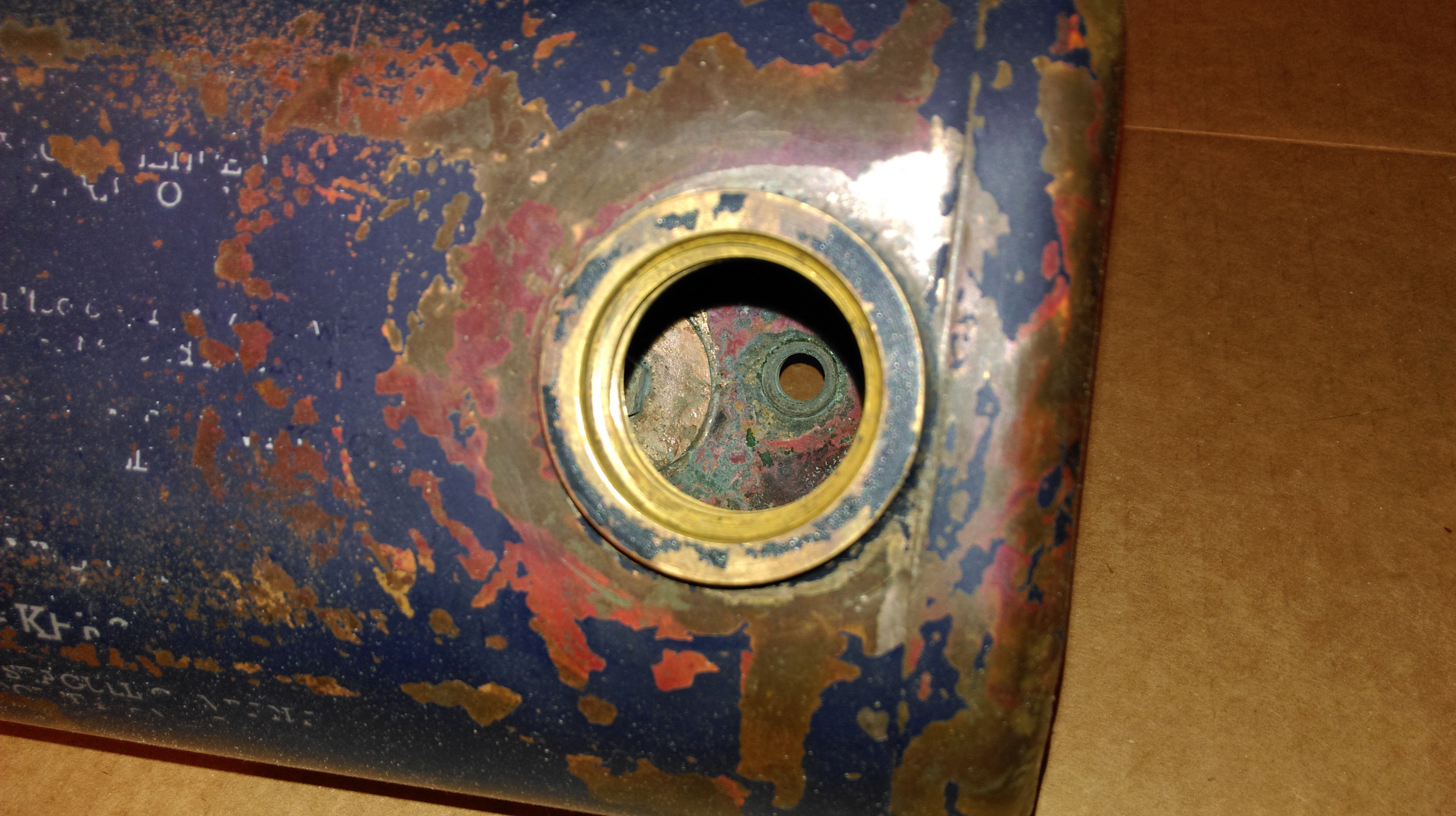

The fuel tank is painted blue....but is a brass one ??!!

not time this weekend to do much...but managed to take a picture of the tank.....what you guys think about the inside?? Does is look clean enough....or needs it ??
