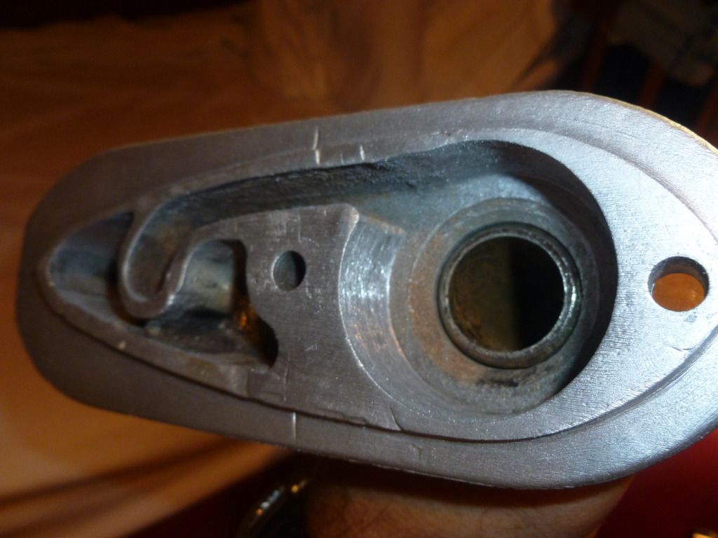

Can anyone please tell me how far to push the drive shaft housing into the exhaust flange , maybe a picture would be helpfull
does it go flush with the flange ?

Your square drive shaft will indicate how deep the shaft housing must get. Or check this picture. It should not get to the chamber with the bigger diameter.
I hope you get the idea... The method with the shaft is the most secure.
I love the 10600/145 turns!!!
Re: Restoration questions
The driveshaft tube should be inserted until the end of the tube is level with the uppermost edge of the chamfer at the top of the water pump impeller housing.
Don't use the square drive shaft as an indicator as many of the models have different height pinion shafts & what might be right for one could be very wrong for another.

Great thanks , will post some pics when finished .
