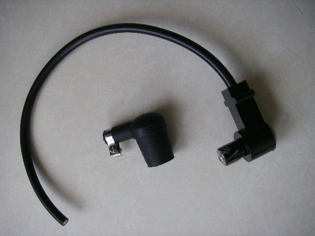

John must have Charles uk on commission for all of these referrals! I'll try and get some lead locally but if I have no luck I'll get in touch all right. I know I haven't got a hope of getting the 4mm locally but I'm hoping one of the local motor factors will have some 5mm that will hopefully do the (bodge) job

Thanks Keith.P, I'll keep you in mind if I have no luck locally. Did you buy that on the web or where? A search for "4mm ht lead" on ebay shows no results. I'm so jealous, you must have a good twenty metres of the stuff there! You must have a lot of seagulls to be buying that kind of quantity of ht lead. It's handy stuff to have around the garage I suppose. I did buy one of the seagull ht leads with the connector on the end as supplied by John at sos a few months ago and the insulation is a lot thicker than 4mm,obviously it's not suitable for my situation. I'll be able to use it one of my other gulls if they ever need replacing, handy to have as a spare.
