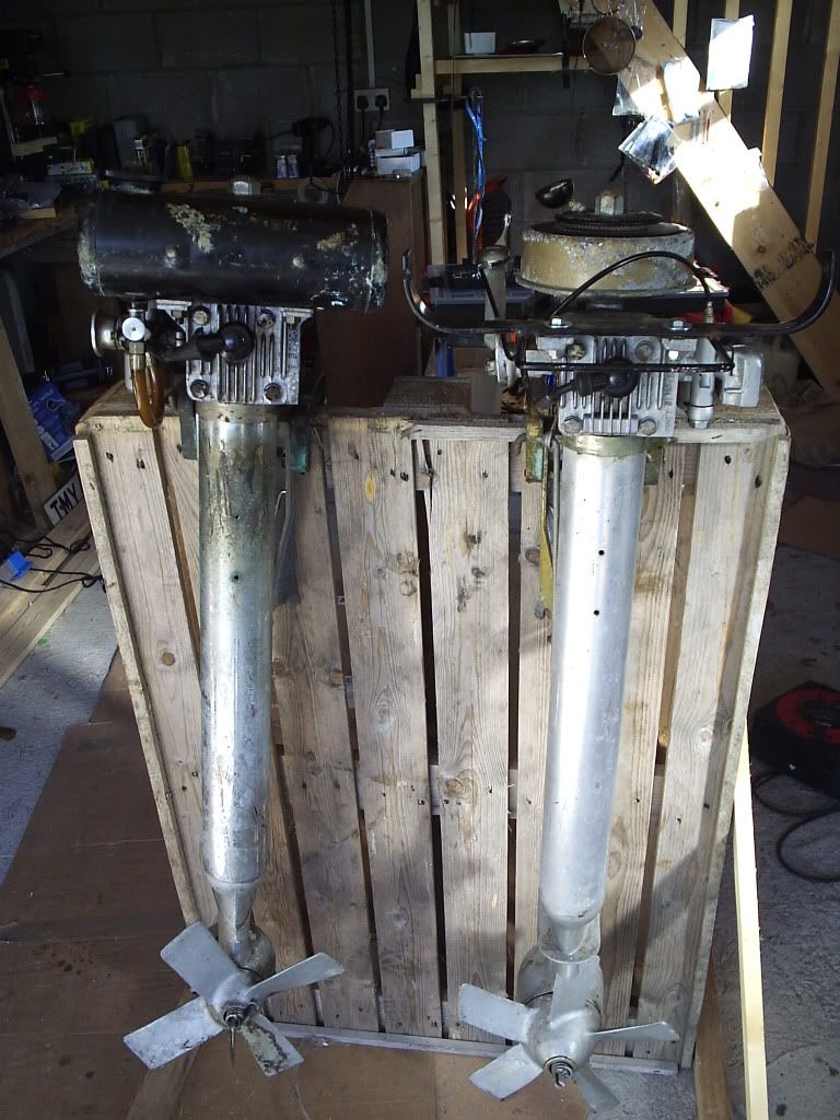

Right!! my beauties have arrived!
the main one is a 1971 Silver Century with a clutch?, I assume thats the rod that operates down? looks in pretty good nick.
I trust that means I can idle while the carb runs dry?
it has a 5 bladed prop.
WSPCL 2800EI Long Shaft
the other was the main workhorse
also a Silver Century, but much older and well worn, it is fixed drive, has a 4 bladed prop and a Villiers Carb
CPL 1492D7 longshaft.
I see both use EP 140 oil,
I also have a spare tank that looks in very good state
will probably start cleaning the oursides this weekend as I explore!
any advice on the above motors welcomed.

CPL would make it a Century rather than a Silver Century, the Villiers carb confirms it. Both decent engines.

CPL1492D7 is frozen solid(LHS), cannot move the flywheel and the Piston is at the top of the stroke, I've poured oil in, up ended it,danced the hokey cokey with it and welcome advice.
one interesting thing is that it is shown as a long shaft yet is shorter than her younger sibling WPSPCL2800E1 on the right hand side.
there everything looks ok, everything spins freely with some compression, the Clutch works and the carb does not look too bad.
I need the connection from the the tank with the stopcock as well as the pipe and screw fitting to the bottom of the carb(not sure which carb it is) and will order that plus some other bits from John on Monday/Tuesday.

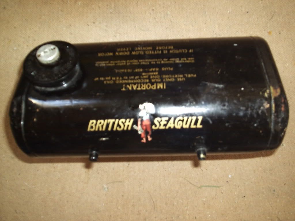

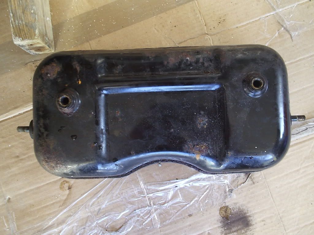

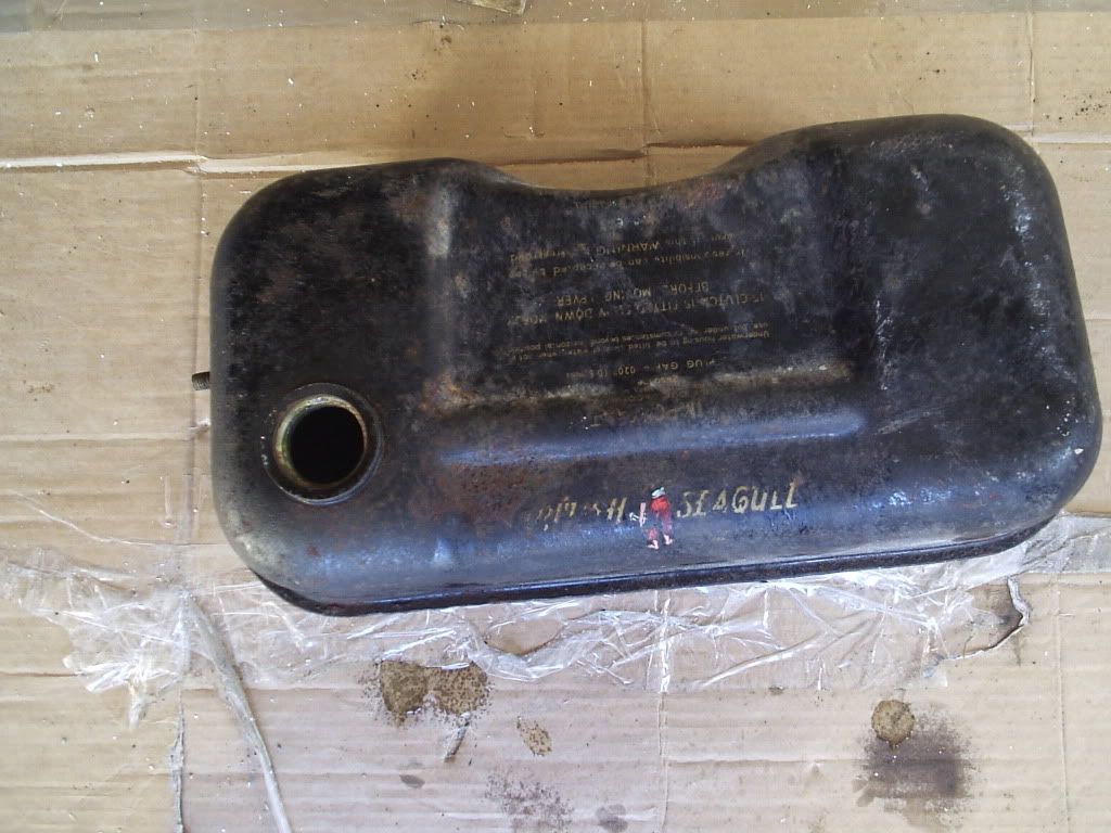

apart from the small , newer Tank ...
there is a larger tank also marked Seagull with a cradle but it has two Holes for a stopcock/Fueltap, one on either side..
