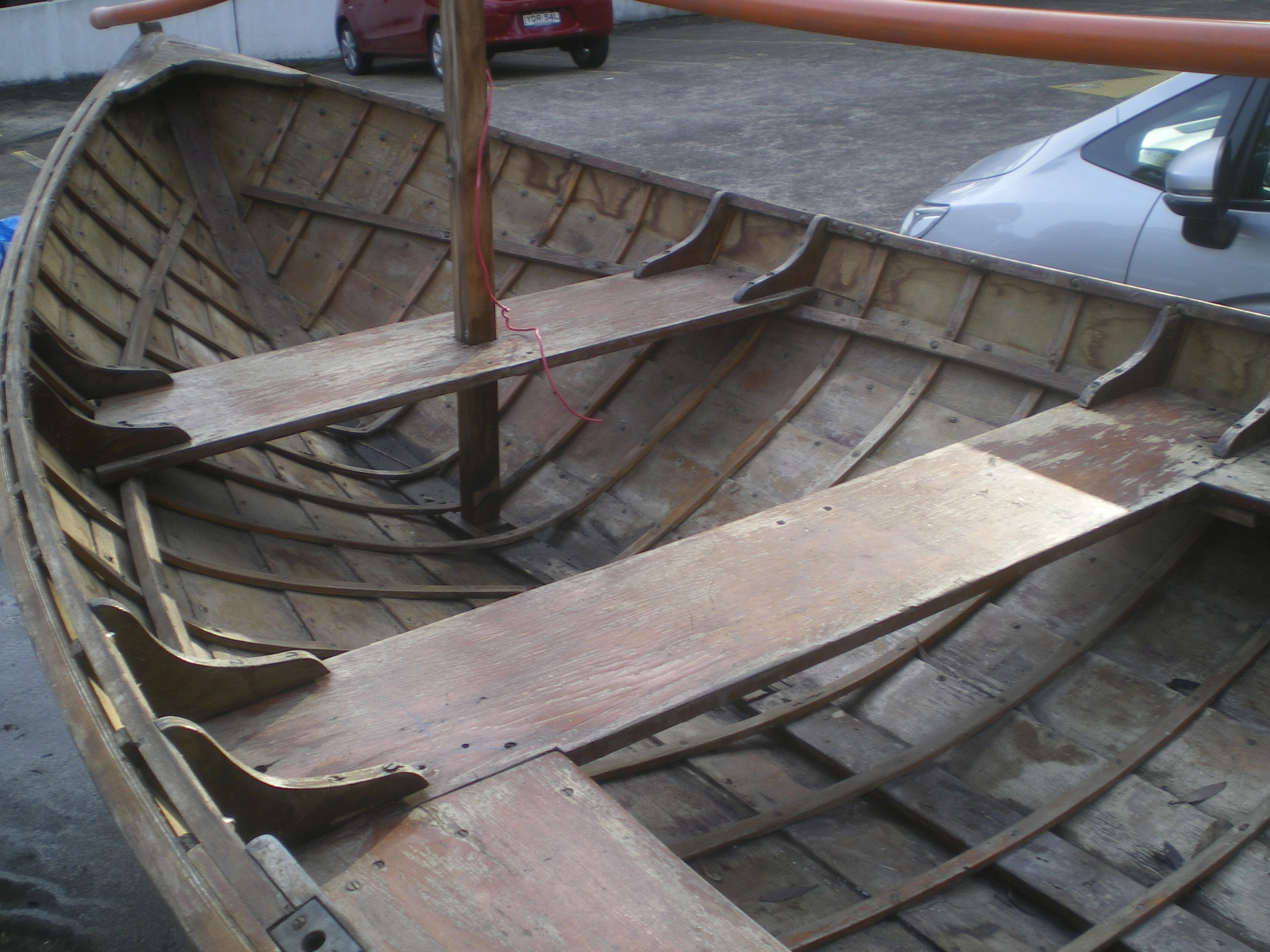

It looks in quite sound condition I can see the keel slot needs plugging how about a few photos of the damaged areas.

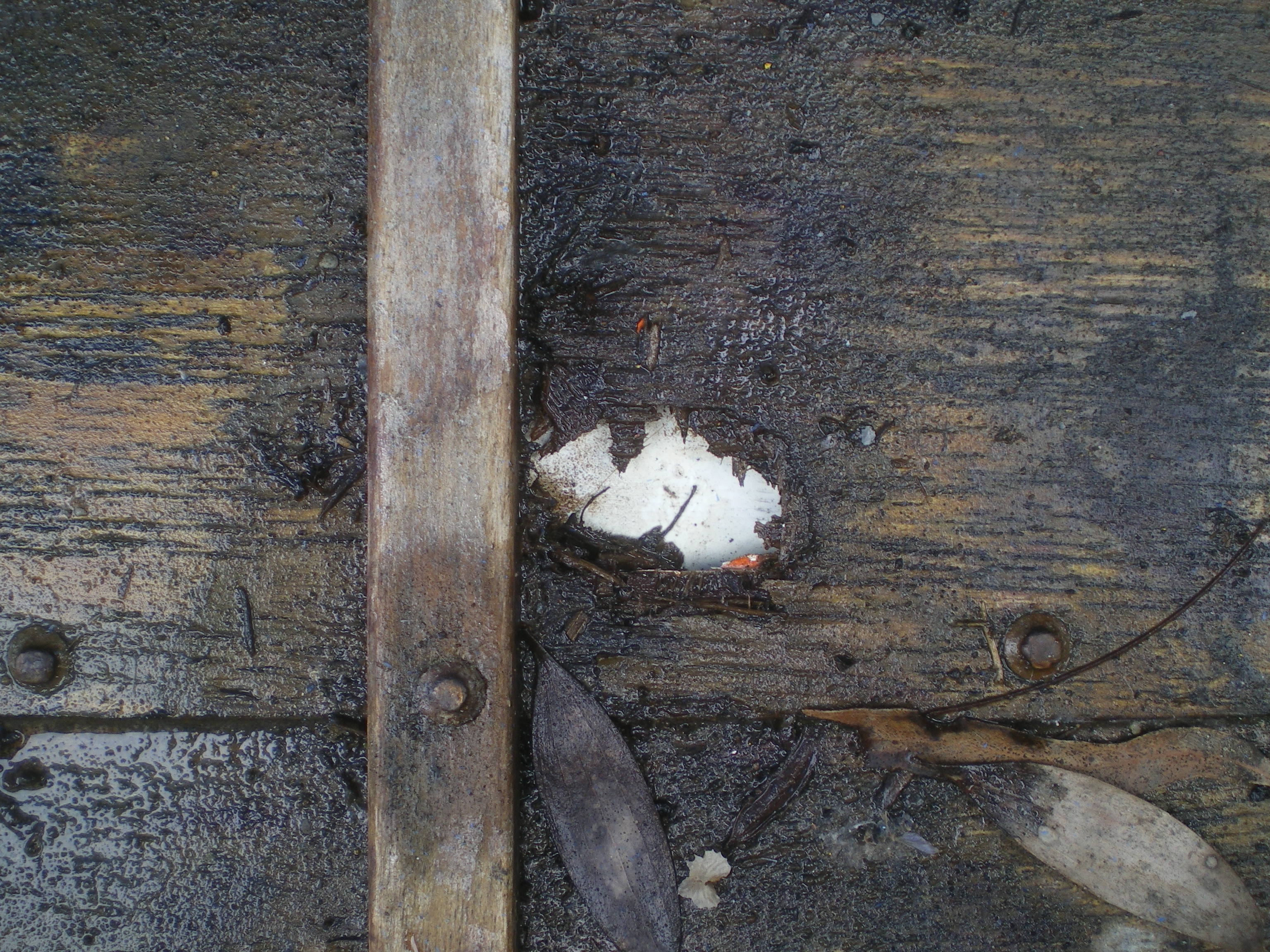

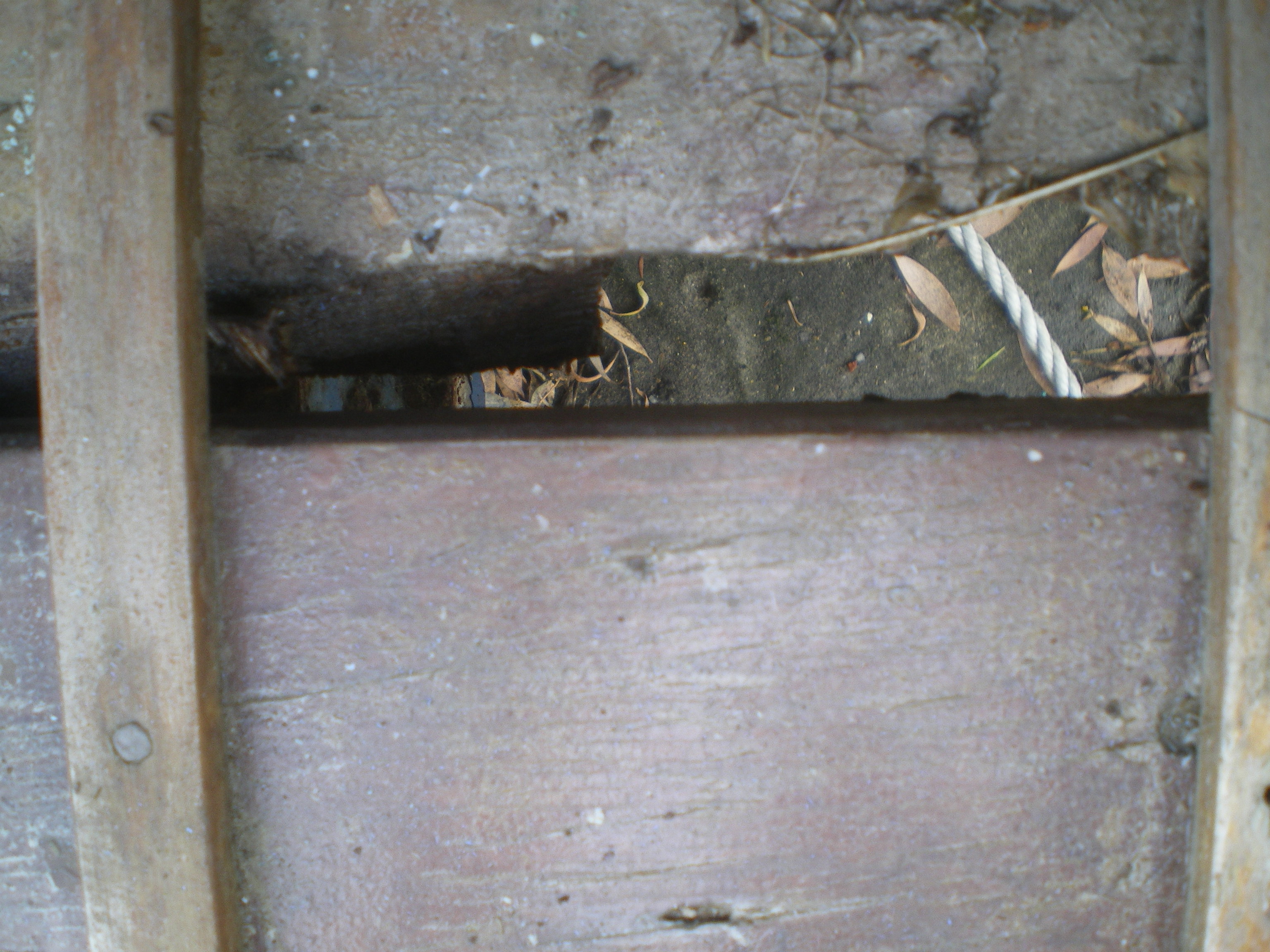

Needs a good dry out. Not the best photos:
Plank next to keel. Inside looking down.
Another rotted plank on bottom.

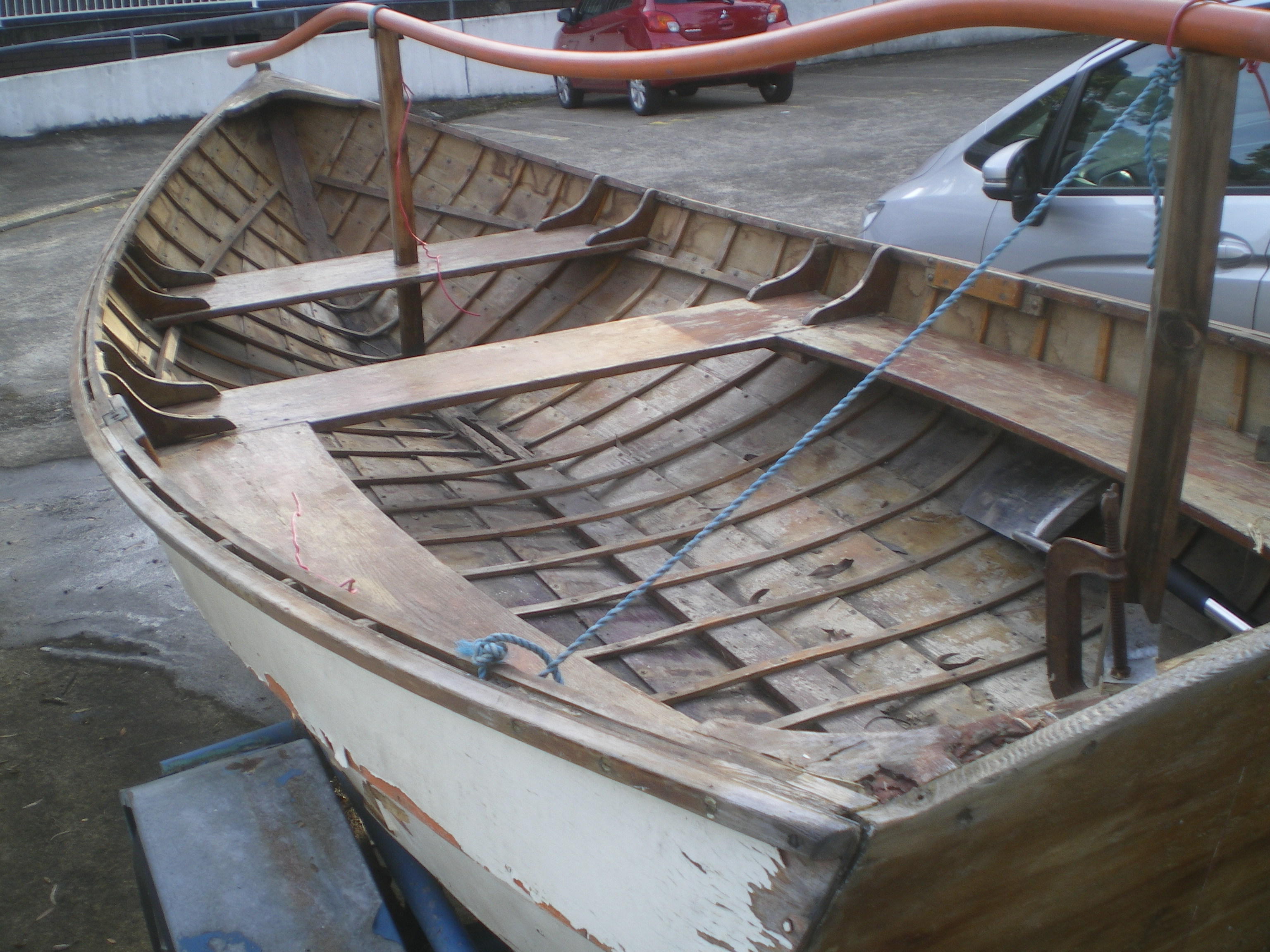

Starboard side. Think at some stage it must have been sitting on its side outside.

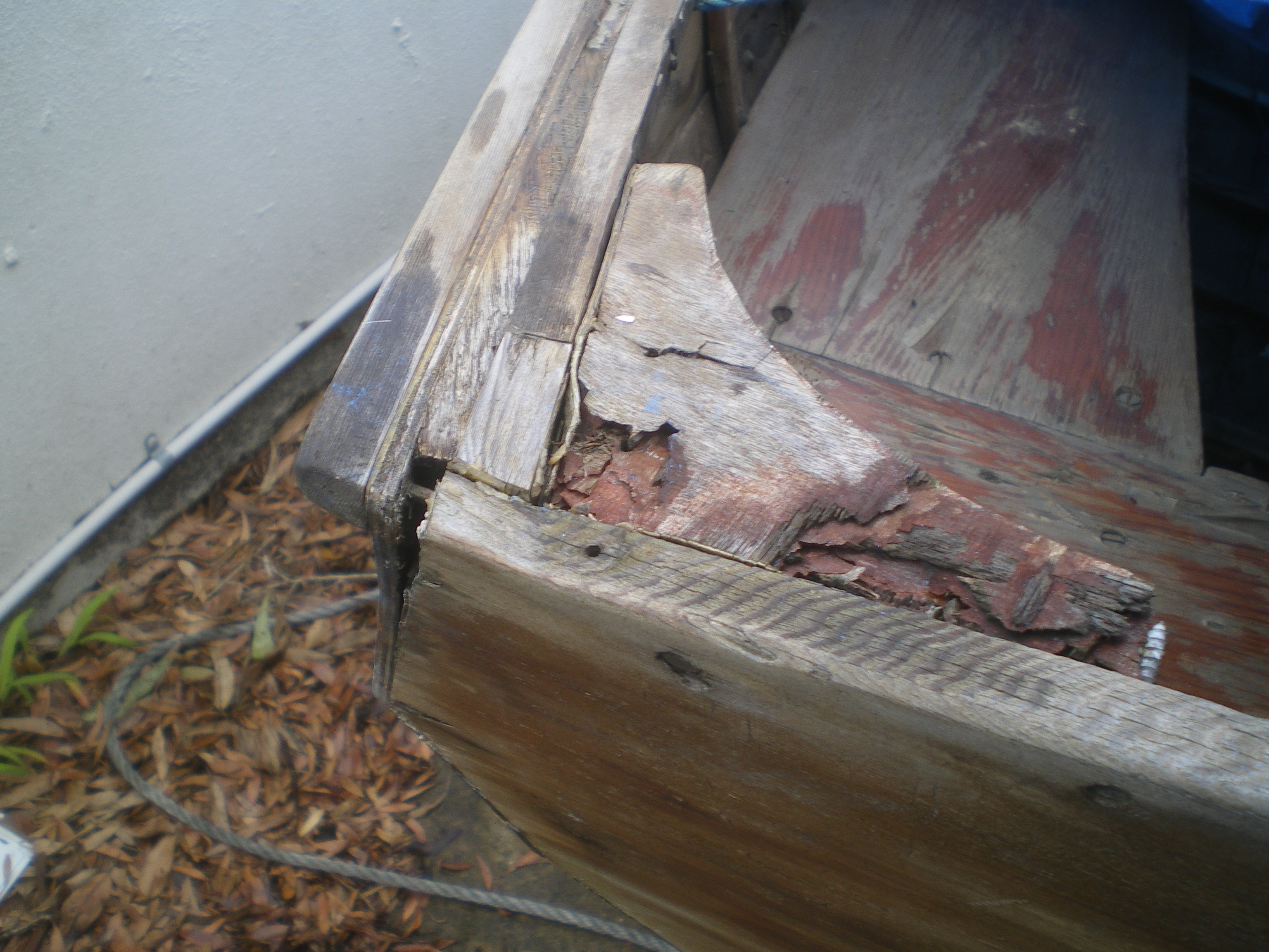

The quarters and some hanging knees are rotted too though I can do those. It is mainly to scarf in about five plank repairs.. Need to put some floorboards in as well. Planks made of 1/4"marine ply. I have 6mm sheet.
A shipwright also advised me to add a heavier timber skeg keel to the existing. It is the same as this all along. Also suggested a bulkhead about 2ft back to strengthen the bow quarters.
Ideally it would be good to replace all planks. There are 6 each side.

would be a lot worse than the photos show
saw it about 4 or 5 years ago.

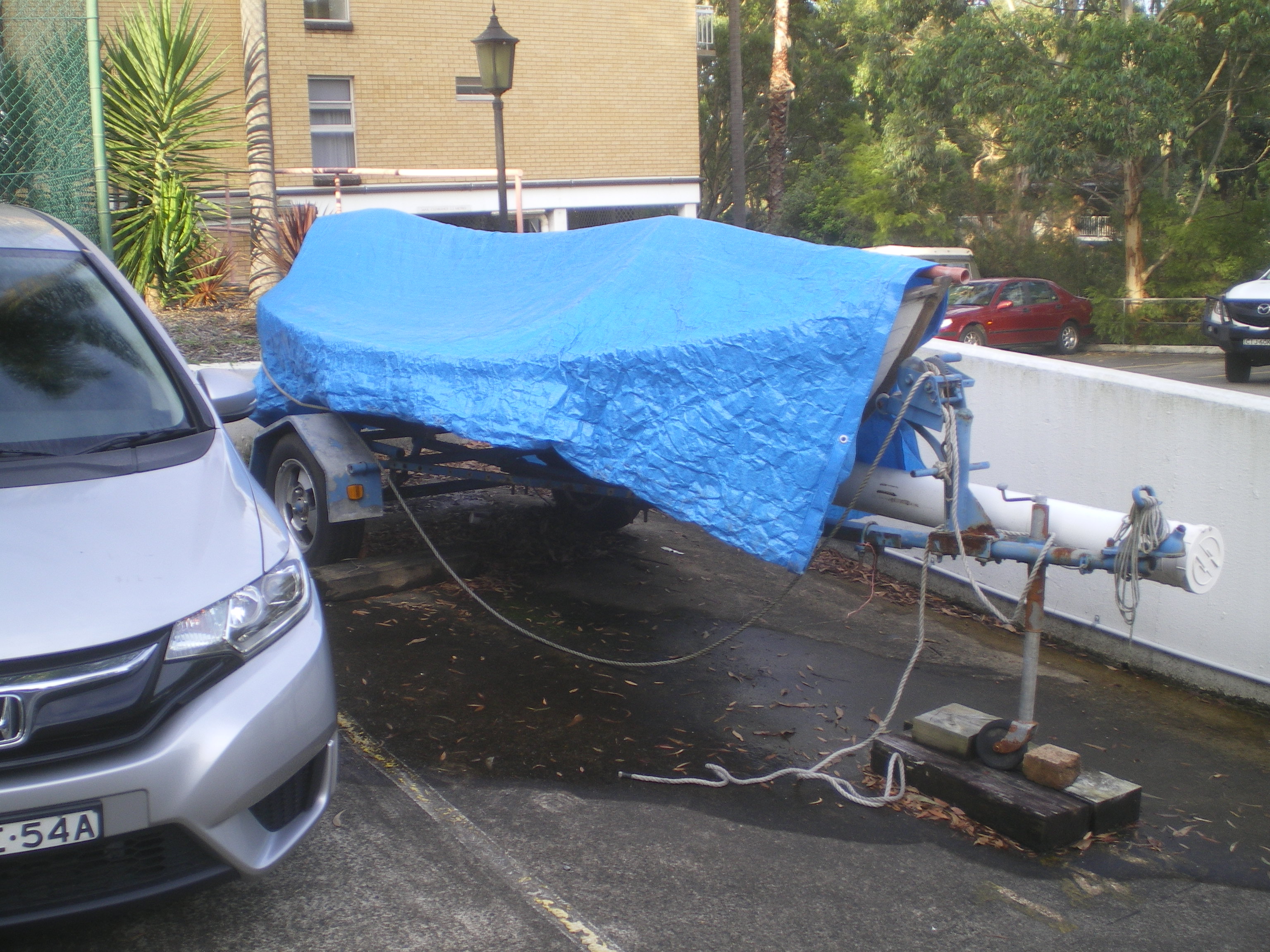

I've been through contacting boat building schools and technical colleges but without a good result. Space always seems to be the deterrent. I did have a promising lead with a maritime inspired "Mens Shed" but alas the space was again a problem. So.... I'll do it myself. I have a parking space and have to work on it there and include the trailer too! Fortunately it is a dry day today (1st in many days) so cover off and let her dry and make a timber frame to bolt to trailer so can work on boat hull up. She hasn't got a name and I'm thinking of Charon (of Greek Mythology, is Stelios still here?) It is actually not in as bad shape as I imagined. I think a long shaft naval SD will compliment her well. I could probably join a wooden boat forum but I think there is enough experience on here to guide me

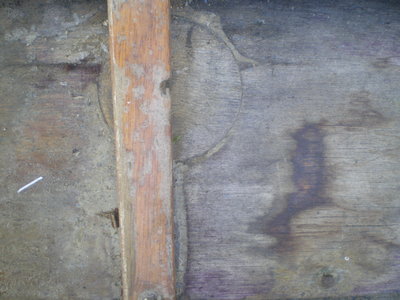

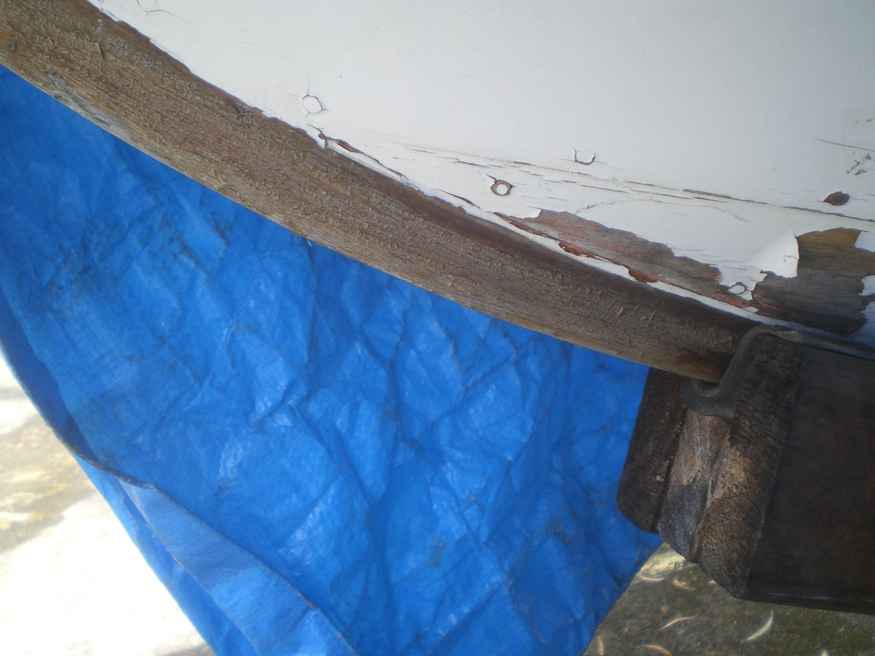

Here is my first question. In my travels I've been told of a product that can be applied to spongy wood that then soaks in and sets rendering an easy repair. There are a couple of spongy bits that have not yet rotted out.
Look it has been repaired before:
