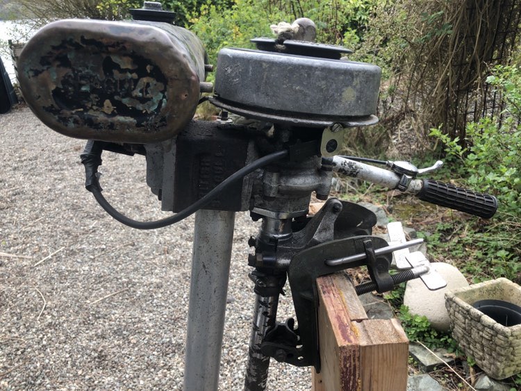

I was given this engine a couple of days ago. Why? Because I mess about in boats and have a couple of dingies to get me out to my yacht on its mooring.
This engine spent at least the 30 years propelling two elderly gentlemen around Loch Awe in a heavy 12' mock-clinker grp dinghy; stopping only for a beer and to cast a lure into the water. When the engine packed up 4 years ago they splashed out and bought a modern 4hp 4-stroke and the Seagull was pensioned off.
The engine doesn't seem to bad to be fair. The tanks is dented and lacking paint, but it's still half full of old 2-stroke mix. The prop has a few dents and dings thanks to the stony foreshore of Loch Awe. There's plenty compression when I compare it to my Mariner 2hp 2-stroke. The plug came out easily, well sooted up but with only a 10 thou gap. I opened it up to 25 thou and there is a nice fat spark when I pull the starter cord. The prop spun as well so the top is connected to the bottom; always a plus.
The carburettor looks to be the only questionable bit. It's a Bing carb, so good for a 25:1 mix. The cowl is missing and the cable just lifts out of the top.
First things first though. Drain the tank, a damn good clean and then see if I can fix the carb and get it started.
