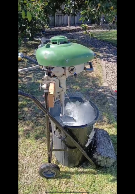

I’ve now had the motor running in a drum. Initially it only ran on one cylinder, so I replaced the old Champion 8COM spark plugs with a new set of D16’s, set the points, and it started second pull and ran smoothly. It does however give the occasional back fire, as though the ignition momentarily completely cuts out then in again.
One thing that I noticed is that the cylinder heads get very hot; too hot to touch with bare hands, and any splashes of water on there quickly evaporate. There is a good strong stream of cooling water coming from the tell tale, and possibly a similar amount exiting with the exhaust. I also loosened the cooling pipes from the cylinder and confirmed that there was water flow.
Is it normal for these engines to get this hot?

The cylinder head is not water cooled, only around the sides of the cylinder, so yes, the cylinder heads will get hot.

Thanks for the info. Any suggestions as to what might be causing it to backfire?Ferrier120 wrote: Fri Apr 11, 2025 4:43 pm The cylinder head is not water cooled, only around the sides of the cylinder, so yes, the cylinder heads will get hot.

I think it may pay to double check a few things, making sure the carb is still clean, then all contacts on the ignition system are clean and have good connections.
