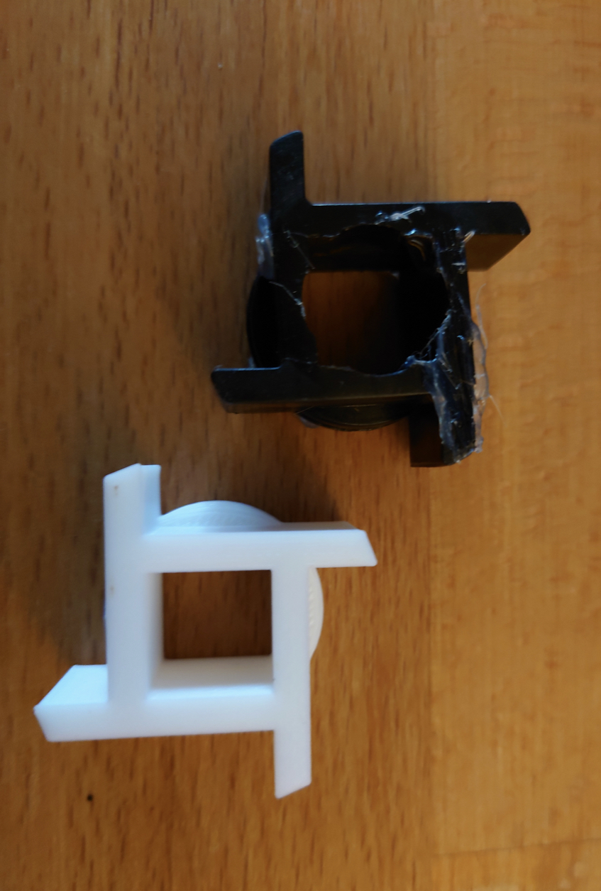

Hi, new guy here, also wondering on the possible size differences and clearances. I have just bought a 40+ that won’t pump water. I checked that the passages were clear and at the time I didn’t have any knowledge of recommendations to remove the prop. Anyway when removing the lower gear box the rotor came out in 3 pieces.
I found someone who can 3d print one by measuring mine. Has anyone tried this? It will cost less than customs and shipping to get and may be an avenue to procure more as I’m sure that supplies are limited.
Does anyone know the tolerance of the rotor or clearance to the sides of the casing?

Solent-seagull, I’ve heard/read of the different uses for part number applications. Do you know of any physical differences between the rotors for different models? Is the shaft size different r is the clearance for the rotors different in different models?
The guy has made one for measuring. I’m going to bring the shaft and try to see the fit by weeks end.

Here is the new printed rotor (white) and the original (with glue holding it together).
Any opinions on this?

Not knowing the print mix...give it try aye?
