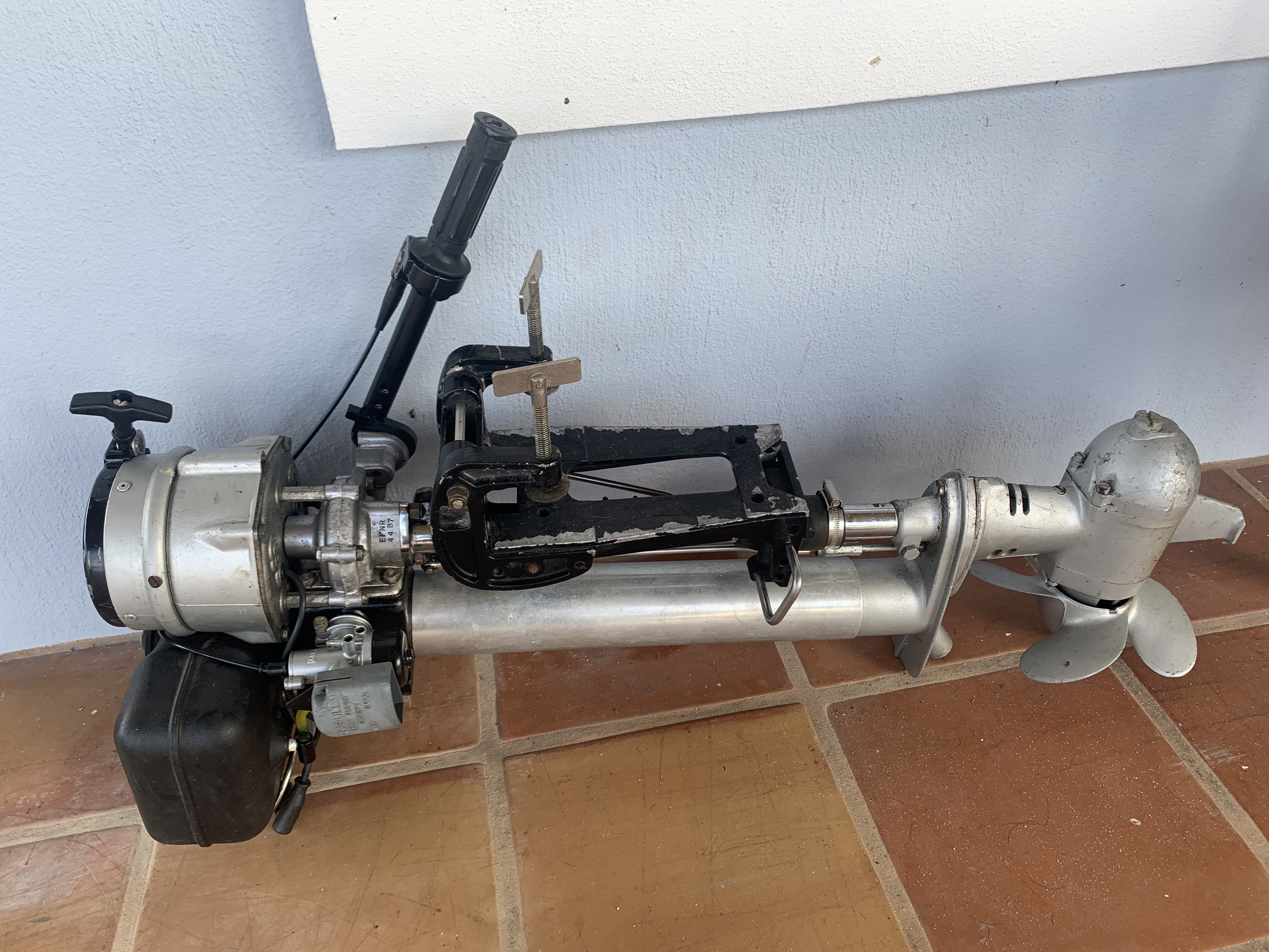

Working to get an EFNR up and running but having some difficulties.
I ran this motor only once when I bought it a few years ago. Was very tough to start and ran rough. Motor otherwise in good condition.
Recently I cleaned up the carb (Amal 416 1A) and replaced the rings and head/base gaskets. Did not disassemble crank casing. Bright spark, 70psi, thought it would fire up well but no luck.
My first thought is that there could be a problem with the carb, though it does seem in fine condition. I don’t have any alternate 416/1A carbs to try, but wondering if a 416/2 carb from a forty would be an acceptable substitute? I couldn’t find any reference on the forum to the differences, so not sure if the 1A and 2 versions have different jets etc? I have a forty with a 2 version that starts first pull every time, so know that carb is good if it’s an acceptable alternate to try.
My other thought is that there’s a leak in the crank case causing loss of vacuum. Don’t see any leakage at the join from running in prior life though.
Looking for suggestions please!
