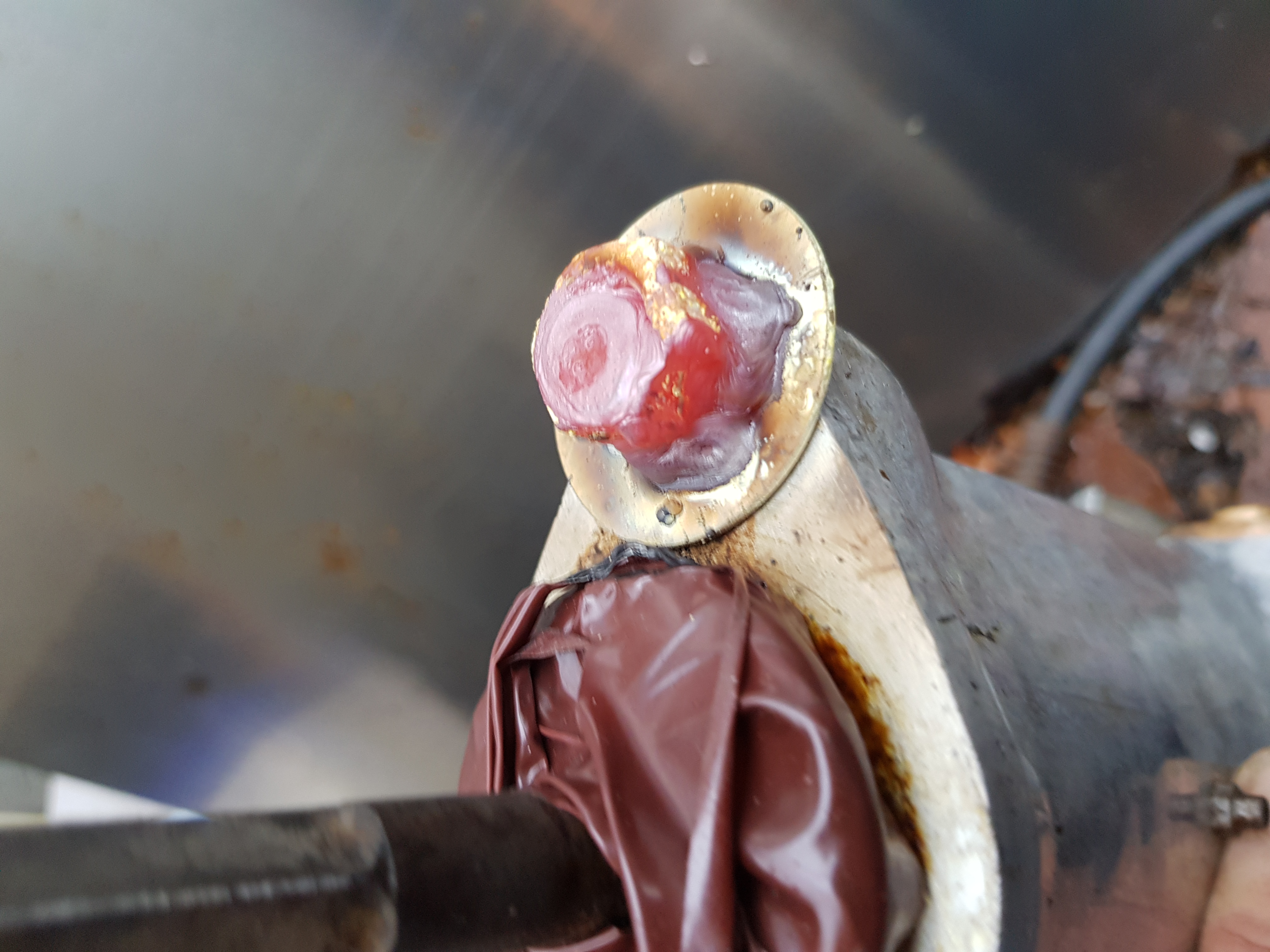

Have you got a welder? if so weld a nut to the end of the broken off bolt. the heat when welding will help to free it up and the nut will give you something to grip.Oyster 49 wrote: ↑Fri Mar 05, 2021 10:31 pm Water jacket cleaned out, and gearbox examined tonight, it was pumped completely full of grease! Under some pressure too, as the end cap lifted off, when the bolts were undone. Dirty horrible job getting it all out

I sent the gearbox down to H-A who kindly drilled the bolt out on his mill for me.

I always weld a washer first then weld a nut to the washer, I got it very hot a couple of times. bolt was well in.

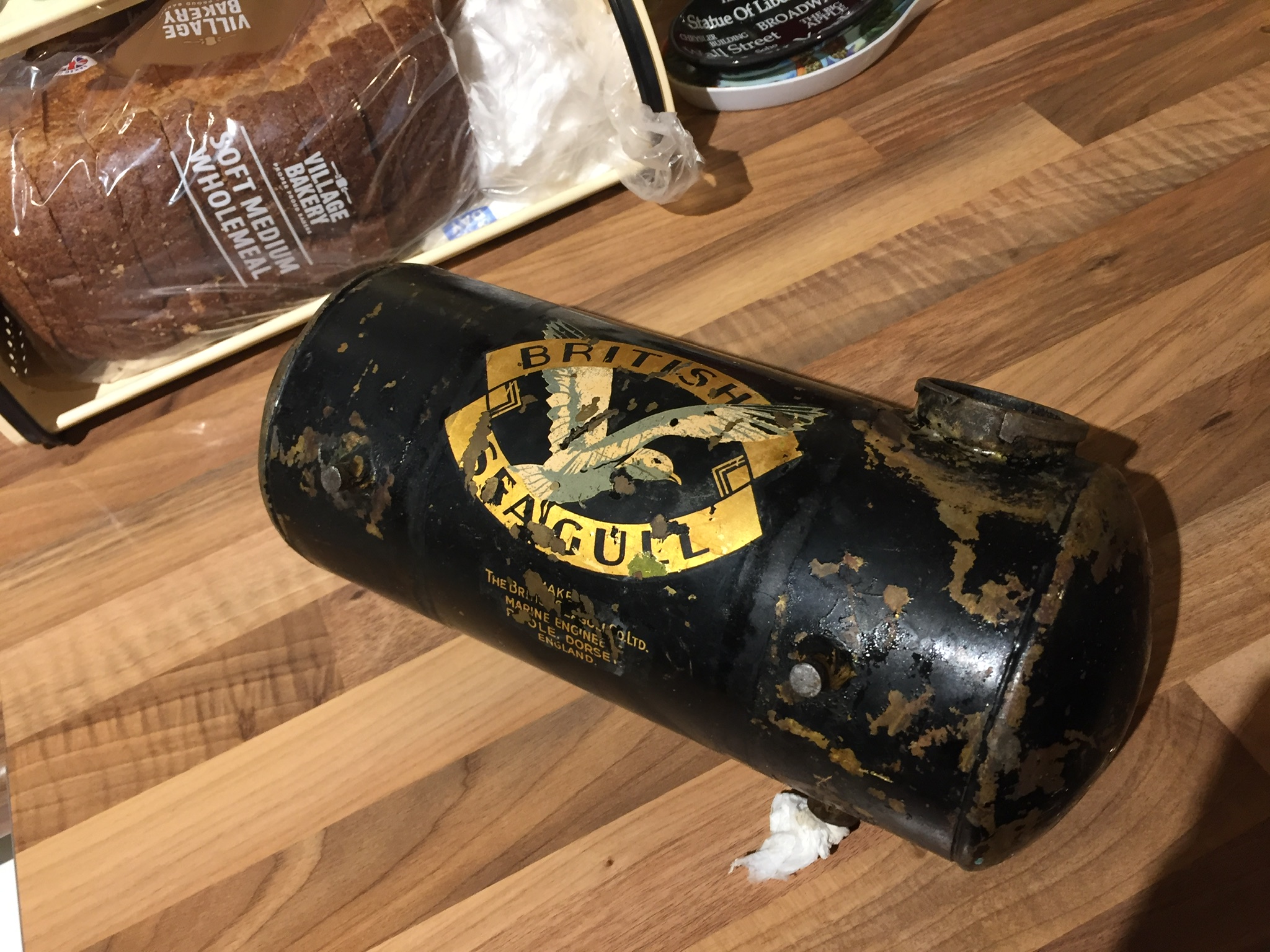

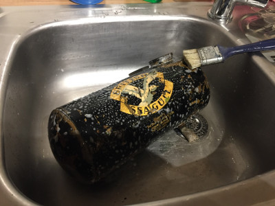

Cleaned the tank tonight, keen to preserve the original decal. I used paraffin, to degrease and soak, then filled with caustic and left to soak for an hour, then repeated. Finally a wash with washing up liquid and a brush. Nearly all the decal is still there
This is an early brass tank, and it’s interesting to note that the end caps seem to be a similar shape to the steel tanks, this changed to a more rounded end cap not long after the brass tank was introduced.

I do the same thing. too easy to melt the Alli otherwiseI always weld a washer first then weld a nut to the washer,
