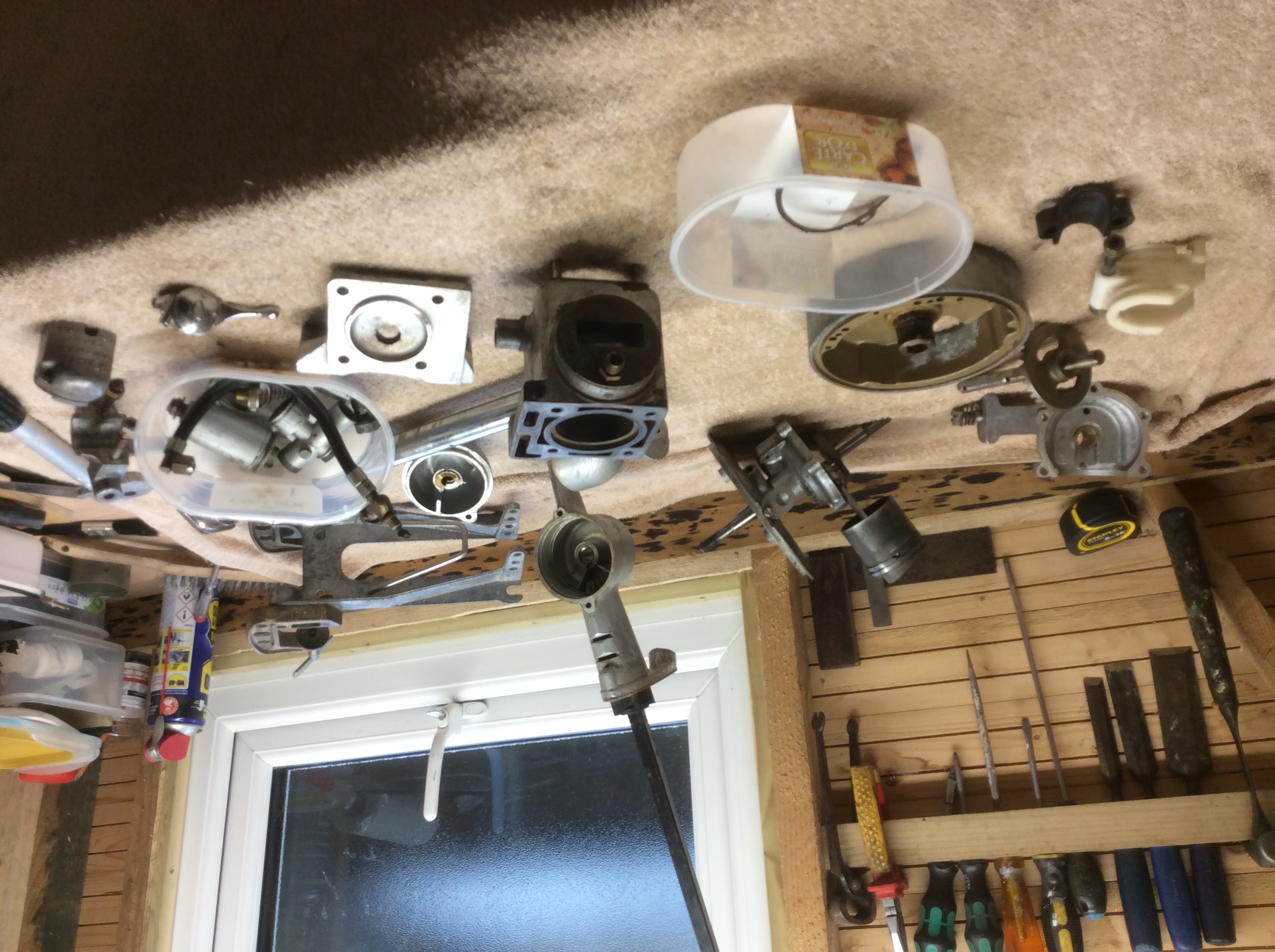

I’m aware that this question has been answered before but can’t find the reference. I have also rebuilt two 40+ engines before but can’t remember what I did. I have stripped down a Silver Century, cleaned it off and ordered gaskets etc from John. Last time I used RTV sealant on the cylinder head, base and crankcase but I can’t remember whether I used it on one or both sides of the gaskets! Apologies in advance but can anybody help with an explanation of what to do and why?
