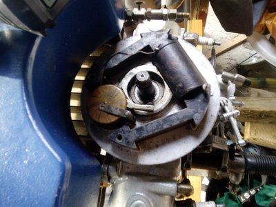

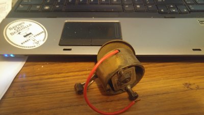

I have recently acquired this Britannia.Iit has the prop forced water system and a 3 bladed prop with chromed gearbox. The coil is no good so is there some way of replacing/repairing it? Is this villiers ignition? Any help would be much appreciated. This is a cool motor and mechanically is in excellent condition.I am in the process of reproducing the decals which is a challenge but will have them done soon. If anybody wants the files to have them printed out let me know.

Re: BMB Britannia coil fix?
Welcome aboard
Go here for your coil. http://www.villiersparts.co.uk/ignition.html
Pull yours out and measure it. I think it is the one in the centre of the page.
A phone call to confirm is a good idea.
May as well get the condensor as well as a precaution.

Mk1 it is. The coil is a "special item" in that is internally double wound with individual ground tap.
There is no actual Villiers part number in the parts listing........

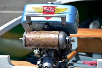

Thanks very much for that. So I can connect both plug leads to the output and it will be ok? I have read some posts claiming that doesn't work very well and others who say it does. You say to get the condensor as well. There isn't one in the original magneto setup so do I need one with the different coil? Regarding decals, I will let you know when I have finished the artwork. Some of it is going to be guesswork but I am trying to make it original as possible. Here's one I did for my Anzani Super single. I had quite a good one to work from on the tank before restoration.

Condensor under points. Remove the points housing.
Single outlet coil OK for running in a test tank only. It will smoke if used on a transom.
BnC[/color][/b]

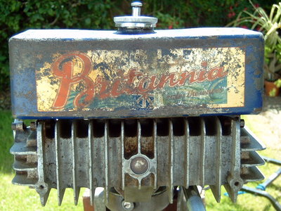

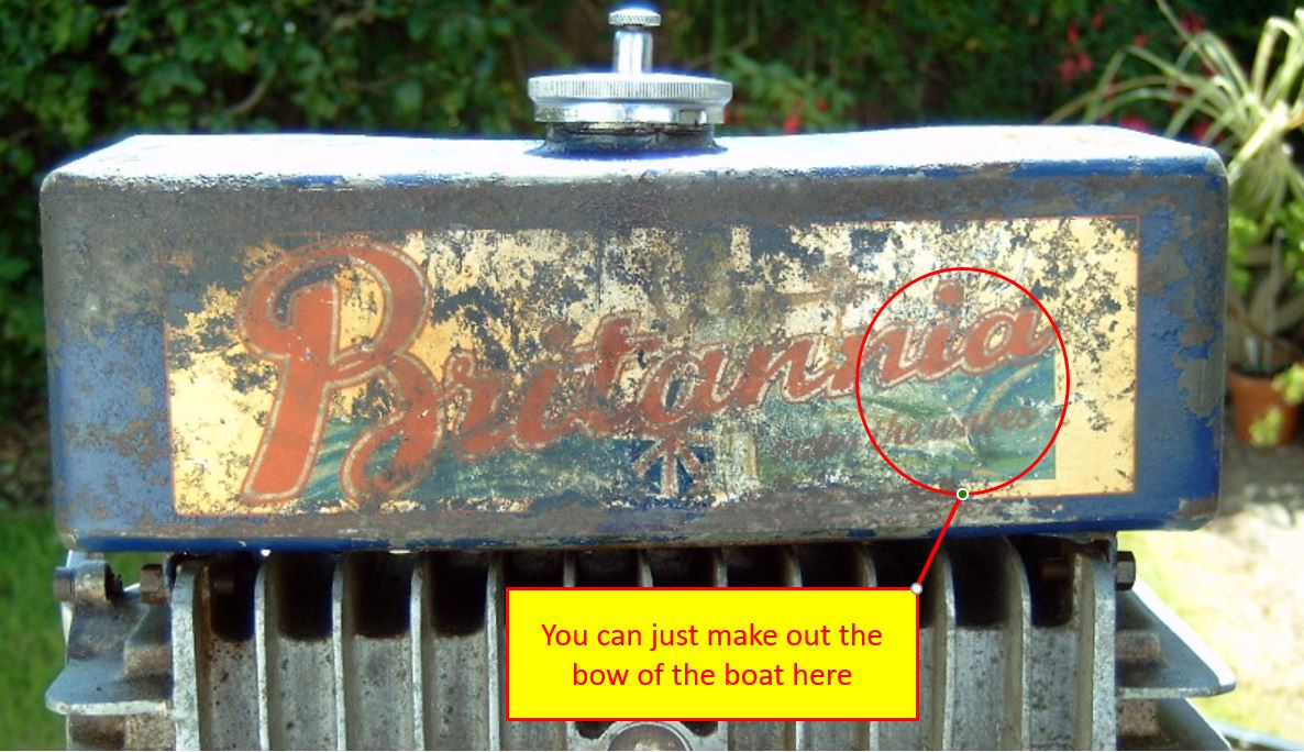

The coil is sometimes referred to as a Villiers 'Twin Spark' , I've found a label on one which gives it the number 1042 x 4E. Tried one of the Villiers spares companies a couple of years back who quoted, I think, £85 +vat to rewind one.
Many years ago I tried using a Seagull coil with a soldered on brass strip to reach both pick-ups, but wasn't successful as it ran unevenly for a few seconds before stopping as it was only firing on one cylinder - someone suggested that a spark will always take the shortest possible route, so unless everything is equal, it will only spark on one side.
I have a motor with partial decals if it helps.

This is where I have got to so far with the decals. Still not totally happy but getting close I think. More work on the waves needed. If anyone can supply a photo of the side tank that shows the T in Twin reasonably clearly it would be much appreciated.

Well, you seem to have got as far as I did. I has to free hand quite a bit, and also wasn't sure of many of the colors.

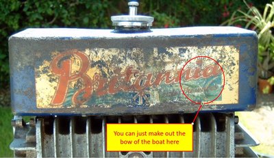

For the water, i just used an image instead of trying to recreate what was there. Also, I (and you) are yet to put in the boat which sits somewhat around and around the 'rules the waves' text. Due to the lack of quality, the boat is not visible in the image posted by Ferrier, but if you look closely, you can see where the bow separates the water.
The same boat and water patterns also appear on the BMB letter-head.
I'd be interested to knoiw what drawing package you're using. I do all my stuff in Microsoft Powerpoint which is very cumbersome and limited. I also can't achieve the high resolution that's needed for printing of these things.

here you can see I began tracing the boat image from the letter-head - working with a red pen.
I had a real hard time with the text, particularly the T in Twin as I didn't really have anything to work with there.
All in all, I found it a very complicated decal set to reproduce, and clearly still not there yet.
