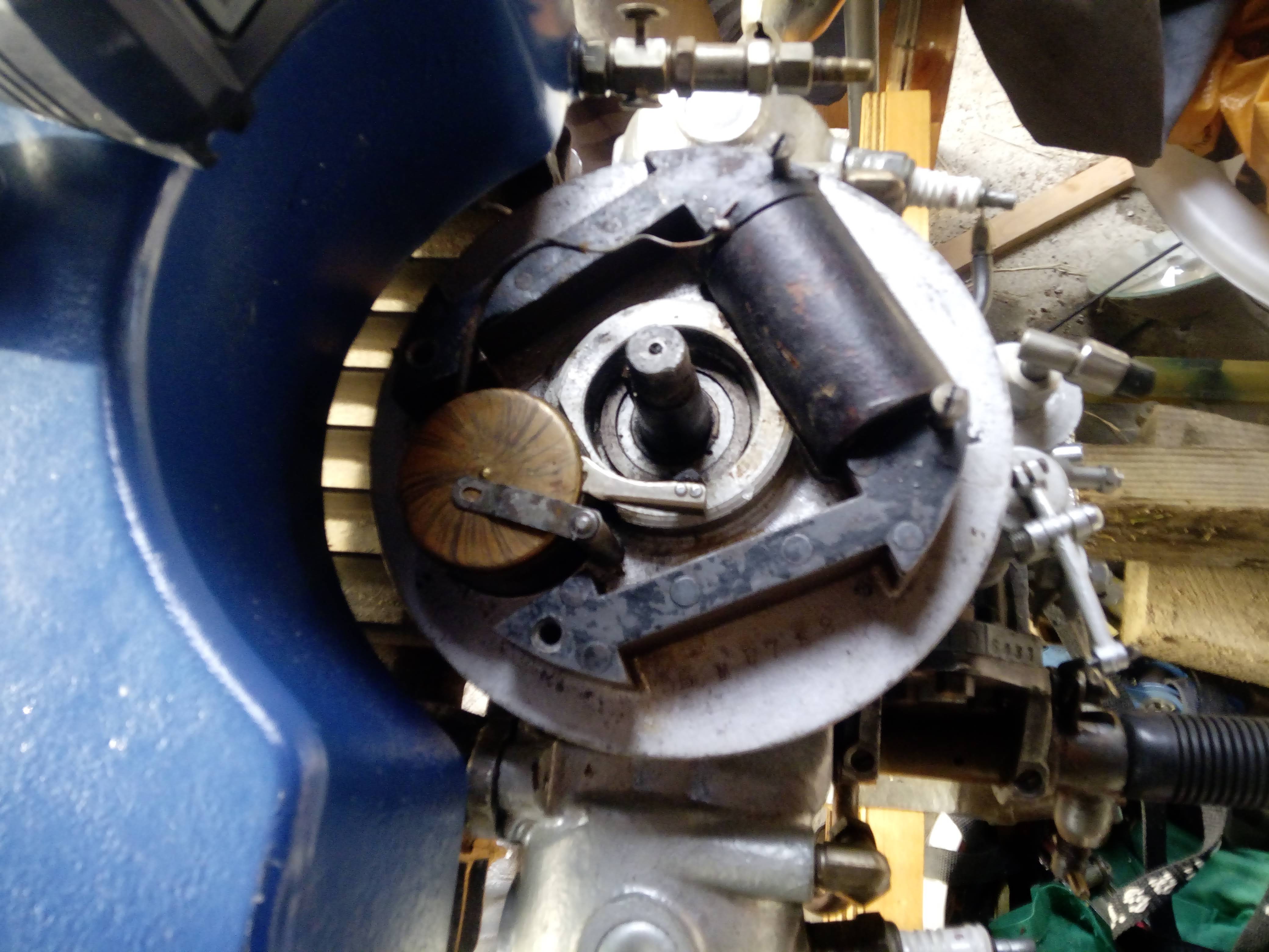

I have recently acquired this Britannia.Iit has the prop forced water system and a 3 bladed prop with chromed gearbox. The coil is no good so is there some way of replacing/repairing it? Is this villiers ignition? Any help would be much appreciated. This is a cool motor and mechanically is in excellent condition.I am in the process of reproducing the decals which is a challenge but will have them done soon. If anybody wants the files to have them printed out let me know.

Condensor under points. Remove the points housing.
Single outlet coil OK for running in a test tank only. It will smoke if used on a transom.

That’s a villiers mark 1 magneto, with a dual output coil. So the coil fires 2 HT leads at the same time. This coil is not available I’m afraid. I found a NOS for a similar engine I rebuilt a few years ago, that was the last one that particular seller had.
However the single output coils are available (as fitted to early seagulls) from villiers parts, I suspect you can fit a single output coil, and connect both HT leads to the single output.
The only other option would be to try and find a specialist who could rewind the original coil, worth a shot I think, there are several outfits that do this, but this is a very rare coil, so risky.
