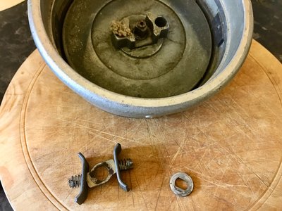

I know I have a retaining screw or clip missing from the top... ( I do have a photo)
I have the big blue Seagull Manuel but I just can’t don’t it!!! I need to see an exploded image of the starter.

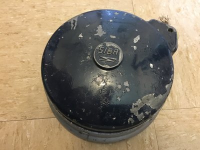

I have been looking the forum and I can see there could be different types... my one is a Siba... I have photos...but as yet don’t know how to post them?

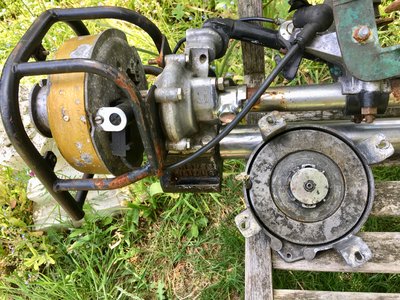

Ok that’s great, although I have just taken the starter of my old 40 plus ( 1967) that I was thinking of trying to get going again... ( took in some sea water six months ago and locked up... long story It wasn’t me!)
The workings look the same as my 90 as in washers etc?
I might be able to use the same parts?
