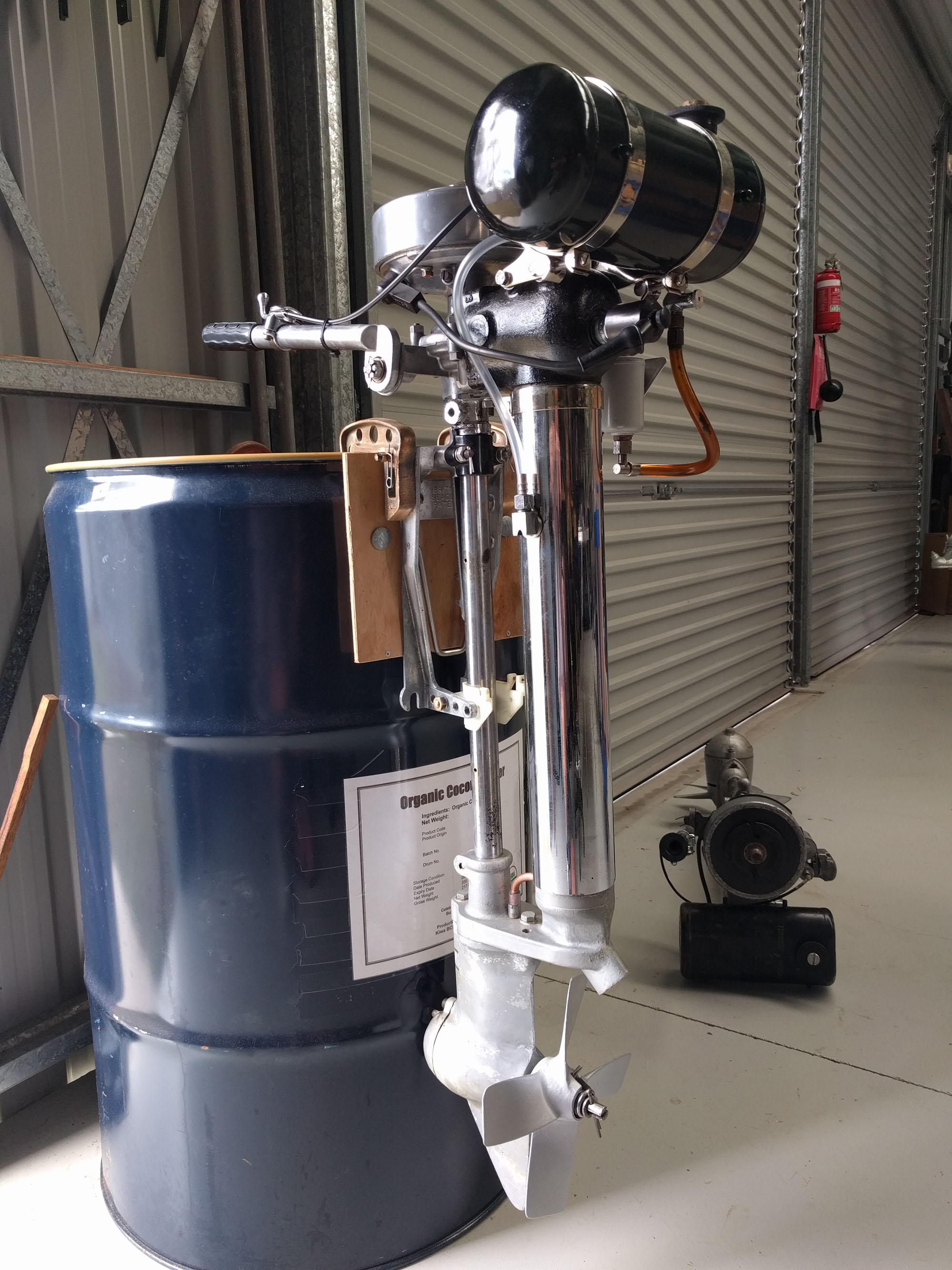

I bought this 63 model 102 about 10 years ago. I finally got around to "doing it up" and finished the project yesterday. The motor is in good condition with little rust in the head, and starts easily.
My association with Seagulls dates back to when I was young. My father bought seagulls (and Anzanis) for our plywood dinghy which I began using as soon as I was old enough to master the rope start. There weren't in very good condition and I used to venture out against the tide so that I could row home easily if they wouln't start (which was often). My uncle gave me a Seagull when I was 15 and this one was more reliable. I only kept it for a couple of years until I traded it for a Matchless motorcycle.
I intend to use the 102 occasionally on my tinnie to go fishing with the grandkids.

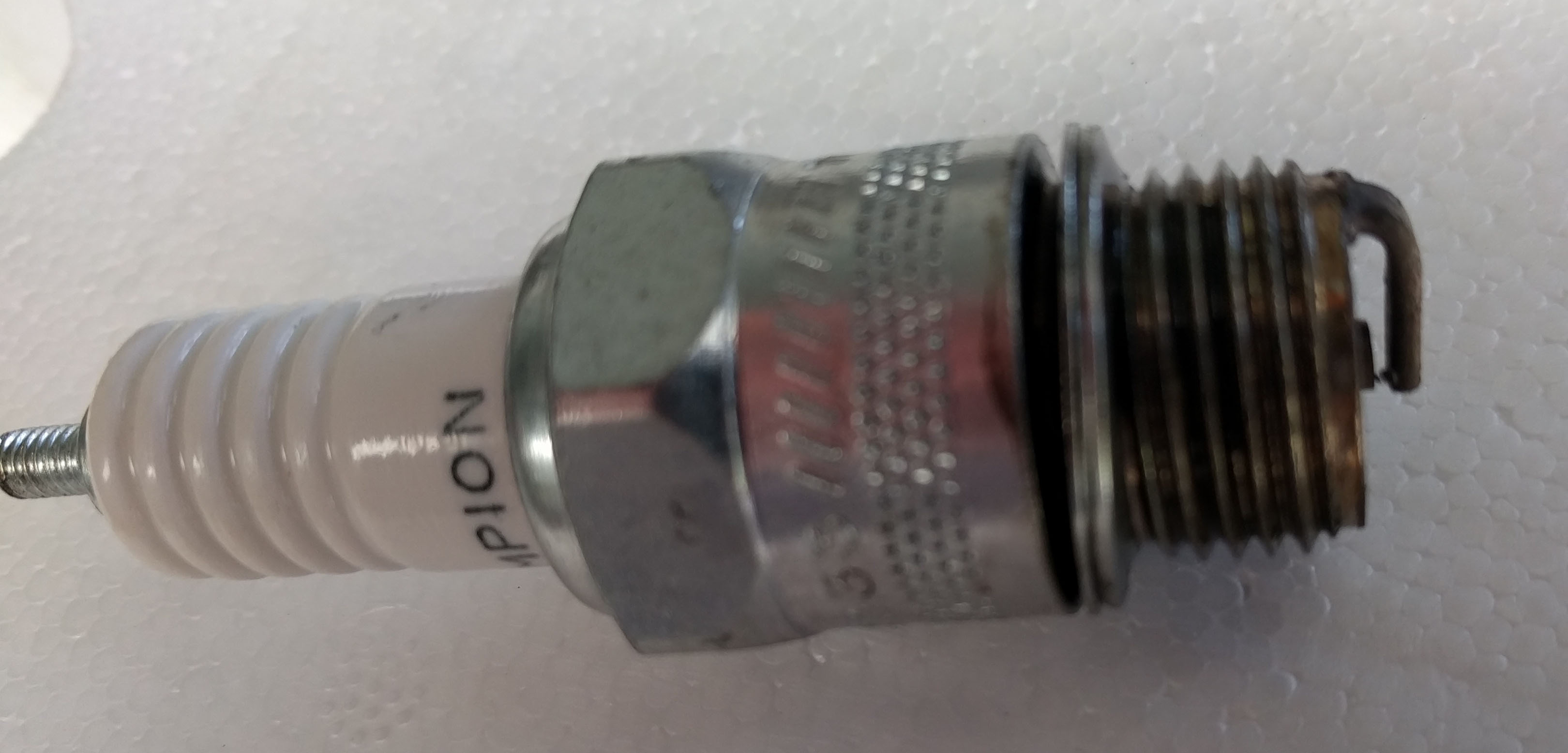

Took the 102 for a run on the river today with my granddaughter. The outboard ran fine but, after about 5 minutes running, it stopped dead and would not restart. I had to row back to the ramp glad that the test run was against the tide. My initial thought was that the coil had failed when it got hot but I found that the issued was a fouled plug. I guess that there was some loose carbon floating around in the cylinder. With a cleaned up plug, the outboard ran fine in the test tank for ten minutes. Lesson learned is take a plug spanner with me on the next test run.
A fouled plug put an end to the test run.

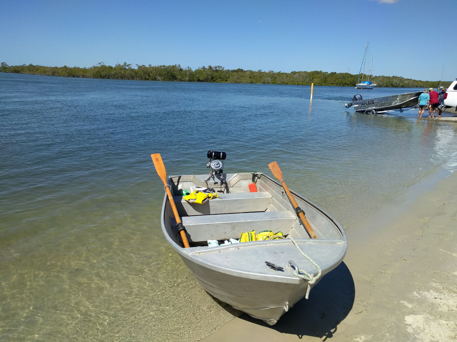

That cable tie on the tiller arm will probably kink the throttle cable if the tiller arm is raised vertical!
Re: Retirement Project
Good job on the rebuild, look great.
Valid point about cable tie, throttle cable often better left hanging loose from previous experience.
Who hasn't got a Forty Plus or a featherweight with a kinked cable, caused by the cable going through the hole in the tiller mount.
