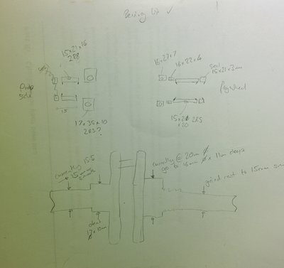

Following a nice chat with a forum member this morning, I riffled through some of the drawings I did and found the bearing details.
Bearings
Bearings
You can hopefully make out the layout. Two questionably dainty ball bearings on the upper end and a single medium sized one at the bottom. Flanked either end with a needle roller. For good measure there is an oil seal up top too. No room at the bottom :(

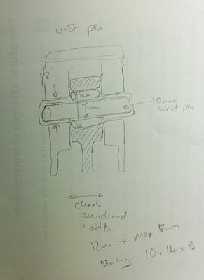

And the wrist pin
"do not scale from drawing"
You can see I was going to use a caged roller an indeed tried this but it was all a bit flimsy so upgraded to longer crowded needles. Clearly the ends of the spacers there don't poke into the cylinder wall, in fact, they ended up quite a bit different so that I could ream the internal bore diameter to size easily but it gives the general idea.

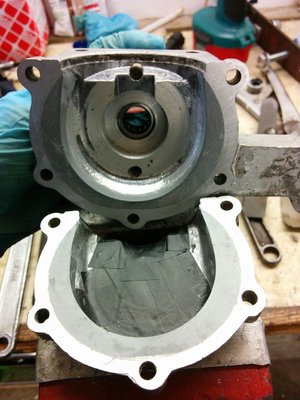

GarethJ wrote:IMG_20170721_174302.jpg
A couple of questions if I may....
What did you (and others) use as 'filler' in the above pic?
There seems to be quite a lot of space filled. I'm aware that the new crank has a slightly shorter stroke than the original (38 vs 40mm) but I cant see that the reduction of throw by 1mm creates such space. Is the crankcase overly roomy for the standard crank or is the new crank with one-piece rod so much more compact than the standard split rod set-up as to create the additional space?
TIA.
Posts: 4971
Re: 97cc Seagull
I use Loctite 615 Hysol but machine within a couple of days, as after a week it gets so hard HSS tooling has a very short life.
