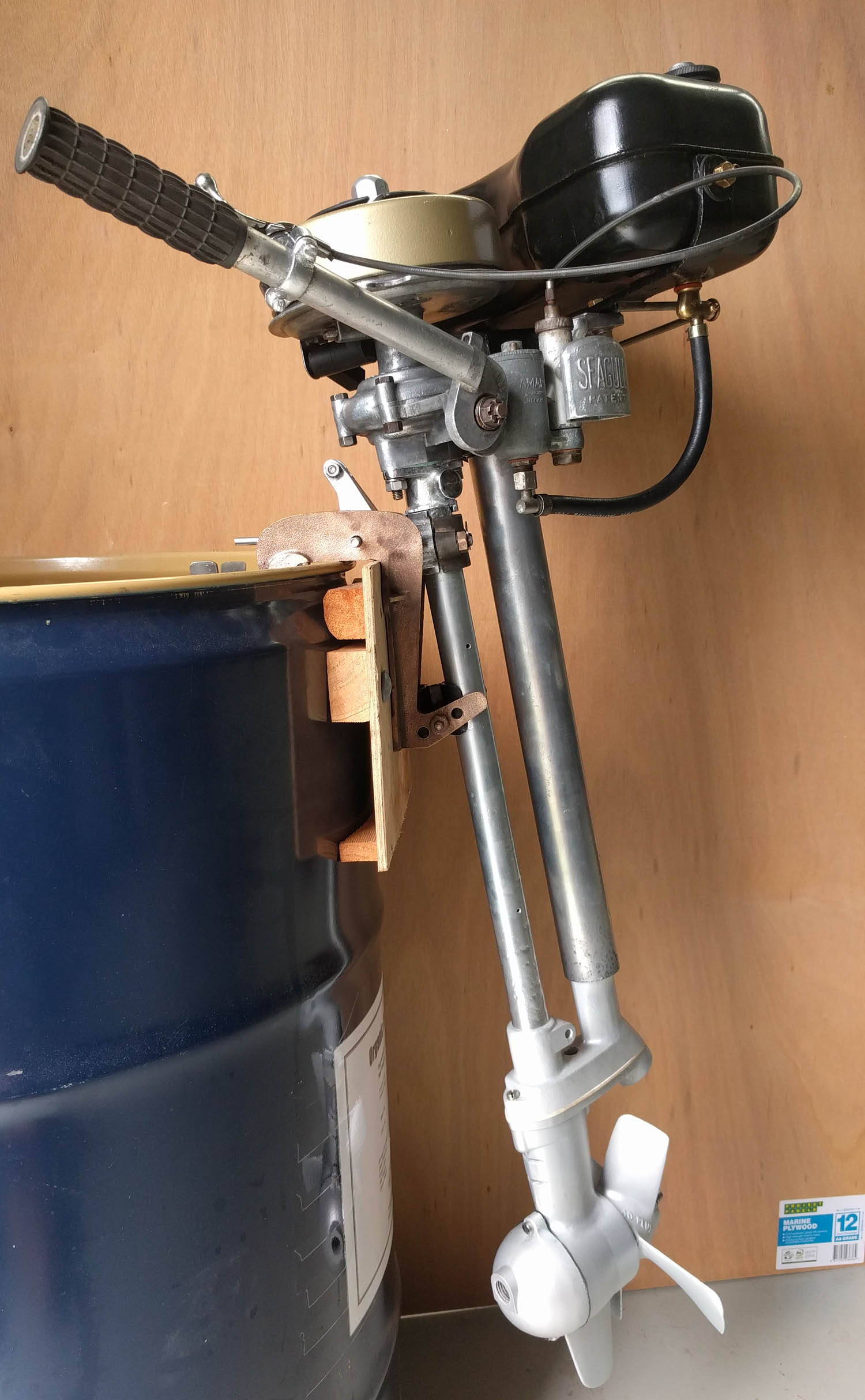

The forty plus is starting to take shape. It started on the second pull (nearly on the first) and ran smoothly. Unfortunately, there was no water coming out of the head. I thought that maybe I hadn't lined up the water delivery pipe but that checked out OK. The impeller is in reasonable condition, a bit scuffed, but still in one piece. I don't think that this is the problem.
When I cleaned up the motor, there didn't appear to be much rust in the places that I could see. Water squirted up the inlet came out the tell tail hole. I was reluctant to remove the head because of the trouble that had with every other fastener on the motor, but it looks like it has to come off. Hopefully, I won't break anything when I try.
Here is a picture of the work so far. It still needs a couple of bits and need to do some work on the carby as it drips around the banjo bolt. I doubt that the carb is original as it has a longer throttle cable than necessary which come have come from a century or 102 model. The motor runs OK with it though. It idles nicely.

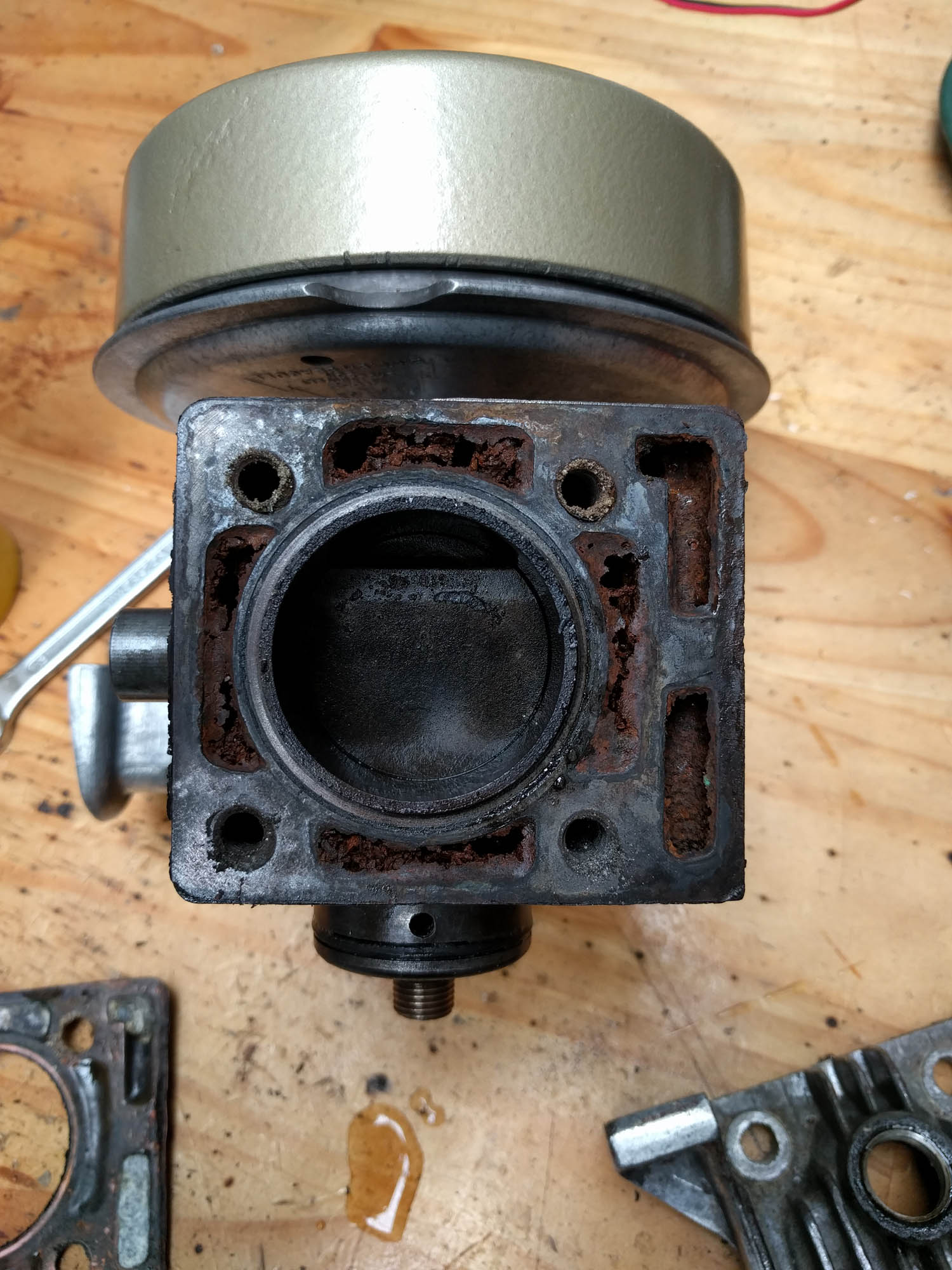

I took the head of the Seagull without damage. It is surprising how much a little heat helps with this. The cooling passages weren't too bad. There was some "mud" in the passages but no major blockages from rust. I scraped out the muck from the water passages and blew what was left out with compressed air. The barrel was in remarkably good condition, nearly as good as the featherweight.
When re-assembling, I noticed that the copper delivery tube was a little loose in the water pump housing. I put a couple of wraps of teflon tape around it to make a snug fit in case this was causing the water pump problem.
The outboard fired up fine, but there was still no water emerging from the head. I've ordered a new water pump rotor from Sheridan marine so will have to await it's arrival from the UK. If that doesn't fix the problem, I'll be asking you guys for help.
