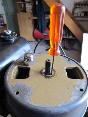

Who has a good and safe way to remove the flywheel, as even with all the British Seagulls that I have restored I have yet to remove a flywheel or open a motor.
So that's a 1/2" carb, what's the original?
- Posts: 395
- Location: Hout Bay
Checking to see if the drive shaft is in place I slid a ponier into the slot in the flywheel.
It goes down 22mm which is 7/8" before it stops, is this correct?
Is th key in place?
Is th key in place?
