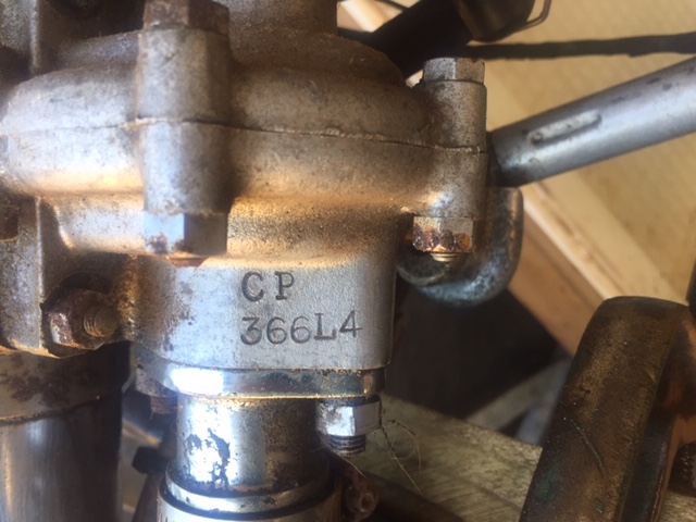

My engine number does not appear. The No is CP366L4 Could anyone help me identify it.
Thanks.

An oddity!
The letter L was not used in the date code sequence..
Is this by some chance a 'longshaft' motor? If it is maybe the 4 after the 'L' has been added by someone and this is a very early CP longshaft.
We have seen some that were used my the military stamped with 'L4' after engine numbers, but these tend to be very early model 102 motors.
It will have, I suspect, a Villiers ignition. Sadly these are failing all the time now, just age... If the motor can be flushed through backwards and it has a clear waterjacket, and if the gearbox is OK, then sorting out a later wipac ignition will give you a reliable 4hp direct drive motor. (Flush out in fresh after use in salt!!).

Hi John,
It is a short shaft and runs like a dream. My problem is the gearbox, I don't know how to remove the pinion drive.

You need a workshop Manual!
Mail me direct, via my mail address on the website.
Looking at the number bet the L4 was added later, any signs of green paint on the drive leg? (Army painted theirs green!).
