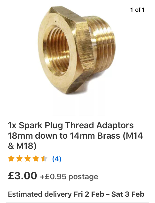

Liam2k3
Posts: 87
Location: Lancashire
Re: Compression Test
Post by Liam2k3 »
Ebay thread adapter. I have one of these.
I was going to make one but for £3 odd it wasnt worth setting up the lathe.
