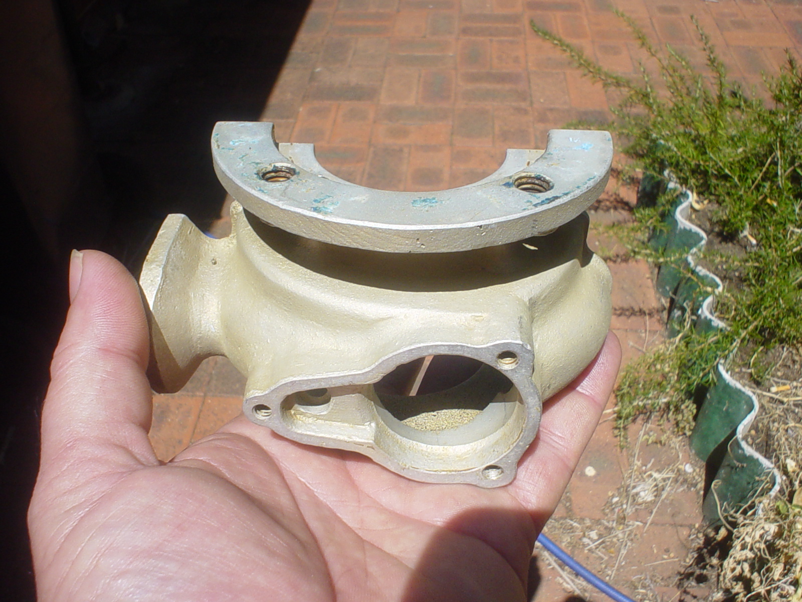

Not reed "Valves" just one is all that is required.
I had this idea a while ago in one of my posts regarding a silver century power head toy..........
An idea from a C-Powa.
You will see in both of these pics how the read block looks and where it fits.
On BS the only place to cut something like this in is top case/under ignition plate/to the side. In other words the reed is horizontal with 90deg to carb.
Obviously one does not need a full standard ignition base.......just the bit on which that points live. Throw the rest away as you will end up using a small remote battery and a modern coil.........really. Chop up a Wipac plate!
The carb size should be kept the same bore as BS.
I have lost my measurement notes/jottings but you might get the idea.
ONE round petal. Because of the size constraints round will seal better than any other shape.
A trendy wedge shape block will defeat the ability of the crankcase suck and blow.
The idea is to NOT INCREASE the crankcase volume.........keep it small and simple. Hmmmm, do some googling for chainsaw or small engine reed asys. I did that but nothing really jumped out at the time.
I will try and find my paper pattern for chopping a top case hole...............
I may revisit as I now have a modeller mate with some outstanding 3D printing hardware.
