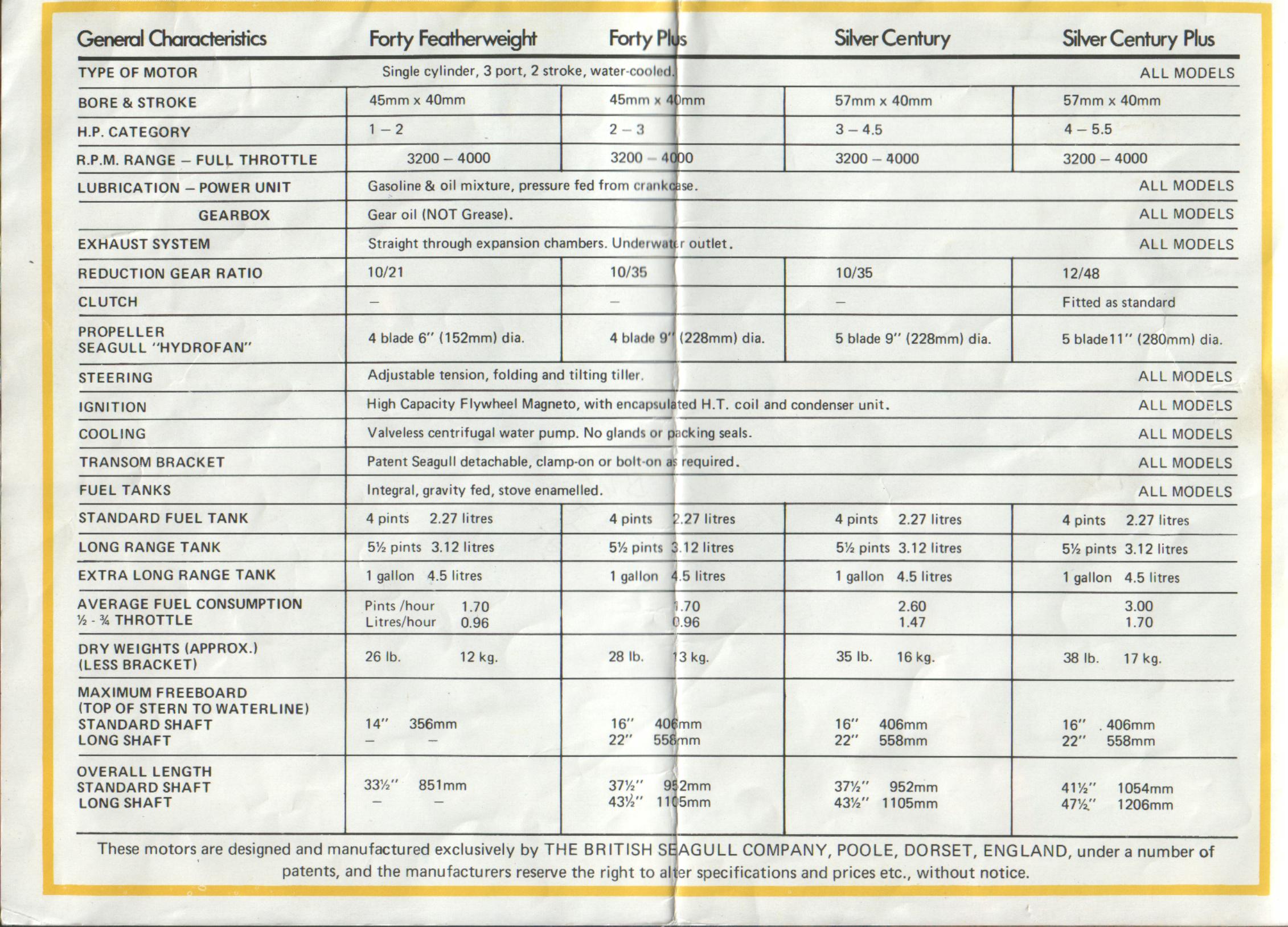

Hi Bill
To be fair, the answers to the questions you have asked are easily found, but the lack of response you have received just goes to show that not all Brits are as friendly as is popularly imagined. The boat you describe would seem to be unsuitable for a featherweight. I seem to remember from somewhere a promotional pic of a featherweight being used with a small inflatable. But 'try it and see' seems to be the best way. Here's a data sheet I copied from the main site just now, which I hope answers some of your questions - good luck.

That General Characteristics comparison sheet is nice but I haven't been able to find the original on the main site. The print in the copy you sent is too small and fuzzy for me to read. Where should I be looking? Thanks!

Hi Bill
On the main site, choose 'Range of British Seagull Models', then select 'Forty/Centuries'. You'll see the sheet I copied immediately, click it to enlarge. Or, right-click the image in the post and choose 'save image as' then open it with Windows picture viewer. I expect this will be the default application anyway.
Also, I forgot to add that the most suitable outboard for you boat is probably a 40+, with a clutch if you can find one, or a Century/Silver Century of you need a bit extra push, standard shaft is best, but a longshaft item would work if you use a collar as Hugz described. If you simply tighten the clamp you won't be able to steer!

I found the spec sheet per your directions. It printed out crystal clear. Thanks!
Here in the States there aren't that many Seagulls for sale especially on the west coast. More so on the east coast especially in the New England states. Must be the "England" in New England! Anyway, I'm attracted by the SG's simplicity and ruggedness. I do have a line on a 40+ w/o clutch which hasn't been run in 21 years according to the seller. From his photos it looks extra clean. He says it has good compression and the fuel tank was drained before putting it in storage. It's a standard shaft. It would be nice if it were a long shaft but I think it would work on my 450 lb 12' SF Bay Pelican sailboat's 20" transom if I were to drop the transom's outboard bracket mounting plate 2-3". That's easily doable. Only problem is it's a full day's drive and an expensive ferry ride to and from his place. His asking price is reasonable but the trip cost would make it a very expensive motor. Comments anyone?
