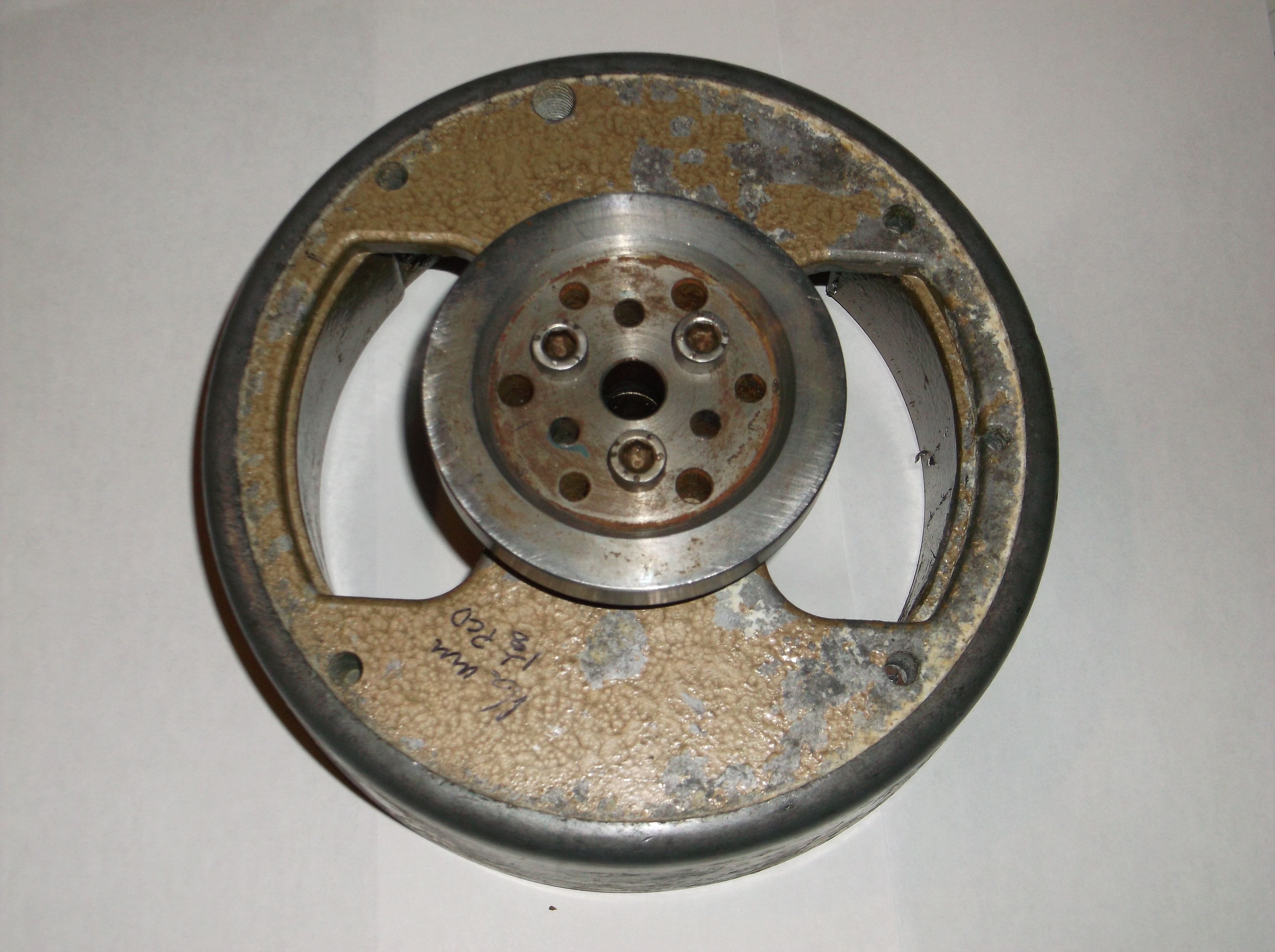

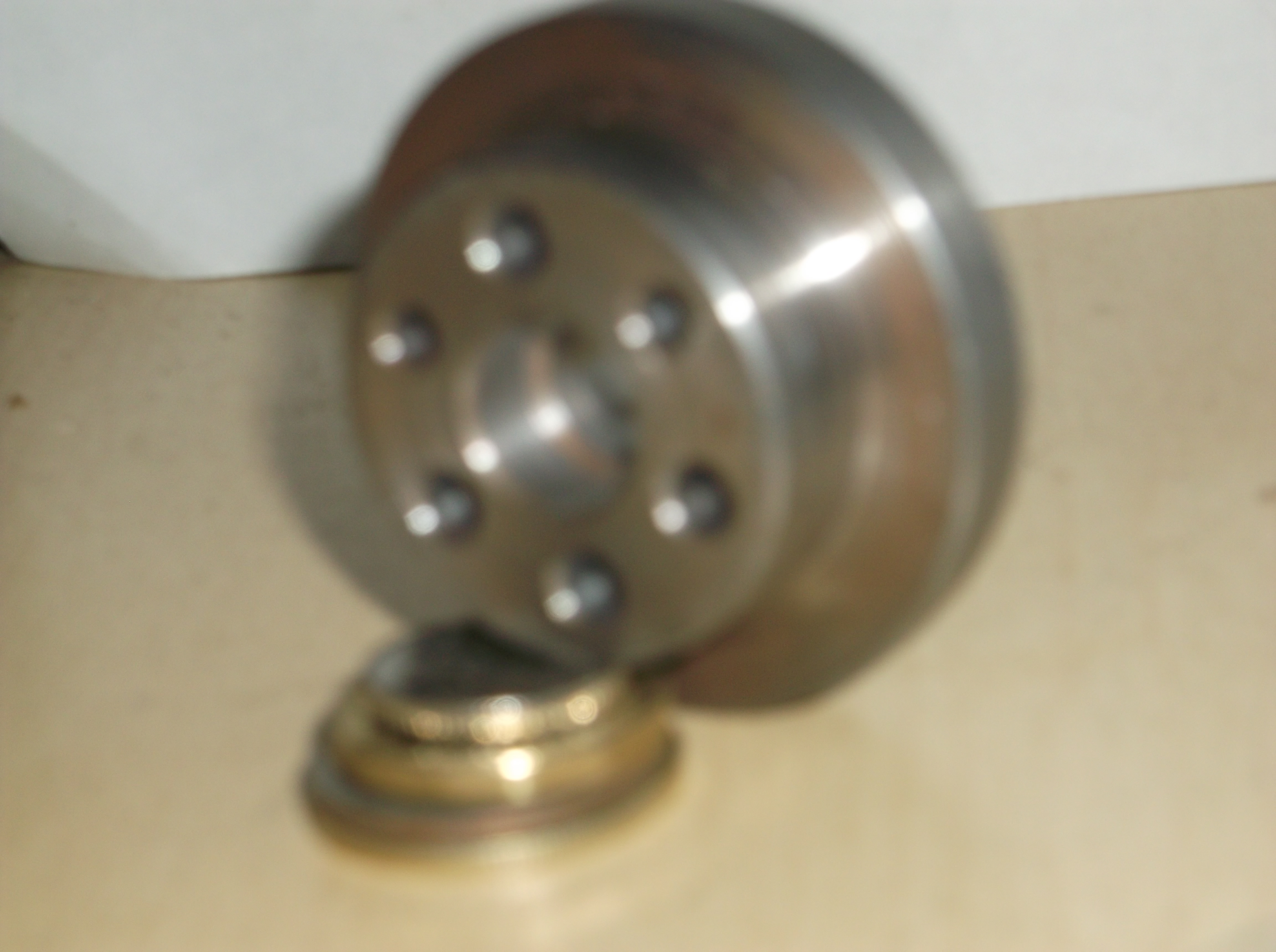

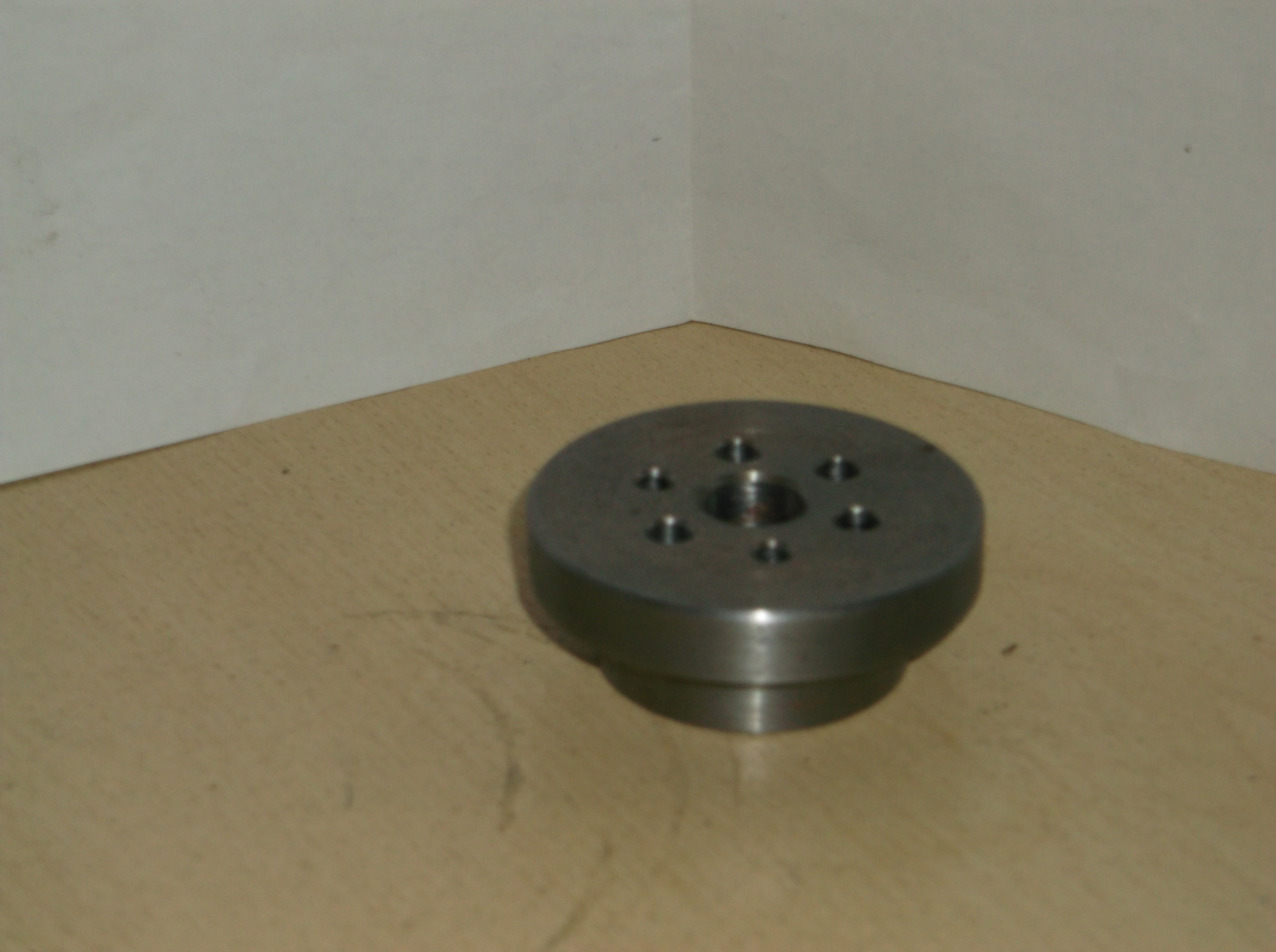

Somewhere I've got a big one, the Villiers/Wipac version, that I had to make after I broke a big window Wipac when the other Charles & I were doing our overview research, I think I kept the broken flywheel.
I'll post pics if I can find it.
Re: stuck flywheel
I've found it!
It was attached to a damaged Wipac big window upside down in the garage, you could only see an upturned flywheel. Narrow diameter ring of holes for Wipac, outer ring for Villiers flat top. Now you can see why they're called "big window".
