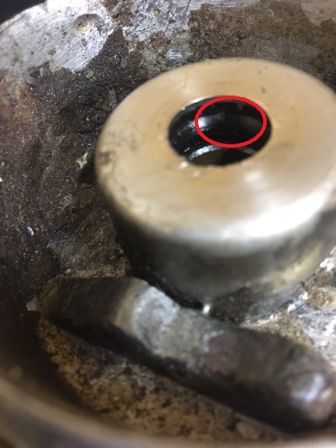

How do i remove the prop shaft seal on my model 75, it leaks loads!
Jacob
Re: Gearbox seal
Working from inside the gearbox i use an old screwdriver that you don't mind giving a whack with a hammer.
Heat it a bit first before you give it what for and it should come off without too much bother. Old skool. 8)
