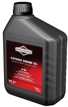

Thanks Charles.
British Seagull Outboard Motors
Manufacturers oil mix recommendations
Year of manufacture 1931-1978 (8:1 and 10:1 petrol:oil mix)
30 weight motor oil, SAE 30 modern equivalent.
sae 30.jpg (14.34 KiB) Viewed 2521 times
Year of manufacture 1978 and after (25:1 petrol:oil mix)
TCW3 2 cycle Marine oil
Re: Upset century
It's more complicated than that Pat as you've not included the non synthetic TCW2 & 3, 2-stroke oils of which the water cooled versions are good for the 10:1 Seagulls & all the later ones!
These are very low stress outboards hence their longevity, a little TLC as they get towards pension age wouldn't hurt.
I like oil it's a lot cheaper & easier to buy than pistons & cylinders!
