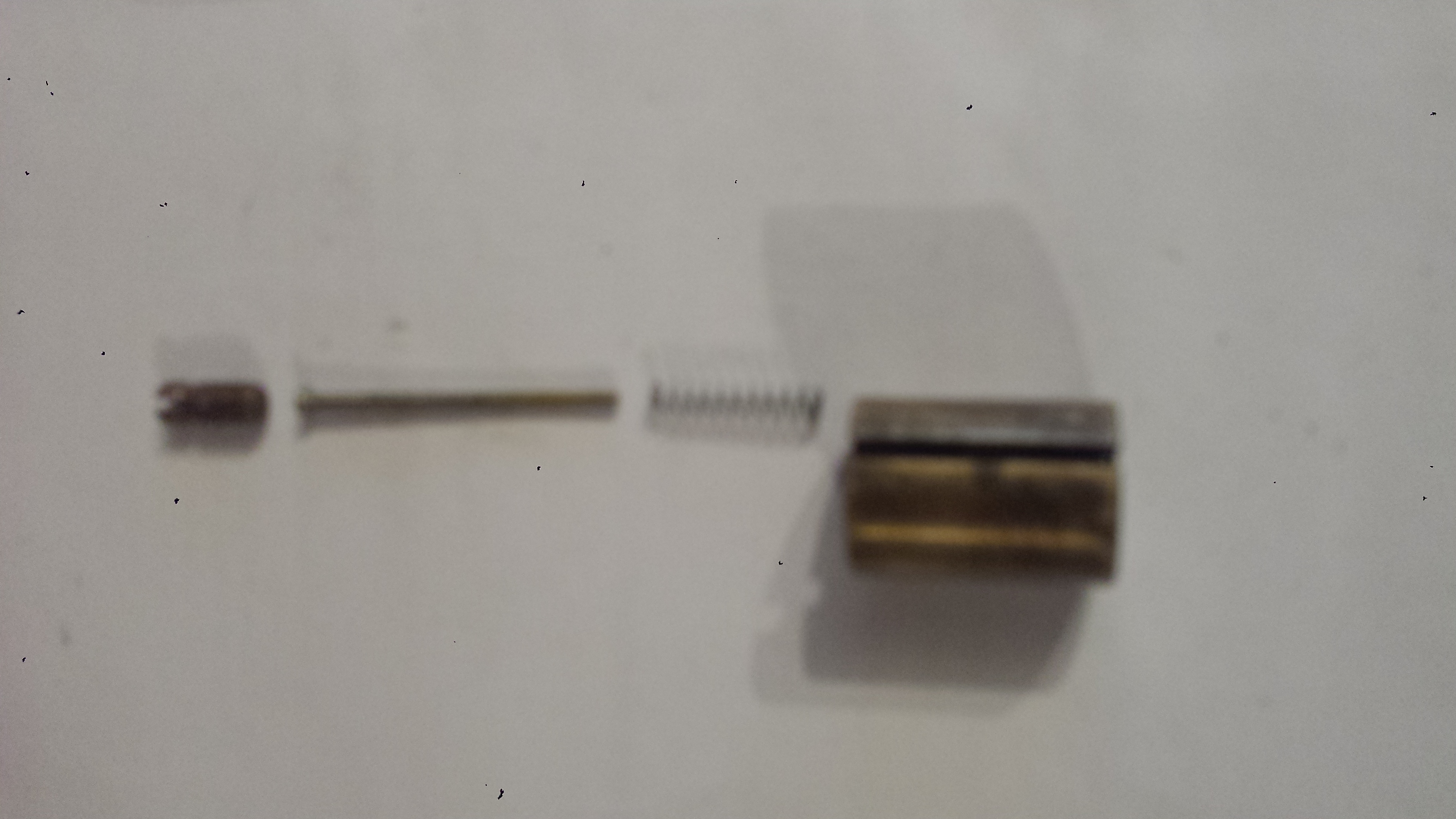

Few days ago I installed a #9 Taper Needle Spring - I didn't have that in my Villiers carburetor - and turned to small screw on the top of Throttle Valve piston to level it with the top of the piston - was one turn below it. So now seems that needle spring is working against #6 Throttle Valve Piston Spring and RPM stays pretty much the same - no idle speed. I am thinking to take the #9 spring out and see how will run......?

By the looks of things your carb has been put back together in the wrong order.
I had a hunch your ignition was probably ok.
(i have a FPC exactly like yours from the same time period
There shouldn't be a spring sitting below the throttle piston, that's why the engine won't idle. Take another look at your diagrams again, it might become more obvious once everything is apart again. wink
Re: EFPCL 1979
Yes the spring is there close the throttle, not open it. So it should sit above the throttle slide. That's actually quite dangerous!

yes, it is put together in wrong order - wander what the right order is.
I am staring in the diagram and can't see where the taper needle spring should be going - not where it now - that' for sure. There is already one spring pushing the slide down - that's #6 Throttle Valve Piston Spring that goes over the cable.
Ooooo, OK #9 should go inside Throttle Valve Piston....above the needle...?? and the small screw over the spring....?
From the parts picture looks like should be going under the piston....
Have to take it apart and take a look again..

Re: EFPCL 1979
Hope this helps china....2dogsnight wrote:yes, it is put together in wrong order - wander what the right order is.
From the parts picture looks like should be going under the piston....![]()
After testing the spark, I also feel that the ignition is fine !![]()
Thank you guys !
Wojo
Re: EFPCL 1979
Good pictures there tambikeboy, shows the order of things well.

Tambikeboy - excellent illustration - just what I needed!
Pat777 - fabulous video - found out that I did have spring inside already and the needle in #2 - so oil ratio is 25:1
Wouldn't mind to get needle #1.....less oil in the gas - right now lots of it is running down the exhaust tube. I did assemble carburation back together and motor started at first pull - I am taking it down to the boat - will post video soon
