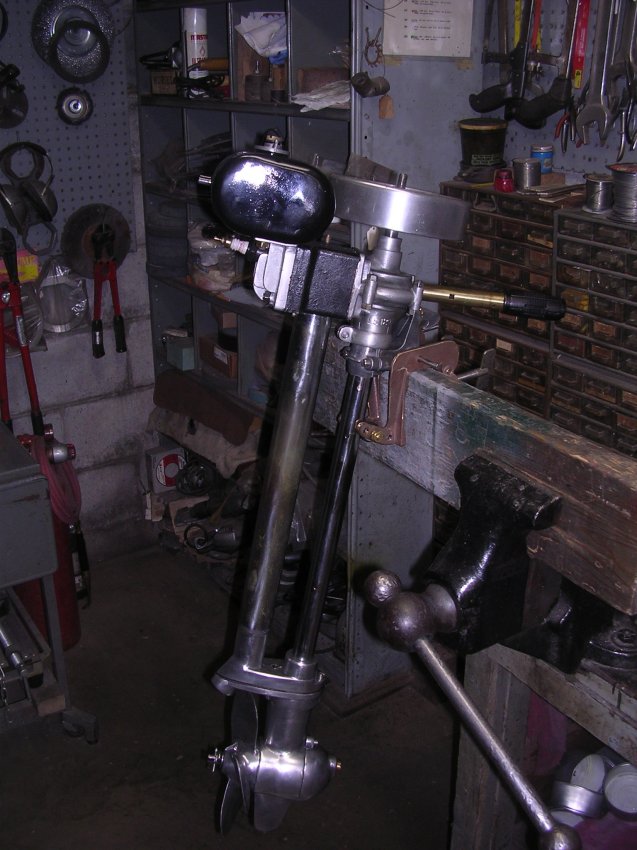

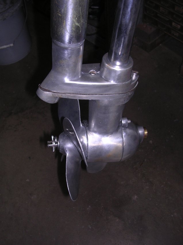

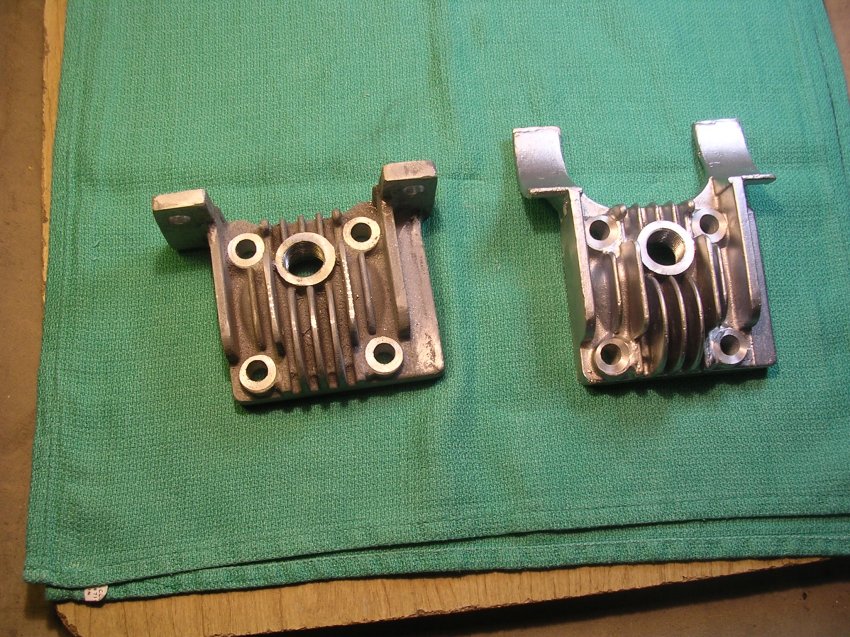

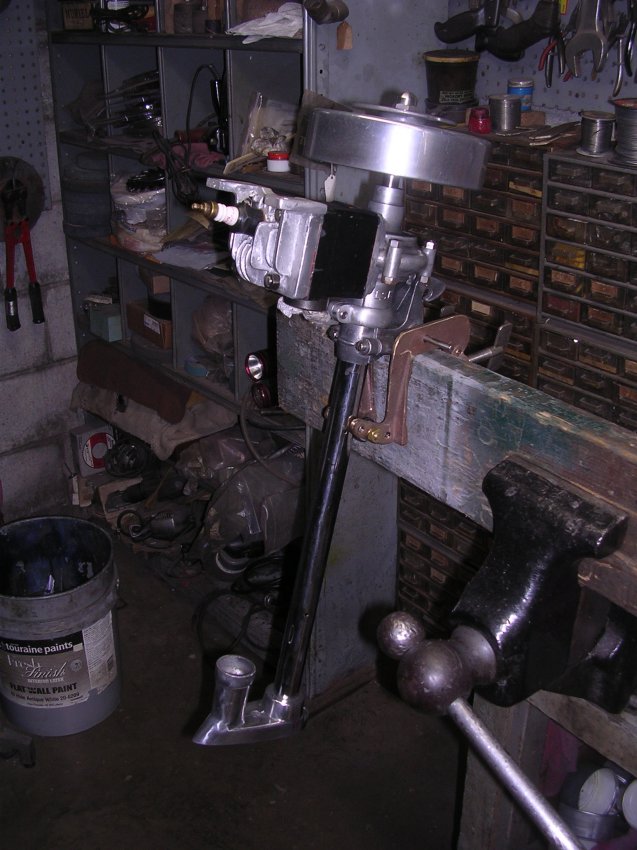

Here are progress pictures  of the LS.  Have the  cylinder head  machined, and   now the power head assembled.  Will be working on assembling the water tube, the drive shaft and  transmission tube, and then the gear box.  Power head has new copper gaskets top and bottom of the cylinder casting.  Also has new Stainless steel  cylinder studs and nuts , both of which are  Locktite in the  crank case flange.  WB

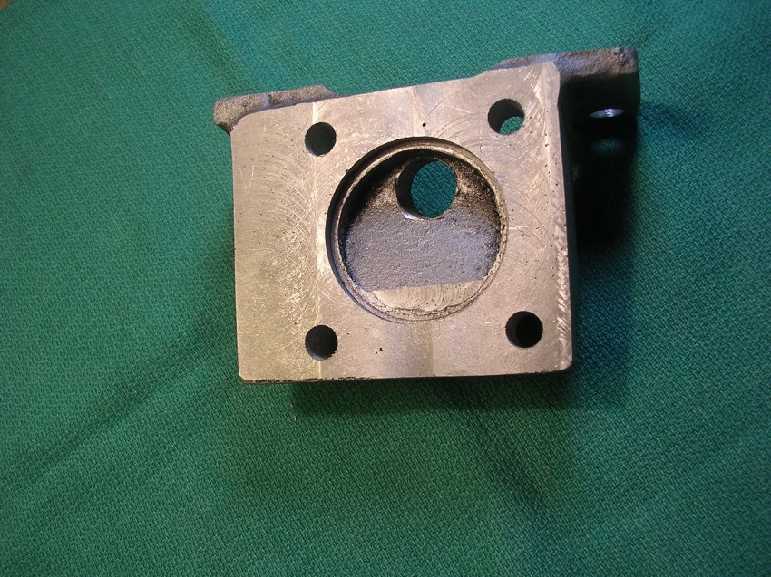

It maybe it's just me, but the water pump casting looks odd, where the drive tube goes into the casting, it looks to have a flat top and looks wider, machined down or something or is it just me.

Yes indeed that water pump housing is a later one , modified to be as close as I could make it to the needed LS  part.  Not having or finding an original part  with screwed in transmission tube , I did the best I could to make one that  is as correct for the LS  as possible.   That is the case for  a number of the  "bits"  on this  resurrection.   Parts I had cast and machined include the transom clamp assembly,  the prop,  the cylinder head,  the crank case clamp ring.
I am trying very hard to make this project motor as close as I can to an original LS. The transom clamp assembly still needs to be plated, and there is much work still to be done on the fuel system and the Magneto.

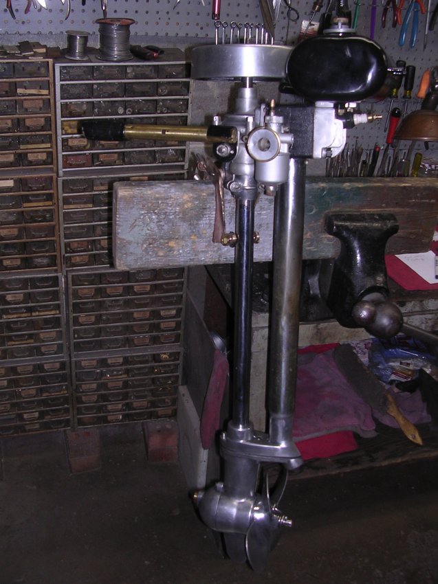

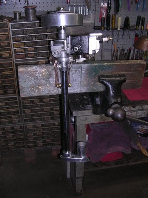

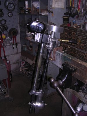

Kieth, Yes , a LOT of work.  LS are not  to be had in the USA.  I like  to do restorations, and wanted a relatively early LS.   So I have been working on it  for some years , on and off.   Just now,  making progress.  Have more of the assembly done. see Pictures.   On to carb , fuel line and Magneto work.  WB
