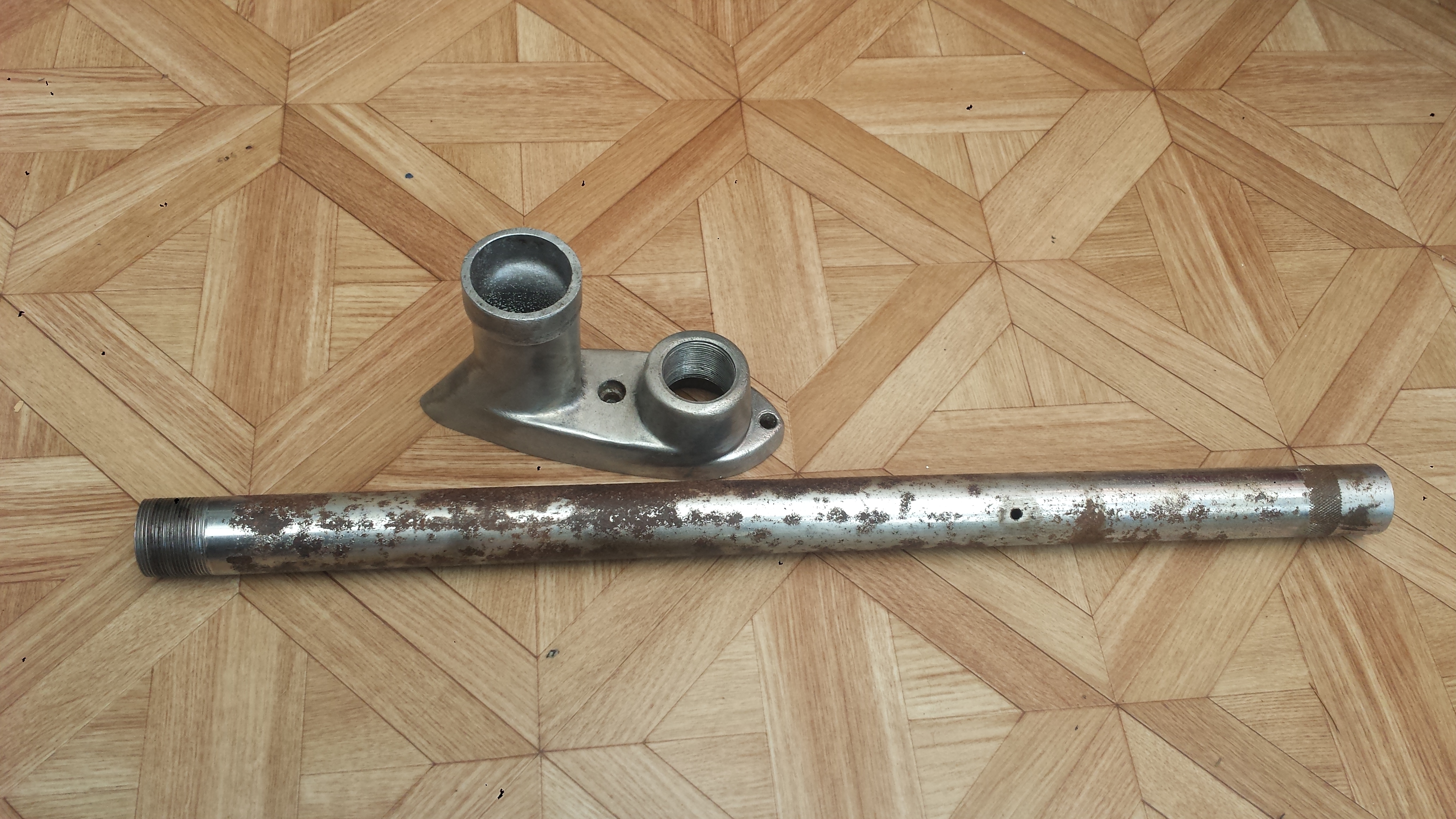

Re: Dismantling my FV
If you enlarge this pics you'll see what I'm talking about
Thanks, very helpful photo. I can see that's going to give me some entertainment! How agreeably does that knurled section tend to slip out of the the crankcase? I'm thinking heat and rubber gloves for grip.
Top knurled part is normally not that hard i usually just chap gearbox end with a rubber hammer as for the pump housing I'd clamp drive shaft tube in a vice and use a piece of wood between the exhust tube end and drive shaft end apply some heat and turn....hope this makes sense. ..
Didn't you say your chrome was good?
The thread is often of one the most difficult jobs a lot of pump housings get broken, aluminium oxide seems to work better than Locktite, hence broken head bolts on Centurys, often caused by head bolts locked by oxide where they pass through head bolt holes.
That's a spare i had lying about for tutorial purpose,s ha/ha
