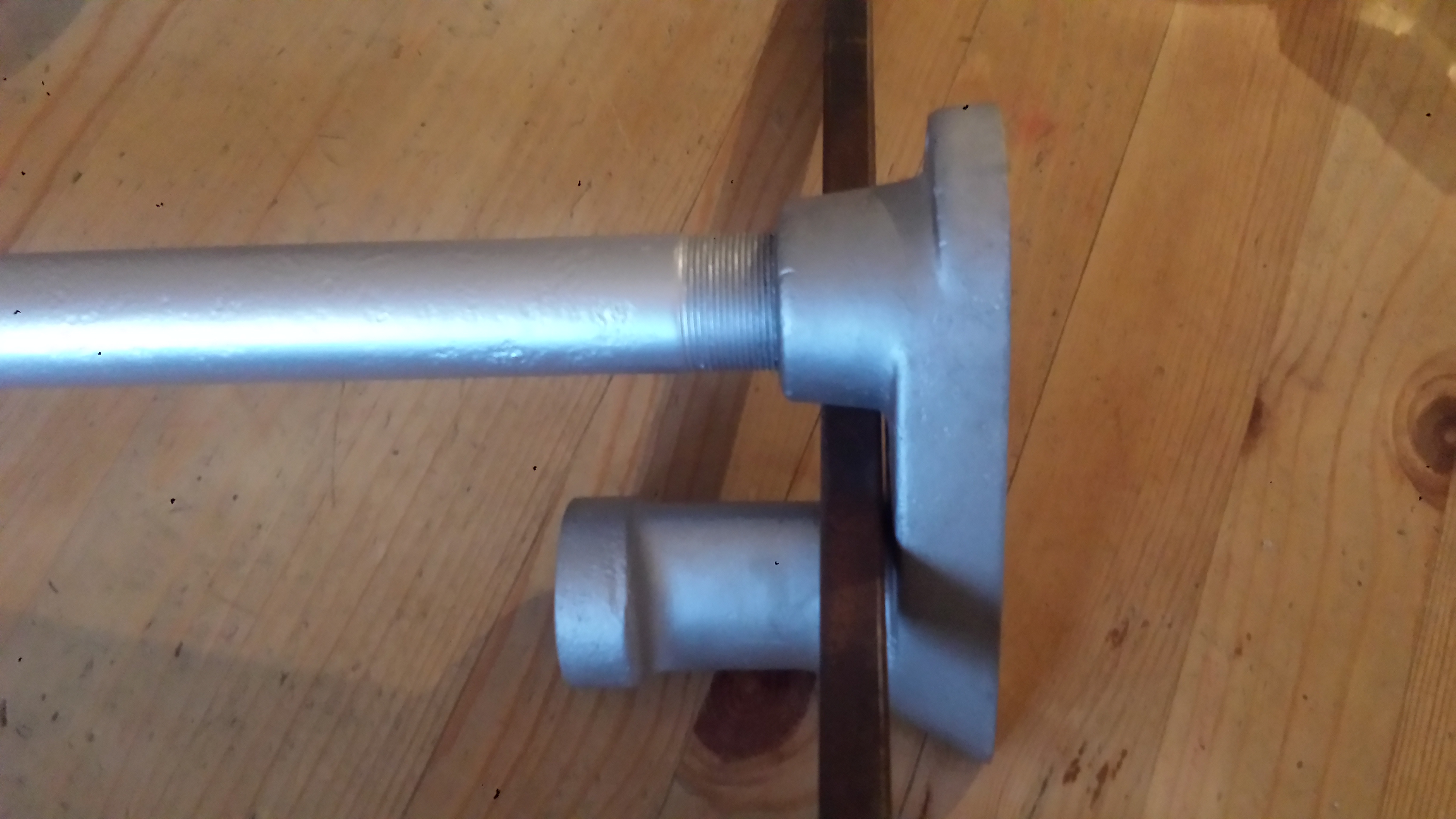

If you enlarge this pics you'll see what I'm talking about :lol:

Thanks, very helpful photo. I can see that's going to give me some entertainment! How agreeably does that knurled section tend to slip out of the the crankcase? I'm thinking heat and rubber gloves for grip.

Top knurled part is normally not that hard i usually just chap gearbox end with a rubber hammer as for the pump housing I'd clamp drive shaft tube in a vice and use a piece of wood between the exhust tube end and drive shaft end apply some heat and turn....hope this makes sense. ..
Re: Dismantling my FV
Didn't you say your chrome was good?
The thread is often of one the most difficult jobs a lot of pump housings get broken, aluminium oxide seems to work better than Locktite, hence broken head bolts on Centurys, often caused by head bolts locked by oxide where they pass through head bolt holes.
That's a spare i had lying about for tutorial purpose,s ha/ha :lol: :lol:

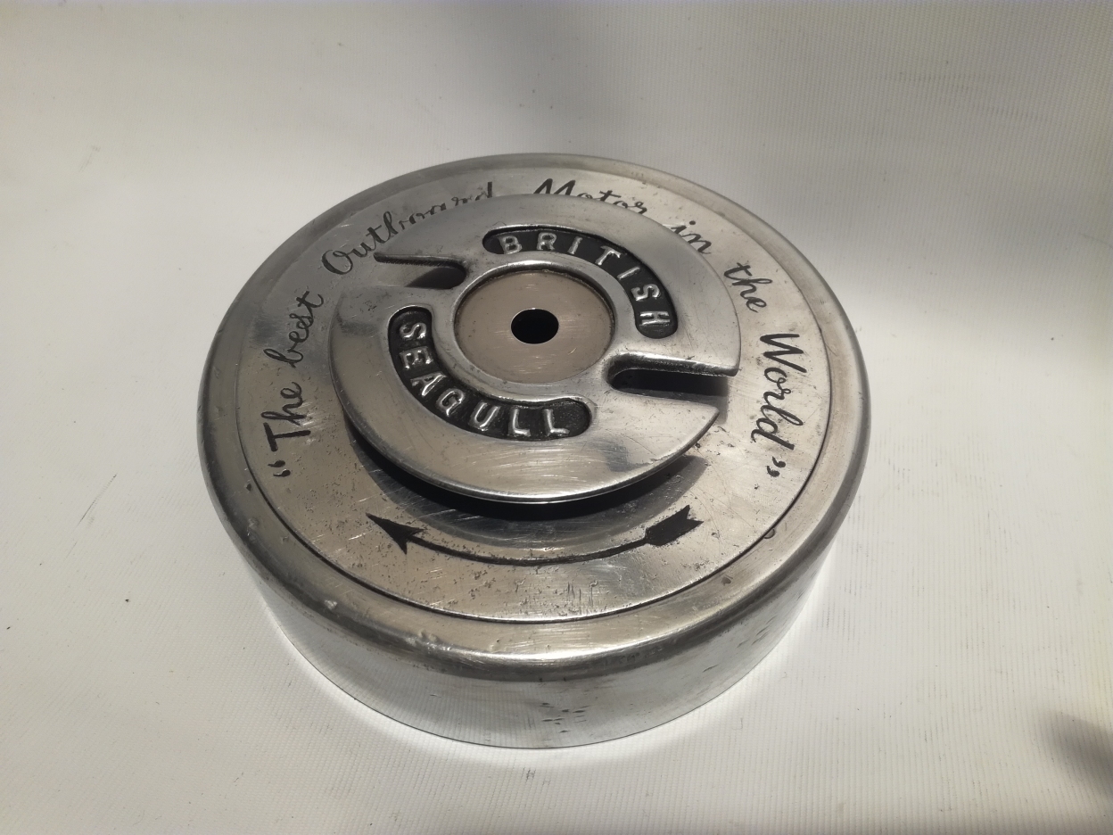

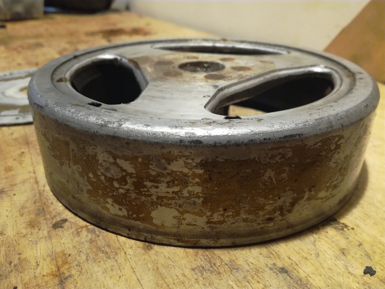

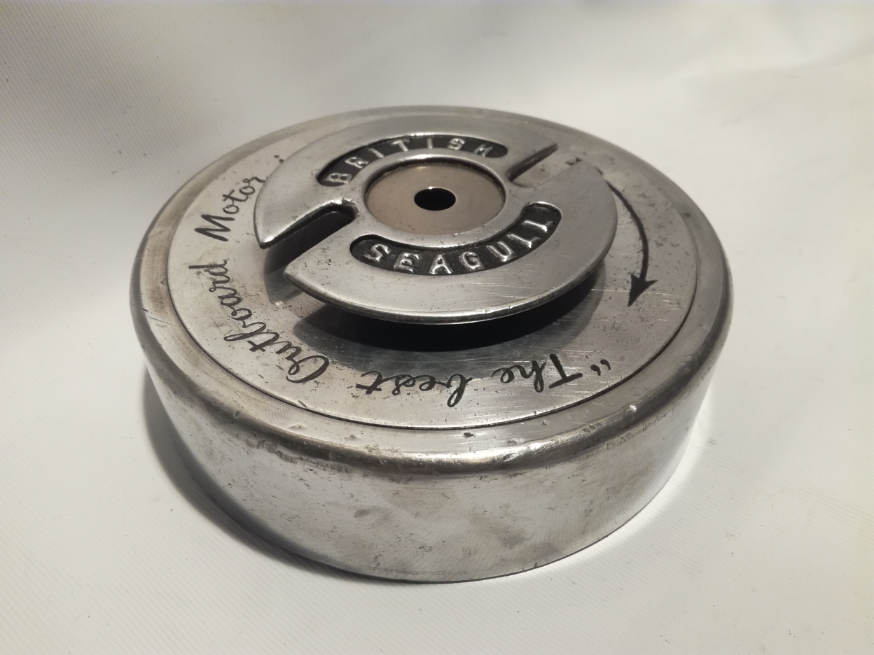

After thinking about it.. In case things are far from straight forward, I'm not going to strip it right down until after the season, as I want to use it on my tender. I am just going to clean it up to look smart for now. I've started with the flywheel.. it popped off easily with a suitable hammer, it's so light I just held the flywheel through the holes in one hand, and knocked the nut with the other :)
My idea of polishing is not to remove all the age, I like the imperfection of old things.. shows a bit of history, makes me think about where it's been and what it's done. I also repainted the lettering in black paint.. that took patience! Here is the result:

and...
