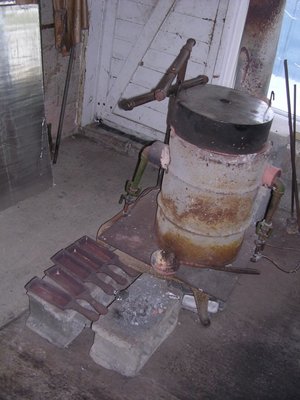

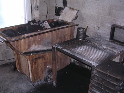

Nudge, Here is a picture of my FVP three blade clover leaf prop. It is original Seagull, not re cast. As to hard and soft castings, I do not get technical with my metal sources. I use old outboard motor bits and pieces, so I get a mixture. Best Scrap Ali for casting I find is old pistons, Outboard or Automotive. With general scrap mixtures , I too sometimes get castings that are not soft. Mostly softer alloys are not cast but wrought. There are complex annealing cycles that castings can also be put through that will soften them, but in my case , since I do not really know what is in them, it is not possible to choose a specific heat treatment. I use an atmospheric - propane furnace I built to do the melting, in a cast iron pot that has a ceramic wash on the surface to minimize iron atoms from getting in the Ali. also attached is a picture of my moulding bench. This is in my permanent 15" X 30" foundry attached to my garage. WB

Its an interesting little foundry you have there Art. With those winter temps a good way to keep warm too!

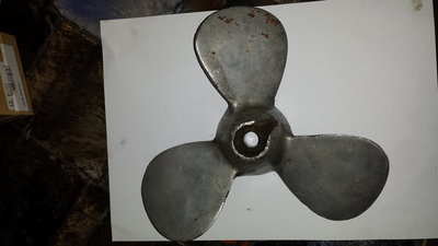

Here's one. Shame to dissemble the aussie bushcraft fencing wire shear spring replacement. It's a boomerang if it helps you....
That helps me heaps...... I will give you a shout when I see you on line. 8)
Gotta love that bit of engineering :shock: I guess if you are up a creek and hit a log,and that is all that is around to get you home.
That will have to go back as is once done! :mrgreen:
Re: An FVP in USA
Interestingly it wasn't fencing wire but copper which would have sheared before the gears would have kaputted!
