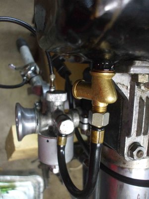

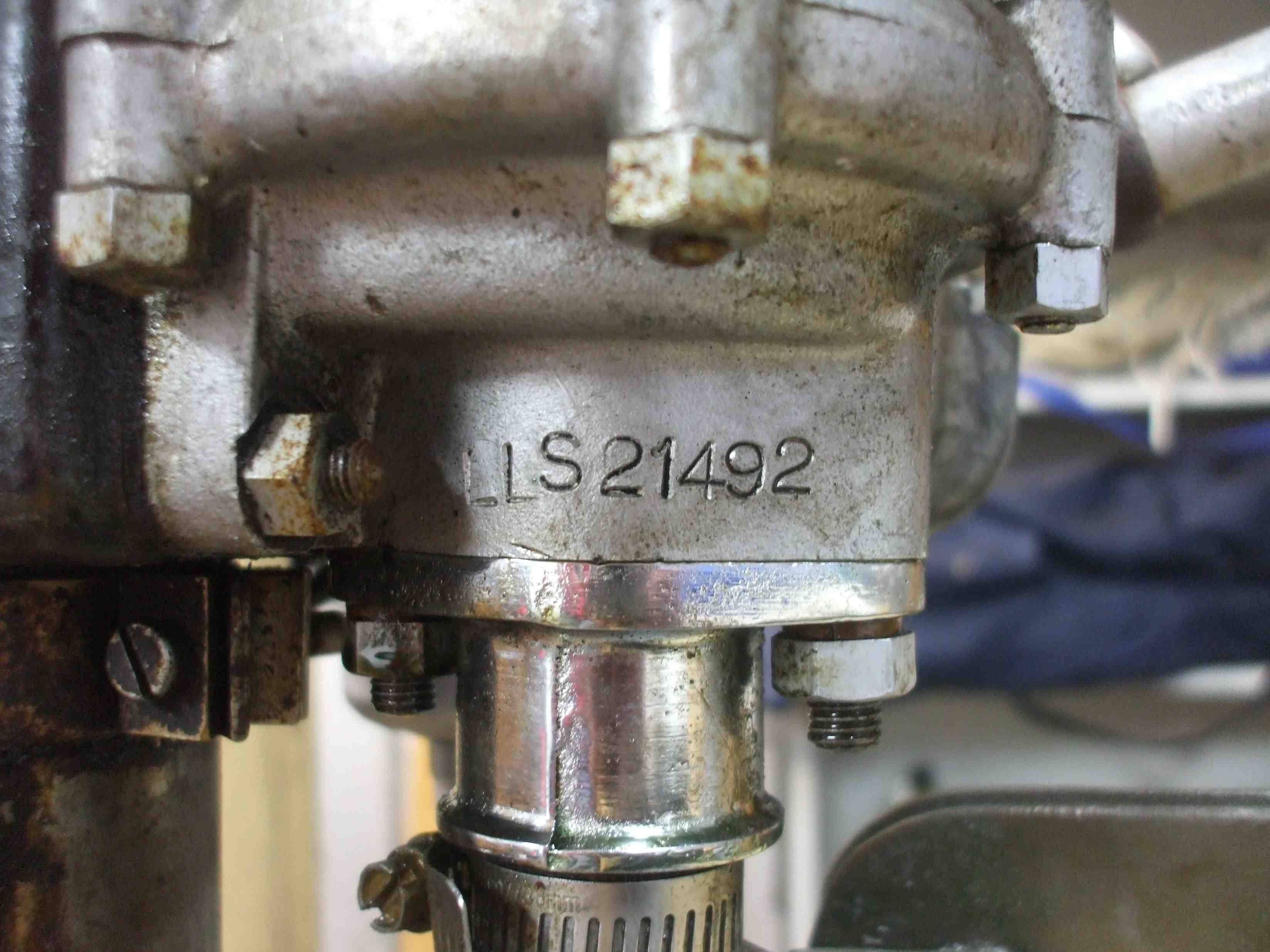

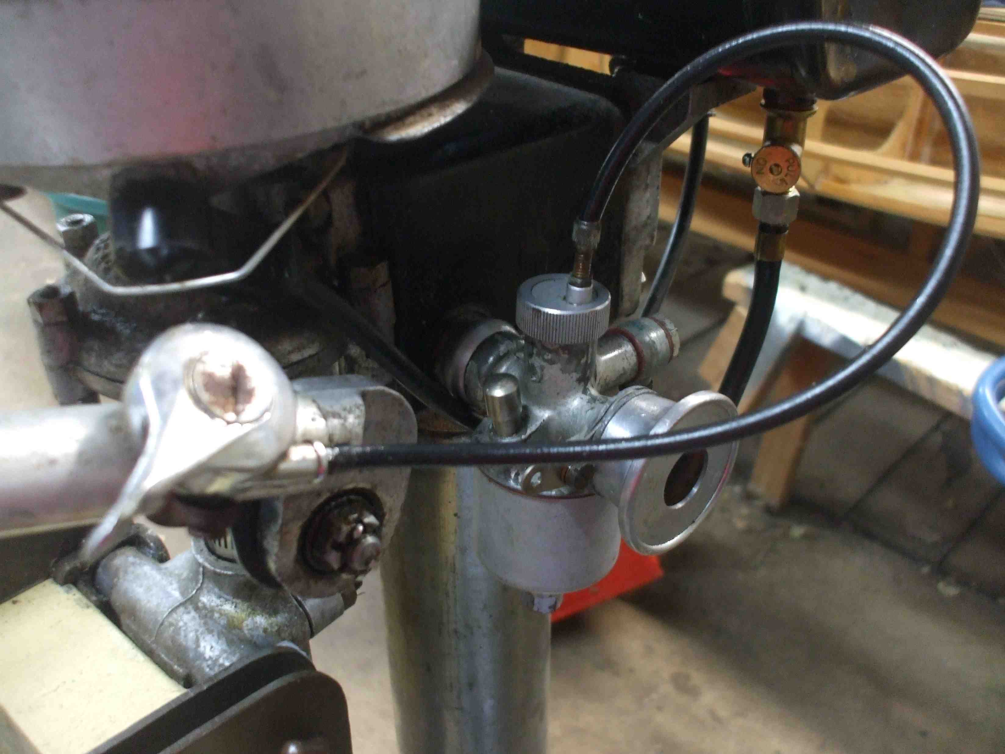

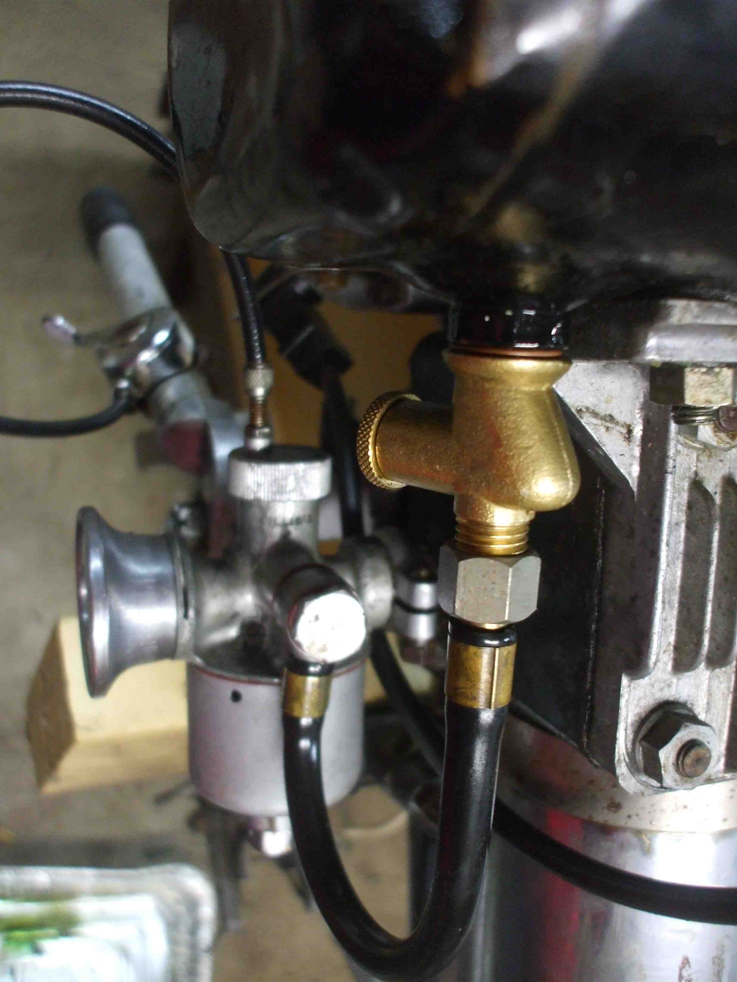

Hi BP,
pictures enclosed. I will get a more general one later.
The throttle works fine, up and down, just stopping!
cheers Roger
cheers Roger

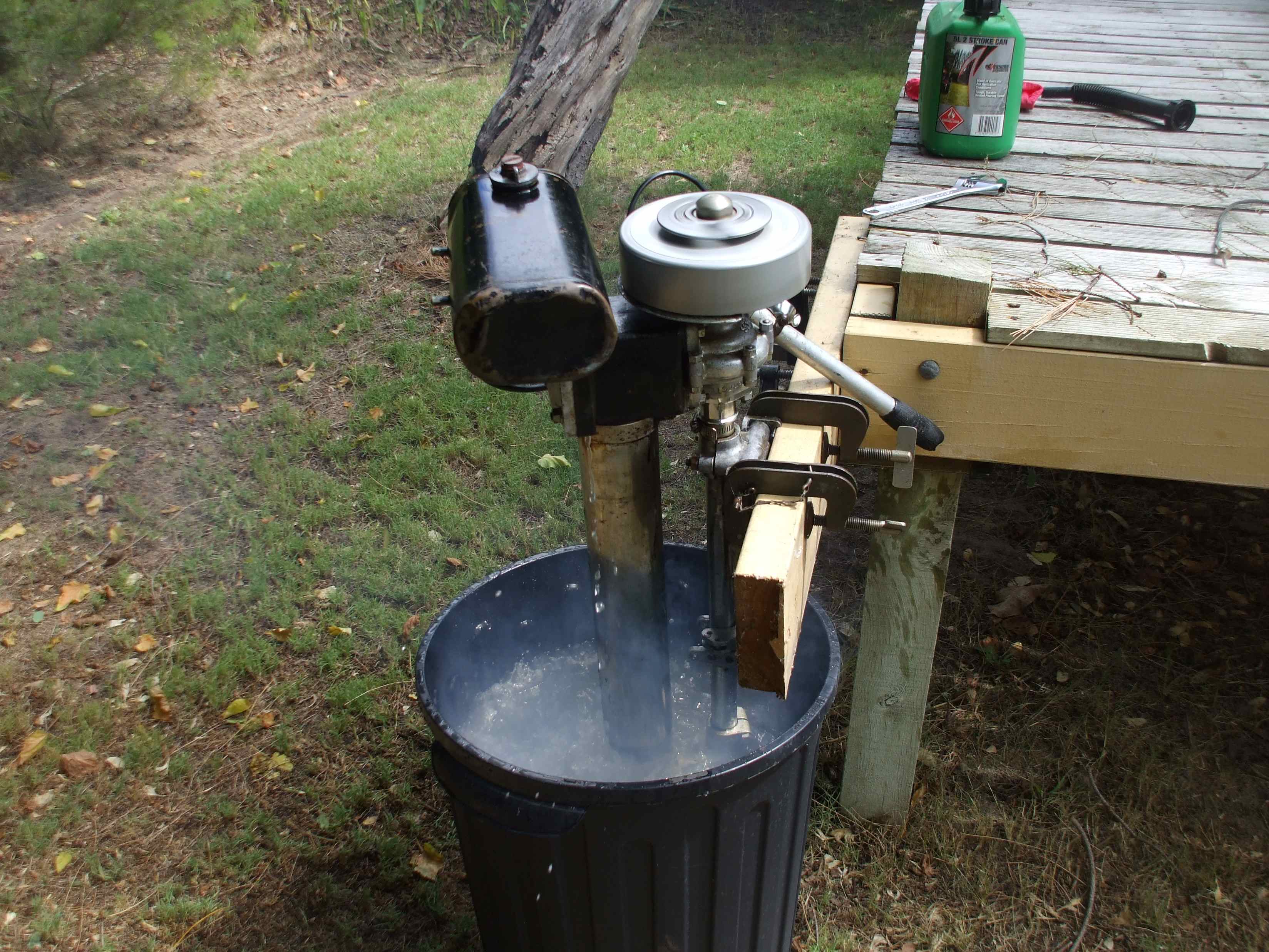

Re: In The Tank
Here she is running, yesterday.
